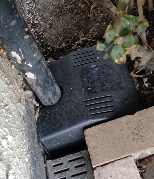

Have you shown photos of the gullies your rainwater downpipes run into?
The trough is not a drain, but it might run into one.
The downpipe that leads to the drain is totally clear and is now covered. There was no issues though with that overflowing
I haven't seen the actual drain in your photos.
Houses of that age have gullies and drains made of brown glazed clay (like a teapot).
IME they are always cracked or broken and leaking in the ground, but I have heard that some aren't.
Would you like to show us yours? Scrape away the earth round it, or show us the surrounding concrete.

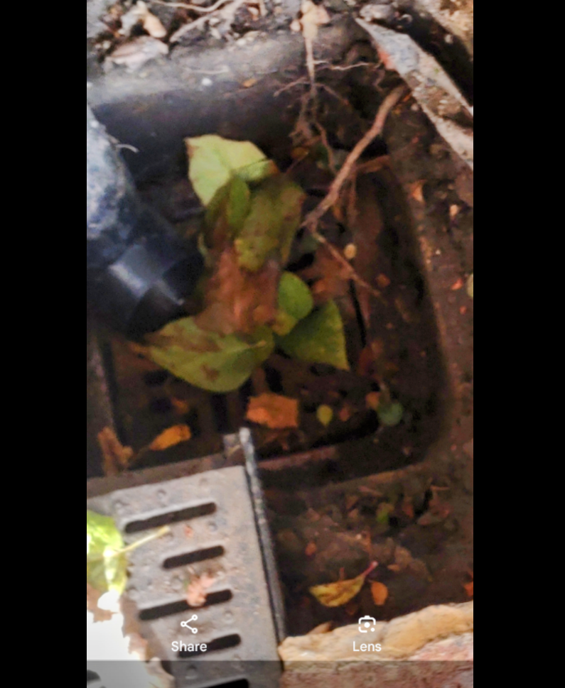

This is what the surround looks like without the cover. Taken a few months ago with mostly cleared of leaves etc
How far is the grille below current ground level?
If you pull the metal grille out, is the gulley itself brown glazed pottery? Is it full of mud and grit? Can you see a crack?
You need to look at that drain while it's been raining heavily. They often get blocked and the water ends up going out of a crack into the surrounding soil, waterlogging it.
But this alone wouldn't cause a damp wall, but the fact that your DPC is bridged by render would allow it up into the wall.
Also check whether the cavity is full of rubbish.
