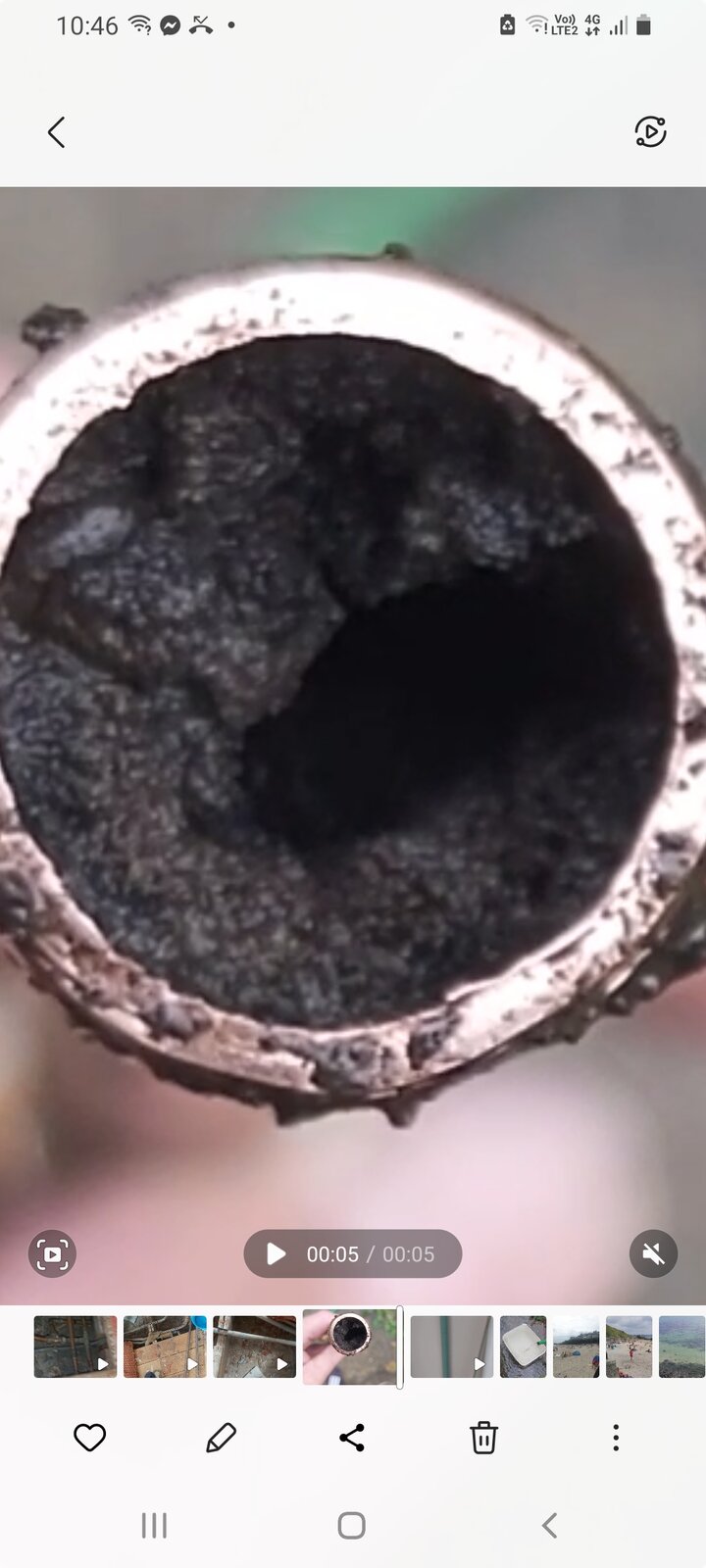

OK update time. Have floor boards up on first floor have I.D. the flow and return which are both 22mm and these have magnetic attraction :( these pipes convert to 15mm covering the front of the property and back of the property so far from ideal piping as these 15mm pipes also go downstairs. On these main 15mm pipe runs there is also magnetic attraction maybe slightly more on the return pipes. The offending radiator return has no magnetic attraction for the first 3M after the radiator valves and then slight at a set bend which then travels 3M and joins to the cold feed with magnetic attraction. Thoughts are due to poor design that the reduction to 15mm and serving of multiple radiators that overtime sludge and crud has developed. If I was to cut at the cold feed point which also happens to be where the return of the non working radiator maybe can get it working again. How good is a powerflush under these circumstances. Thinking of hiring one. Snippet of extra info the circulator has also siezed up bit managed to kick start it with a screwdriver in the bleed hole. Could I also have weak circulator which maybe contributed.
Found the issue. Blocked just after the Tee at the cold feed which also was where the return of the bad radiator joined. Going to take the opportunity to repipe in 22mm the main runs whilst I have the floor up. This will then have instead of 4 radiators on 15mm pipe work it will be max of 2.
