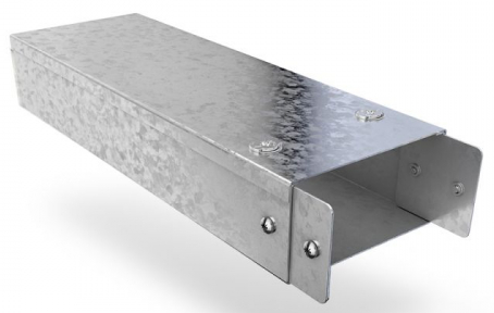

I have a 2.5mm T&E traveling to the Consumer Unit and needs to be extended. I plan to use Wago connectors for this and it will be accessible. I am planning to include this cable (along with a few others), in this trunking:
Can I include the connectors inside this trunking or does it need to have its own box? I can't see how the box would but up against the trunking...
Also, is it advisable to use penny washers when screwing this trunking to the wall?
Thanks in advance.
50x50 trunking can hold a lot of cables = substantial weight. Yes, penny washers.
Don’t like junctions inside trunking, it takes up space and later cable runs can cause issues. If you must use Wagos then consider that the conductors could be pulled out of the connectors. Assuming there is only mains cables in the trunking, you must support the cables to provide strain relief.
How would you handle it?

I don't believe that WAGO agree with doing what you propose? They CAN be used in trunking that requires tools to open but AFAIK not in clip together trunking? Plus how does someone know that an extension has been made? How can they expect to inspect when it's location is hidden? Why not a box on the wall?

Happy to put a box on the wall and situate wagos inside this but was wondering how this connects with the trunking I specified above? Was looking for a neat way to combine these.

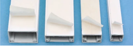

One does not use trunking where the wires will never be touched, the whole idea of trunking is to allow wires to be altered. I love the idea of trunking this 1654514684884.pngallows one to easy change positions of sockets without damaging the wall, and this 1654514864313.png allows one to hide cables, and this 1654514993766.pngallows the use of singles, they are all trunking, but used in different ways, the requirement for use of clips 1654515156183.pnginside the trunking has made the use of plastic trunking less popular, I would use stick on trunking and then smear some stopper on the edges to blend it in, also the stopper would hold it there even if the sticky back lost its stickiness. But the fire regulations stopped that, and it is uncertain if we can even use plastic raw plugs.
