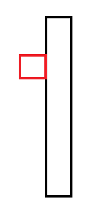

Would this approach satisfy those concerns:
The black rectangle represents the vertical trunking containing all mains cables and we then have a wiska box (in red) neatly butted against this where we can have the wago joints for the cable that needs to be extended.

The reason that WAGO (and similar) connectors were invented was to solve the issue of how to reliably join solid conductor (and other) cables.
My concern would be any possible damage that could happen should a Wago junction be left just floating in your length of trunking.
There are many solutions to this. Something as simple as this, perhaps
but think about mechanical strain issues.

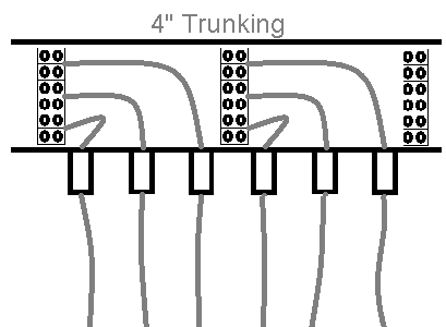

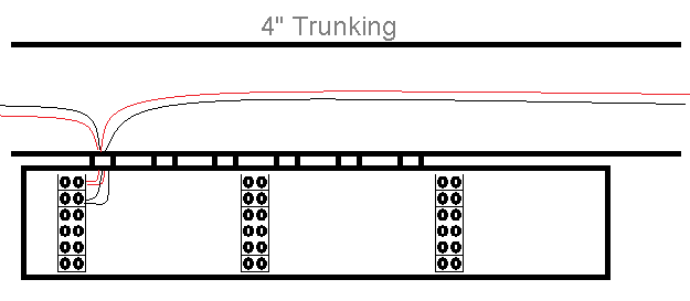

Following an electrical inspection and numerous detected faults we replaced stage lighting dimmers in a school, originally 4x 6 channel units and 36x circuits terminating on flying leads via choc bloc within the trunking and white metal cable clamps/glands:
One of the 'faults' being unacceptable 'joints within the trunking'.
The school made the decision to do a significant ungrade:
We added 12 more circuits & replaced existing dimmers with 2x 24 channel units which involved major surgery to the 4" metal trunking.
The plan was to do away with the flying leads (had been a constant source of faults). 24 of the circuits reached into one new dimmer pack but the other 12 needed extending. I formed a junction box from a piece of the removed trunking and attatched it the using the existing 3/4" holes with 12 brass bushes & 24 lock rings:
After the works were completed it had to be inspected by the original electricians and they snagged the 'joints within the trunking'. My solution was to add a Dymo label, something like 'Junction Box'.
