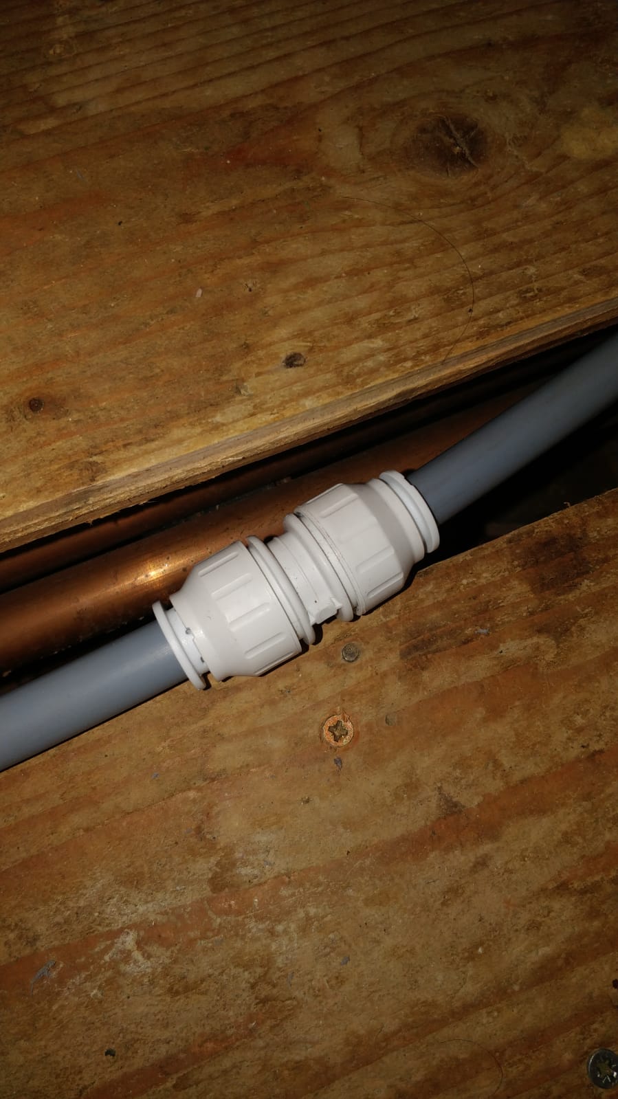

So the insurance "emergency repair" consisted of a kid coming over and fixing the pipe..
Well done..
But, he didn't realise that the connector was so thick that the floorboard no longer fitted flat
And then he buggered off..!
Not so well done!
But hey even after complaining the result was.. "you no longer have a leak, your problem now!"
So we are going to DIY
TBH looks easy actually.

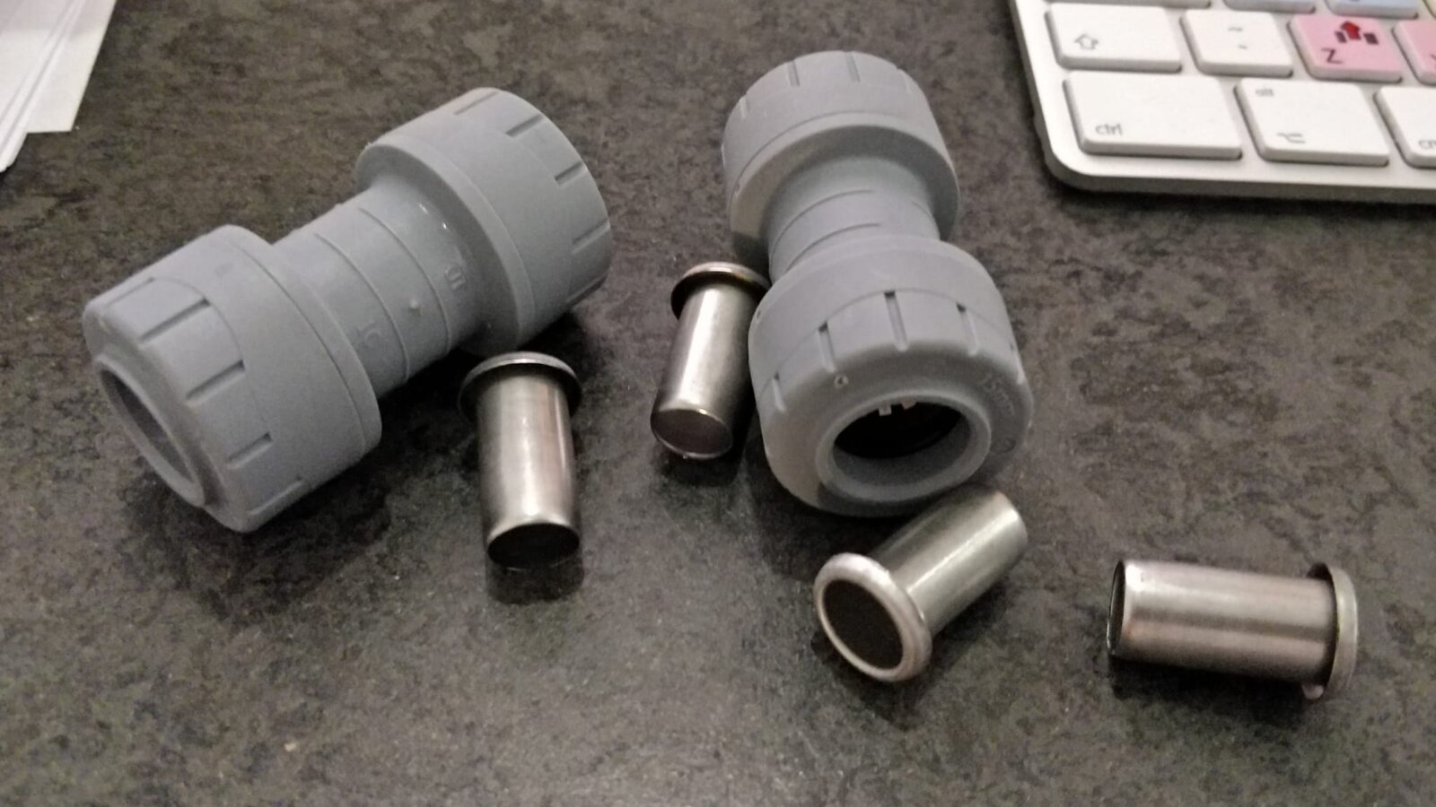

Just want to check, these are the correct bits we need?
Equal push fit coupler
https://www.mpmoran.co.uk/speedfit-coupler-15mm-100005726
and we need 15mm flexible plastic pipe
would this be it?
https://www.mpmoran.co.uk/barrier-pipe-polybutylene-length-15mm-109114703
got these as per shop advice.
Hope he gave correct advice as it is different to the one laid by the emergency pumber
