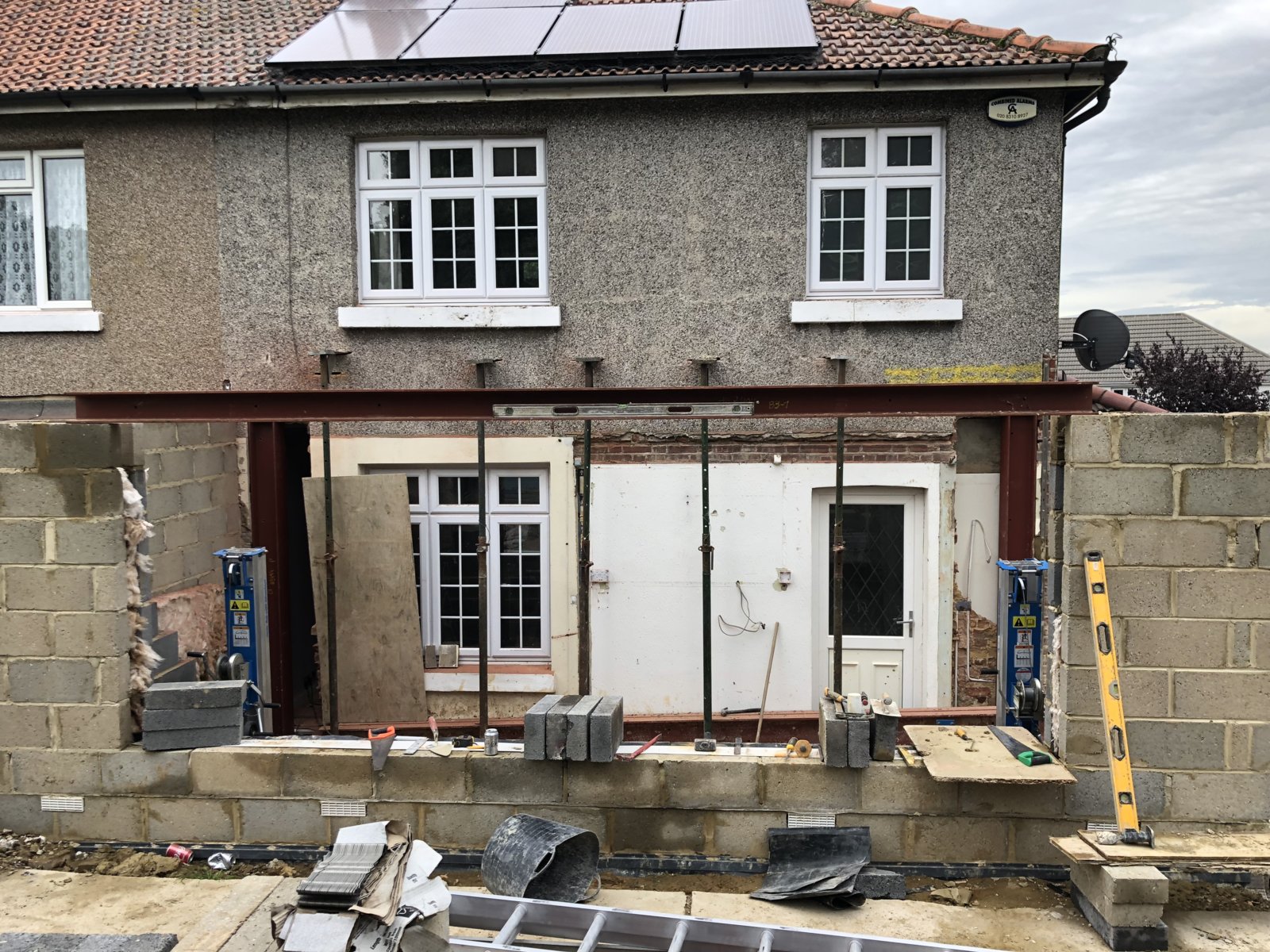

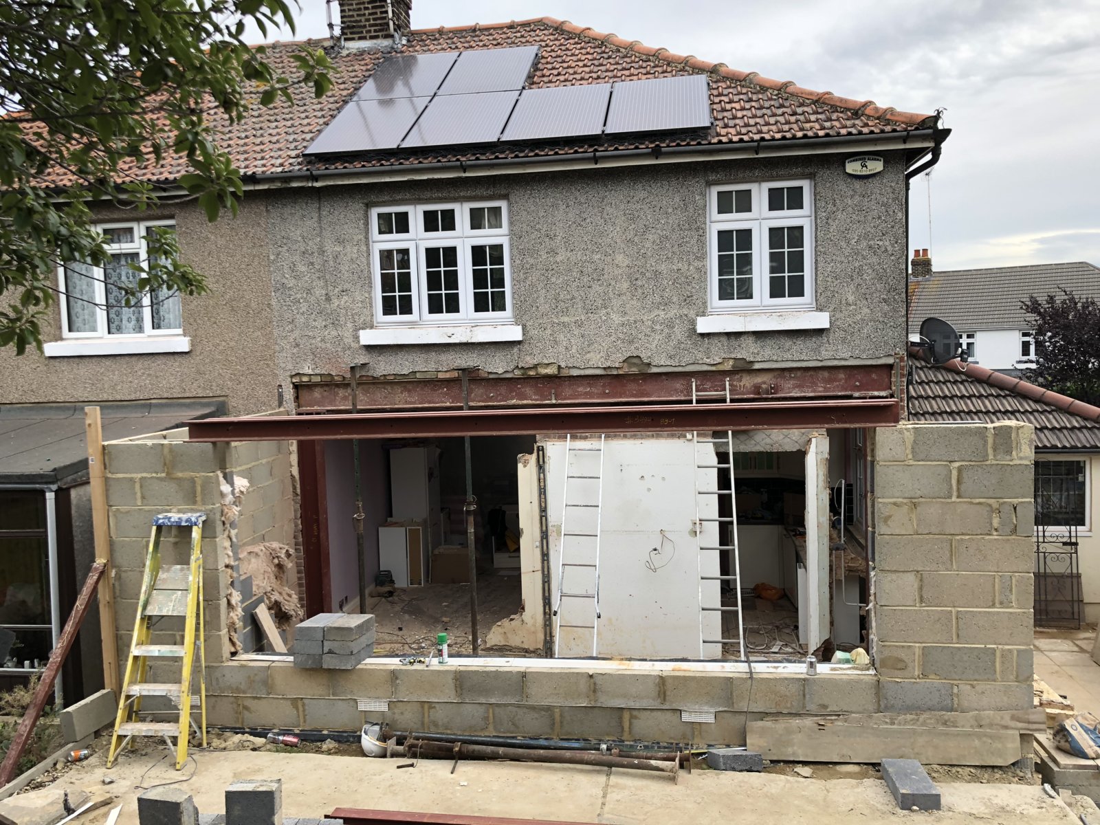

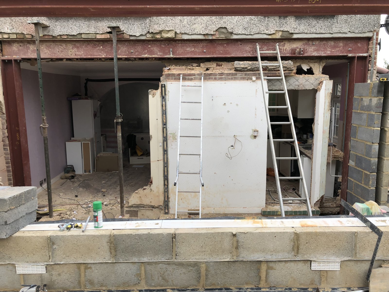

Right guys, the beam is finally in and brickwork added between the beam and the rest of the house.
Glad to say the house didn’t fall down!
5 props on strong boys on the outside. 3 props holding up the ceiling joists on the inside.
Strong boys and props up in day 1, walls out, steels in, and packing in day 2. Day 3 fill in the remainder of the packing.
It took 4 guys (including myself) and 2 genie lifts. Hardest part was wall removal. We lifted the first beam in first, got it into position, then lowered the genie and got the 2nd beam in.
Surprisingly I have not seen any house movement or unexpected cracks forming when the house was only supported on props. I guess combination of a joining internal wall, a concrete lintel under the the Windows etc and the props all helped to keep the building secure.
Glad to say, the monsters are in and we can see light at the end of the tunnel.
