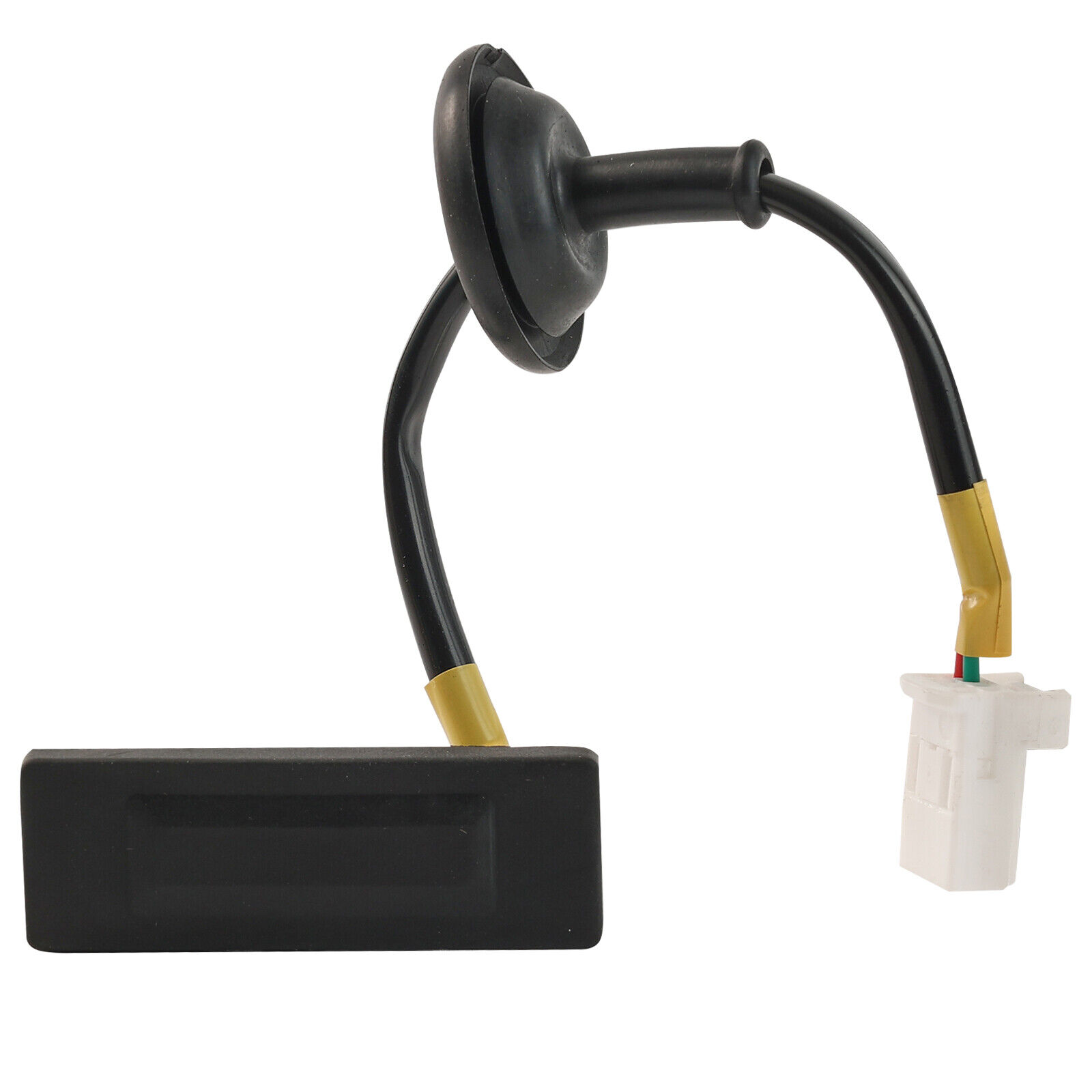

I still can't work out what the boot switch actually does - this sort of switch:
It fits behind the boot handle, so it senses when the handle is pulled open - but what does it do then? On my Picanto, when you pull the boot handle, there is a lever attached inside, which is attached to a metal rod, which goes down to the 'claw' and opens it. (There are two other metal rods which also go to the 'claw' - one is from the key operated lock, the other is from a flat motor, that is part of the central locking. All the rods go to the same place, but operate independently of each other.)
So I can't understand what the car does with the signal that it receives from this switch, and therefore I can't understand why it's there! And as you say, it's probably some sort of sensor. Which I can't find!
Two terminals/wires, so I would guess at a reed switch, operated by a magnet. Basically, a metal strip, encased in a sealed glass tube. Put is near a magnet, the metal strip will move to either make, or break the contact.
You can test its operation with a continuity meter, and a magnet.
Yes, but what does it actually do when it makes the circuit? What happens in the car electronics? How can it tell the car that the boot is open, and thus cause the light on the dashboard to come on?
Kia forums would suggest the boot light switch
“is located right next to the catch under the flap at the rear of the trunk floor. “
Hall sensor effect.
