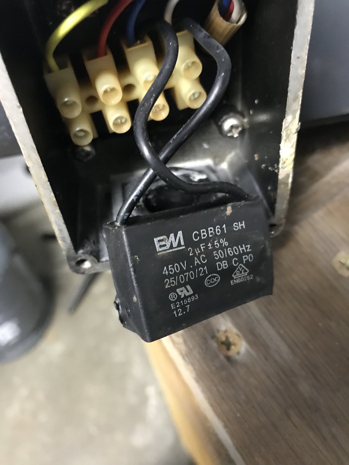

I’ve removed belt and the discs do turn freely however the motor is not turning when supplied with power via the control unit.
I’ve currently removed the motor with a view of replacing this item. Am I right in my diagnosis that this has failed or is there anything else that I should do prior to sourcing?
Finally there appears to be a capacitor in with the wiring is this likely to have failed is there a way I can check. It looks a little odd!

When applying power to the motor does the fuse blow?
Can you check for water ingress in to the white connector box on the left there? Looks like swa terminates there - could be damp.
Running the unit without the discs turning means the sewage isn’t treated so it will be a bit smelly and you’ll be discharging untreated effluent in to the water course (not ideal!)
The fuse did not blow when powering the motor. There are no signs of water ingress within the connector box.

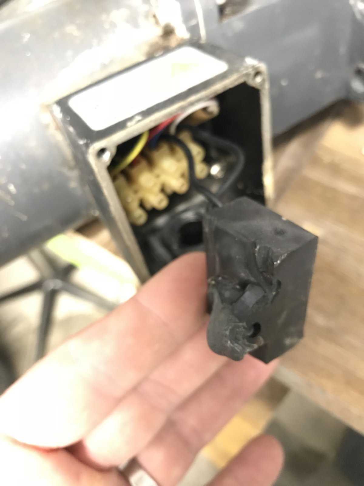

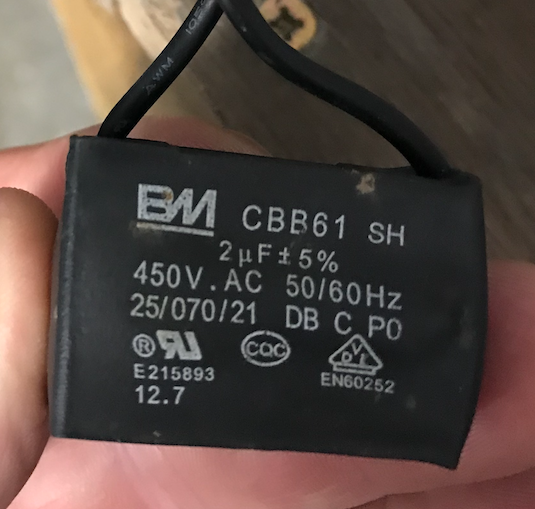

Looking at this capacitor again and it does look odd and has maybe failed? Am I able to test this via my meter?
What is the purpose of the capacitor and why may it of failed? I guess that this failed and blow the fuse within the control panel and hopefully the motor is still in tact?
you wont need to test the cap it is fecked, a new one is not expensive and the motor wont turn until you get one
That cap looks as if it has got a bit warm- good odds is has failed short & blown the fuse eventually. Replace it & try again before you spank £300 on the Kingspan engineer. Also worth disconnecting the motor (and make safe any floating bits of cable) then check the fuses, power up the box and see if that LED display comes up with anything

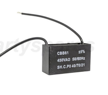

I'm just about to order one of these: https://www.ebay.co.uk/itm/332742202003

But am not 100% sure if its an exact match for what I require?

The critical number (that is missing on the case of your proposed substitute) is the capacitance- the existing one is 2 microFarads, that's the value you want for the new one. All the rest of the numbers (apart from the voltage and frequency) are not that useful
Ah okay I'm learning here :) I've just had another look online and I can select a 2 microFarads version via a dropdown on this auction. Trust this will do the job? https://www.ebay.co.uk/itm/CBB61-AC...m=332617433876&_trksid=p2047675.c100005.m1851

Ah okay thanks you posted as I was typing.. Shame its in France! Typical. I'll have another hunt around to see if I can find a waterproof version in the UK.
There are lots of them on there, but you will have to get the voltage and frequency to match, and as already said it has to be 2uF
