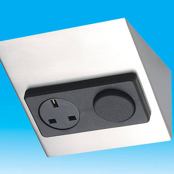

Thanks very much for all your replies. My predicament is this, I had a kitchen extension built last year, but as we did not have plans for the new kitchen at that time, sockets were only fitted at skirting board height.
I have now decided on the kitchen style, and obviously require sockets at worktop height. All the plastering has been done, and I am really trying to avoid having this chased out.
Could anyone make any suggestions as to what I can have fitted to avoid this. I have seen the pop up counter sockets, but I am not very keen on these.
Any suggestions would be much appreciated.
