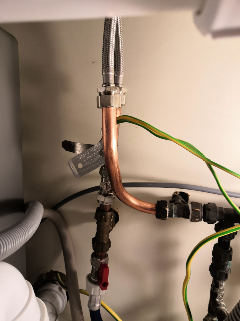

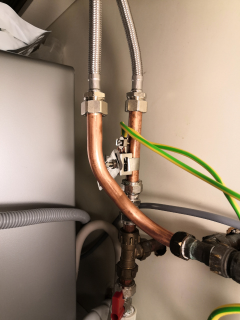

For my pipe bending training, I did a double bender. The elbows of the bends are significantly larger than what can be achieved by soldering and compression. Still, I eliminated 2 potential leak spots by using bendy pipe. The previously greased copper olives could be reused after pulling out with a puller. What appears to be a dent in the pipe is actually the typical rise at the end of the bend.

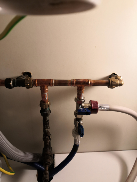

Replaced a couple of compression T's and taken out 6 points of potential leaks. The solder from the solder rings didn't come out all that well in horizontal positions, but dribbled profusely in bottom locations. I didn't try hard to add more solder to fill bits at the top. I used the minimum setting on the blow torch and have plenty of heat capacity left to be able to deal with 22mm fittings.
