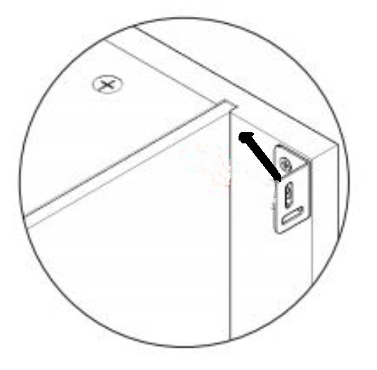

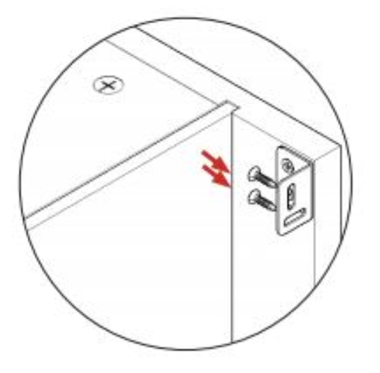

Whats your common sense solution for driving these screws into the wall?
The kitchen my wife ordered was Wren and the backs are quite thick and not removable, I just drilled a single hole for each bracket but at an angle of about 40 degrees and put the raw plug and screw in at an angle. It probably makes a stronger fixing than straight in too...
And what if there isnt a large enough gap between the top of the cupboard and the ceiling to do that?
L shape bracket down onto the units edges, it looks like three units, I'd laser the level they all need to be at, mark it and install the units separately to allow for moving them left or right a little, middle one would go in last. Leave all the screws slightly loose until all three units have been leveled to each other and screwed together then nip them up. That's probably easier to write than to read! The Wren instructions are very "generic" so best taken with a huge pinch of salt..
Pivoting impact driver extension or wobble bit driver...
I've managed to get around this one by cutting a hole in the back, screw through it and then cover with a cap.

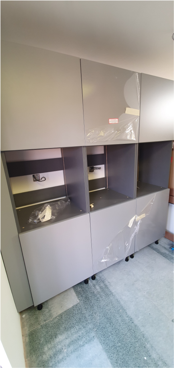

The next problem (opportunity) i have now is in the filler strip that is in the pic, i installed this flush to the body side of the first tower ie not the door. Looking at it now, i am wondering if this should be actually flush with the door?
If there are doors to be fitted to the middle section then it may look better line with the doors.
Personally I dont mind an open space on the end of a run with some shelves for trays etc but then I prefer to use all available space over so called clean line:)
Yeah i know what you mean, i am trying to work out where the cornice (i think thats what its called, the big long bit that goes across the top of the run) and whether this goes flush with the doors or in line with the body of the cabinets. The end panel i have put on goes flush with the doors but if the cornice goes flush with the body and not the doors there will be a bit where they meet where it will not be in line.
What i think i am trying to say is i need to install the cornice so that it is flush with the doors and the filler panel needs to be refitted so that it is flush with the doors and not the body.
Many thanks for the vid, yeah looks like they go flush with the doors. i'll sort out the filler bit later on i think, pretty sure it needs to be on the same level as the doors too.
