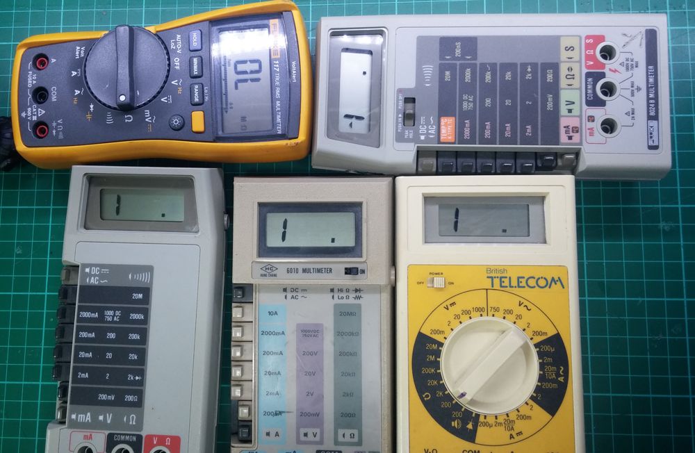

Some better meters may read OL - letters - meaning Over Limit for open circuit.

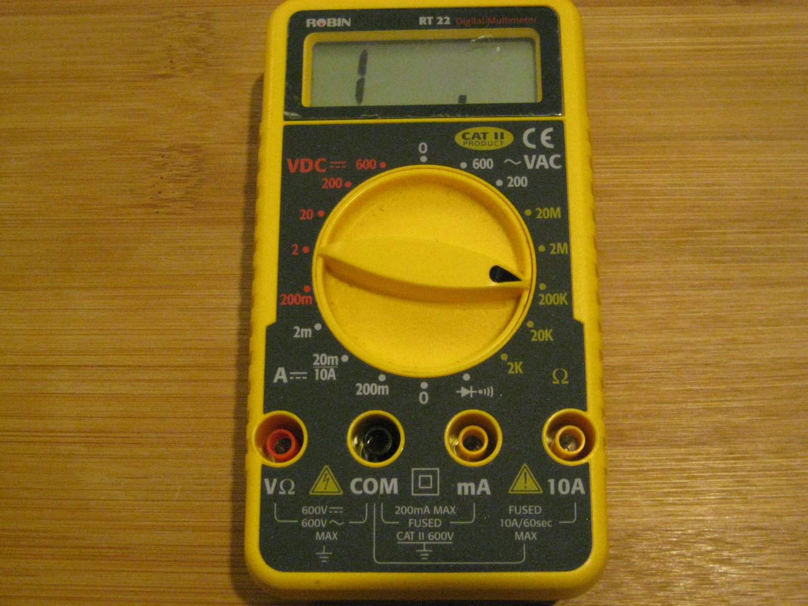

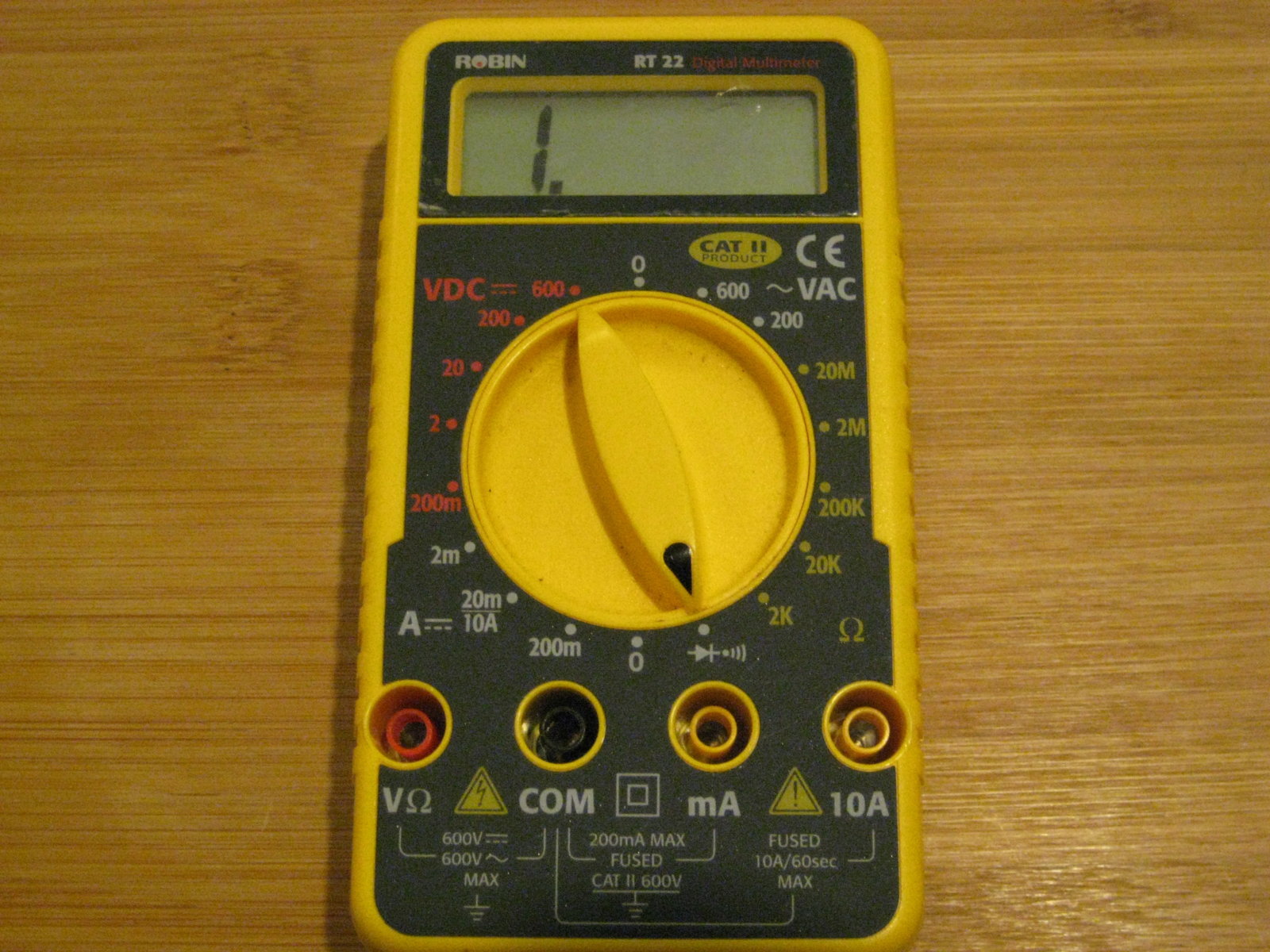

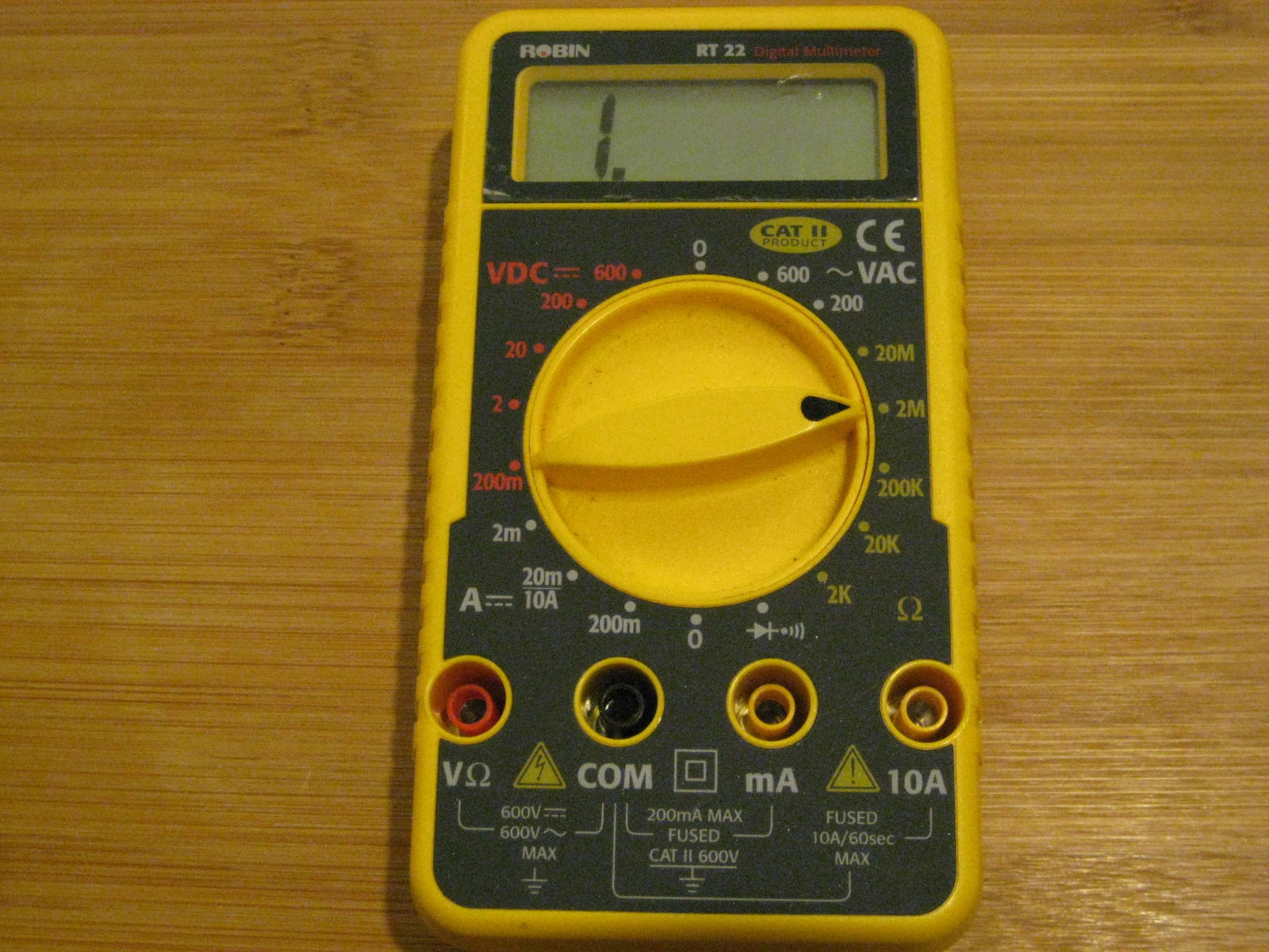

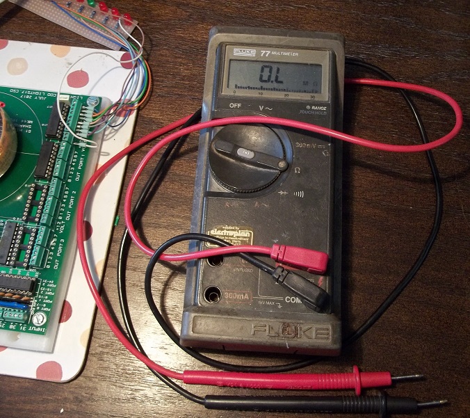

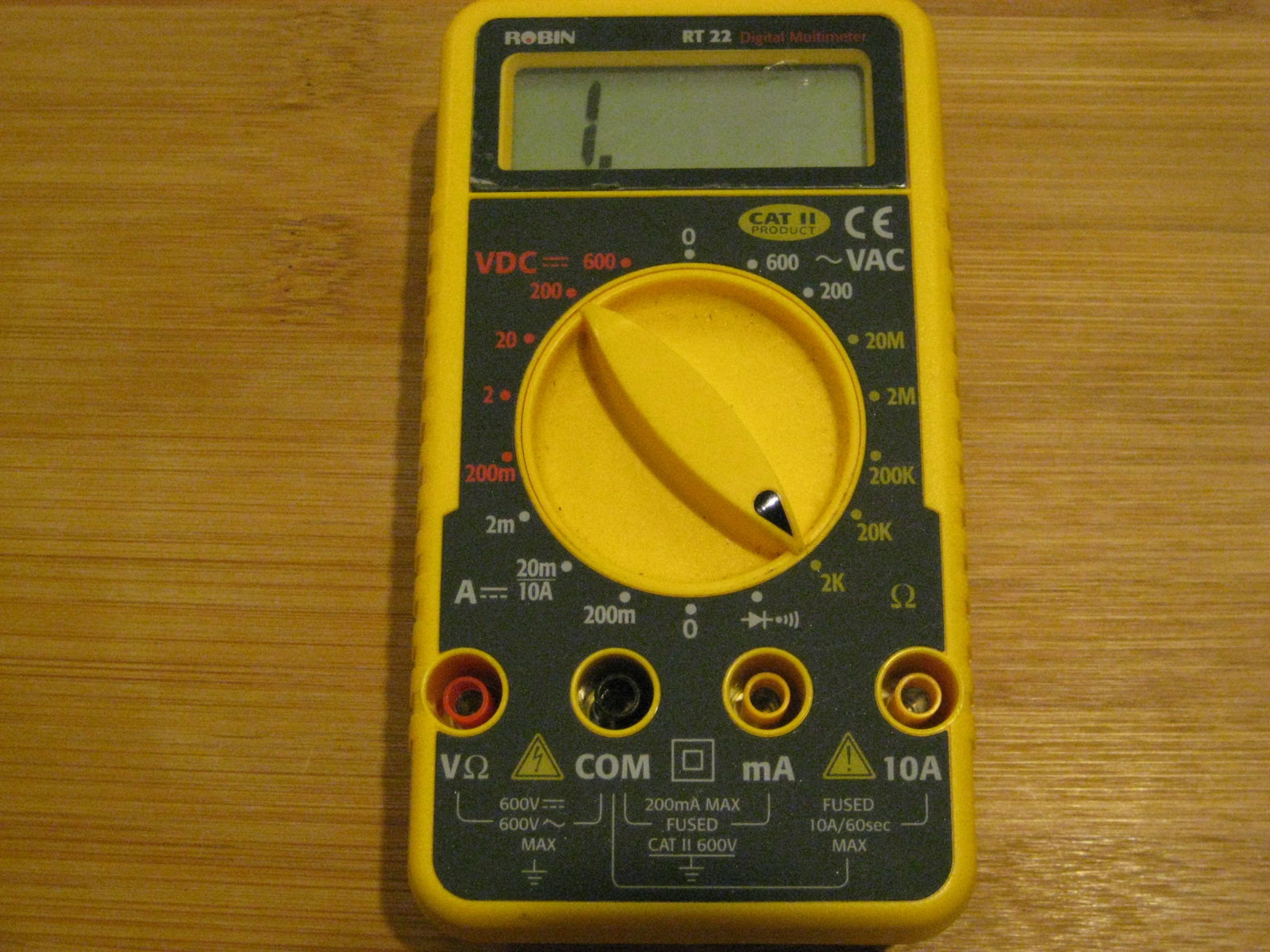

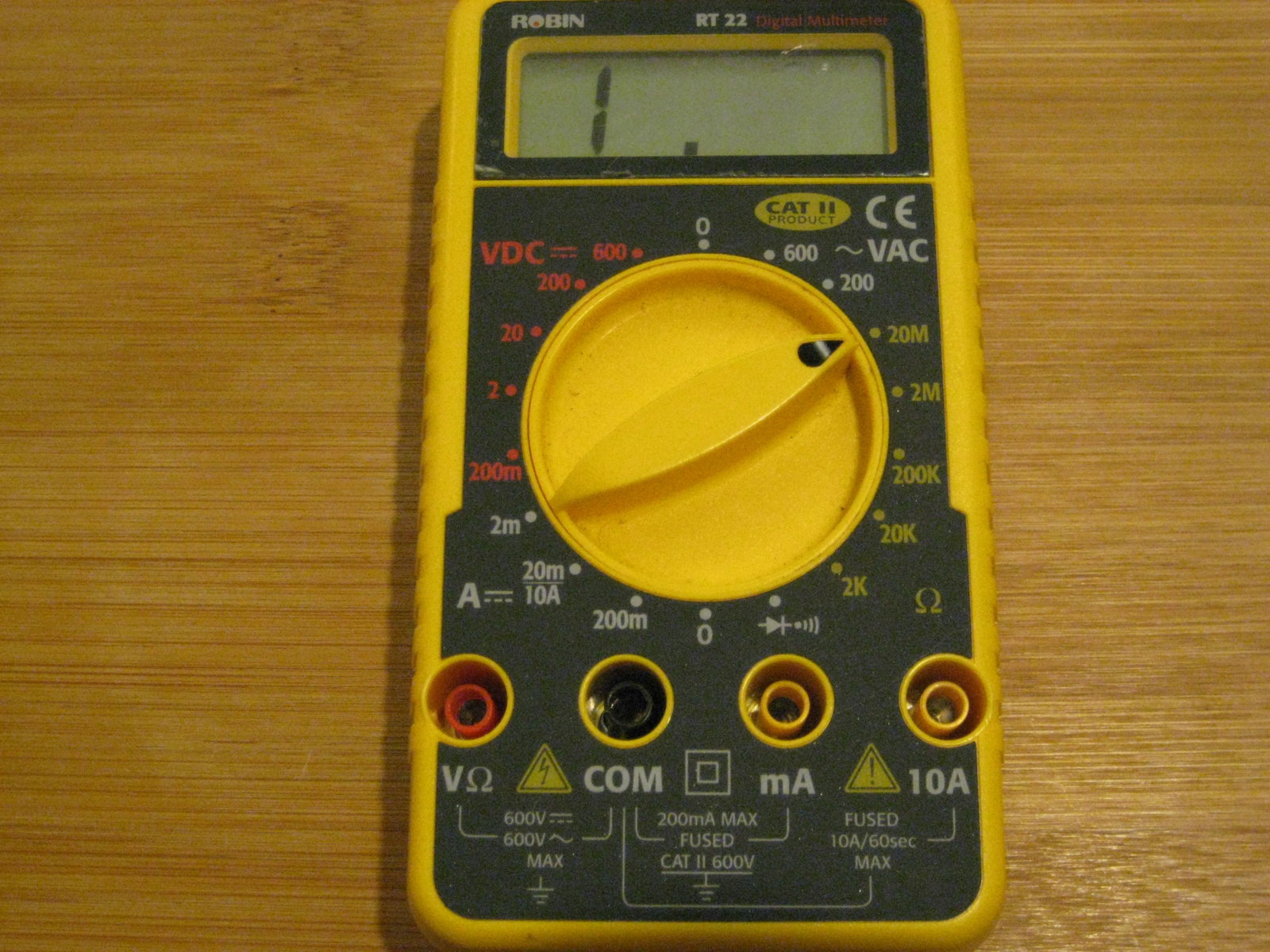

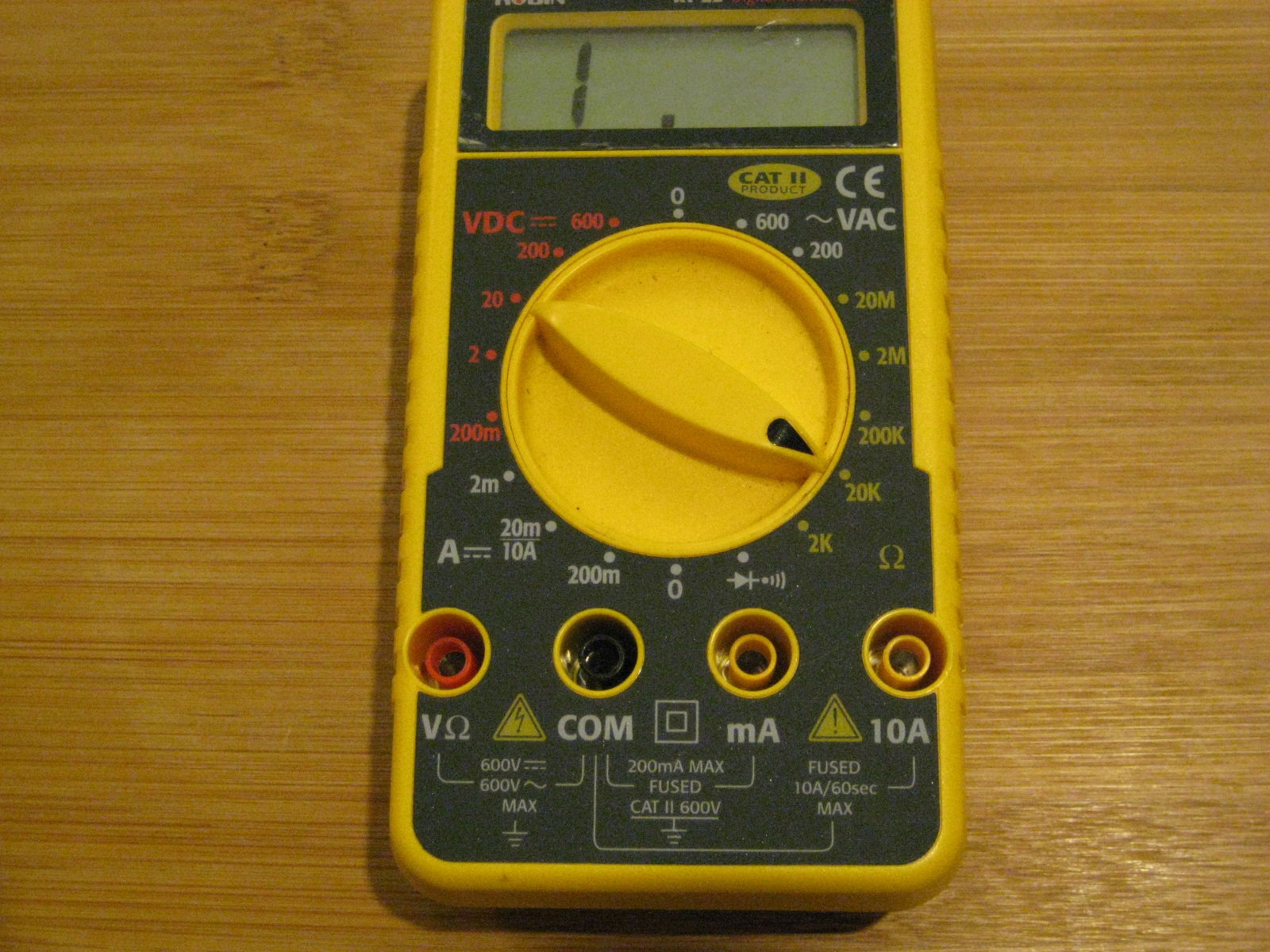

Bear in mind I posted as soon as I discovered this issue. Interesting that some multimeters do show "1" for an open circuit.

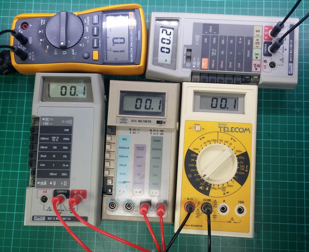

Thanks for the selection Flameport. Interesting that it's (reasonably) clear on the screens that the open circuit is such and not a reading. A more sophisticated device could null the lead impedance out but I stand by my original point that the Klima instructions are wrong in saying that an open circuit "should read 0".
