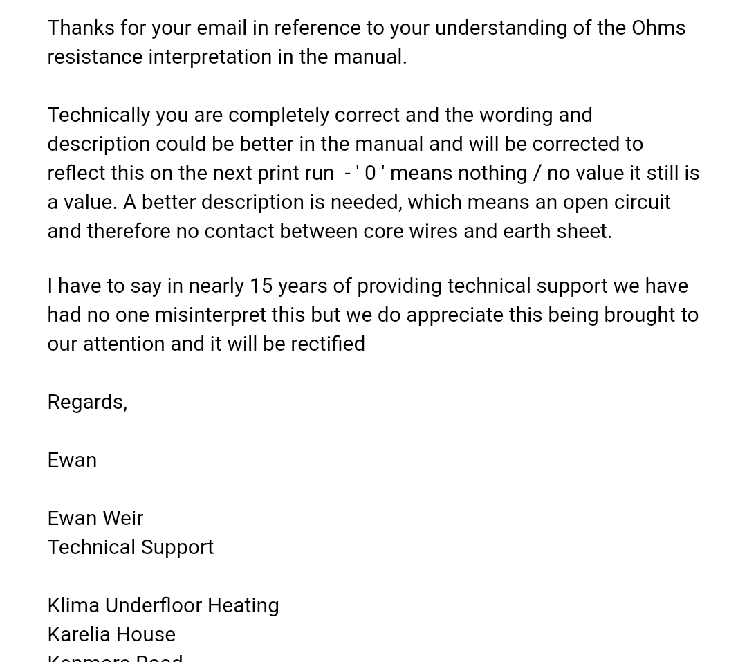

My mistake, the manufacturers state 150w per sq m. I remembered the mat being 2 sqm but it's 2.5sq m so 375 watts it is (plus or minus whatever manufacturing tolerance there is in the heater wire).

Here's the response I got from technical.
They didn't even answer my email. I work in the aviation industry where we are taught to question any ambiguity lest it causes an accident. They seem surprised that this is the first time someone has noticed this.
