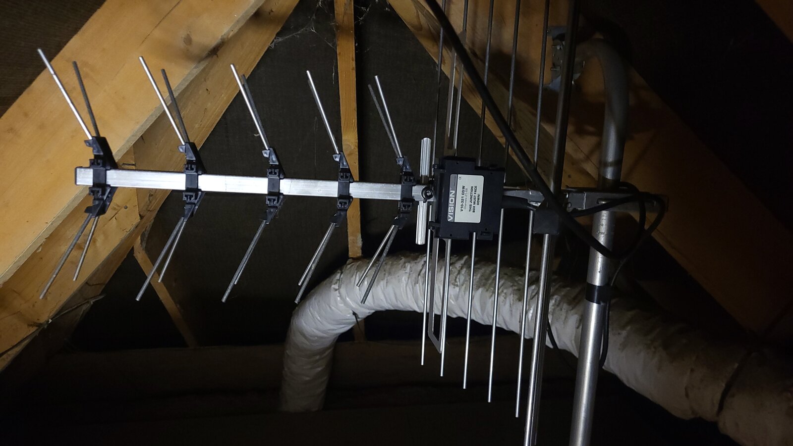

I currently have a Vision V10-321 installed in my loft
32 Element Wideband Vision V10-321

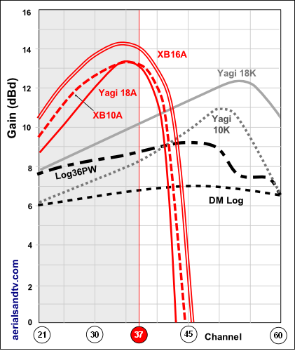

Nasty wideband aerial... low gain for group A frequencies .. all widebands are the same except log periodics. That's also a relatively small "high gain" antenna. 13dBisotropic = 10dBdipole approx at it's peak.
Your aerial will only have around 6dB gain at group A frequencies, the same as a small log periodic.
https://www.aerialsandtv.com/knowle...s#wideband-aerial-gain-curves-and-comparisons is Justin's measurement of that style (see XB5WB curve). Justin (ATV) doesn't reckon those 5-bay X elements at all. Any group A will better that.

I'll assume you have mounted the aerial vertically rather than horizontal and put the reflector on correctly.
Put OS grid an 8m height .... advises to use Vertically polarised extra high gain aerial.
The aerial is mounted as per pic .... sorry its not too good a picture. Points straight out through tiles to Kilvey Hill, but village is in a bit of a dip hence low signal.
This aerial was the one recommended at the time as being optimum for digital channels from KIlvey.
