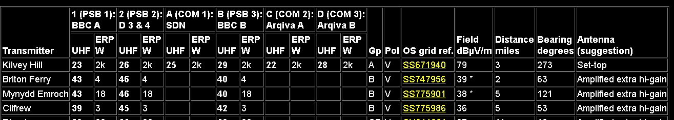

It does look that I can get 10dB gain by changing from wide band aerial to the XB10A.

Note the current antenna has a gain of 5.7dB ch21 to 7.5 dB ch37 (using Justin's charts). The XB10A is 9.5 to 13 dB for those frequencies. I make that at best a 4 to 6dB (rounded up) improvement (which is still considerable but nowhere near 10dB).

Agree I was a bit optimistic on initial comparison of the 2 charts from AV they advised my Vision aerial is the same as as XB5
Looking at Ch 37 peak .... the XB10 is 13.5 dB where as the Vision is 6.8dB
I had overread, it's ony 7dB gain, but still a big improvement, and importantly it's good for rejection of unwanted frequencies, and thus interference.

The Wolfbane data advises I need an amplified High Gain aerial .... but I think this is pretty unspecific geographically.
I don't have a meter or I would measure the signal.
Kilvey Hill uses 21, 24, 27 (HD), 25, 22 & 28 (plus 34 Local). So gain for 21 to 28 are the only really relevant ones here.
Yours is 6dB-/+0.5dB vs 9.5 to 12.7 --- so only 4db at 21 and 6.2 dB at 30.
Wolfbane data was 79dBuV/m clear line of sight and 'set top aerial' on your AVForums thread:
Although you state there's a 50m away terrain 'obstruction' which would reduce signal a bit and possibly diffract to give 'standing waves' where aerial positioning can be critical.
