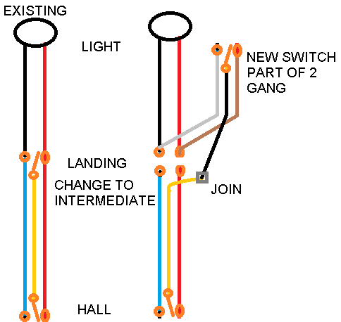

Assuming the existing is something like the left part of this:
And you are able to run a 3C&E cable between the 2 landing switches (Shown in new colours) it is as easy as adding the new 2gang switch and changing the existing to an intermediate.
Photos of the wiring (with power turned off before you wield a screwdriver please) of the 2 existing switches will enable us to give full advice.
EDIT: Earth wiring has not been shown for clarity.

Yes, an Intermediate switch is a special type. Looking at Sunray's diagram, to the right of "LANDING" the switch has 4 terminals which either connect black to blue and upper red to lower red OR black to lower red and upper red to blue.
An Intermediate switch can be used as a 2-way or even a 1-way.
For now I'd deliberately not gone into any detail as we don't have a clue what or how is currently installed, my sketch is really just to show how simple it is likely to be.
For all we know it could be 2 strapper method with borrowed neutral for example.
