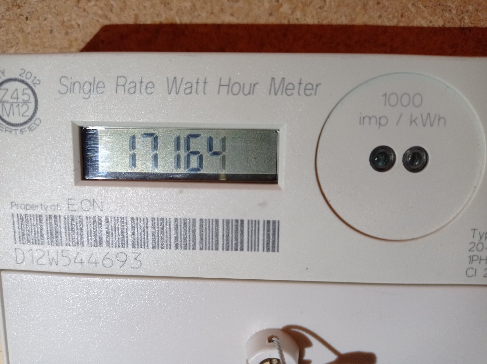

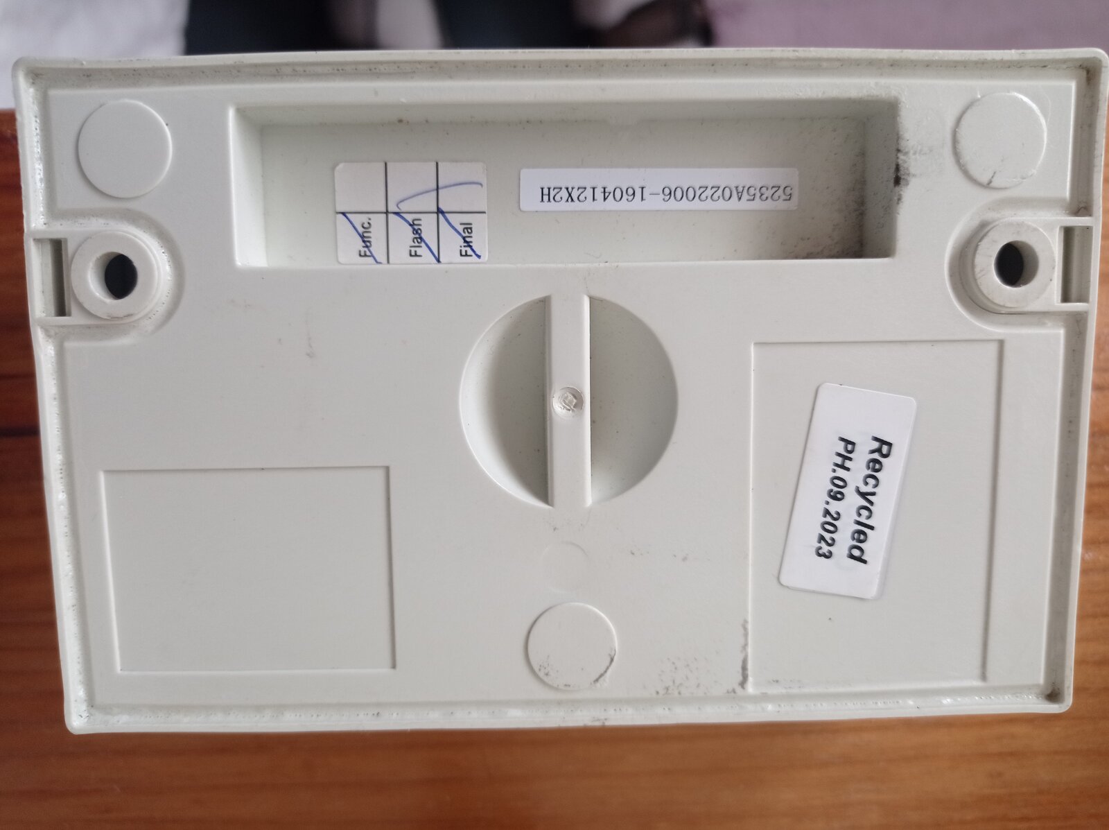

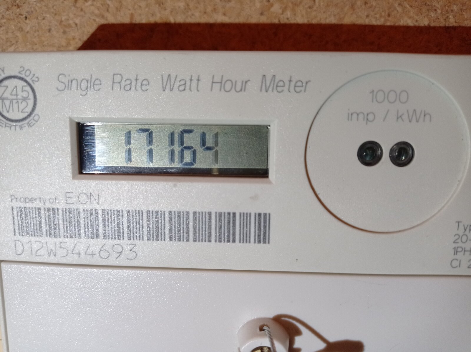

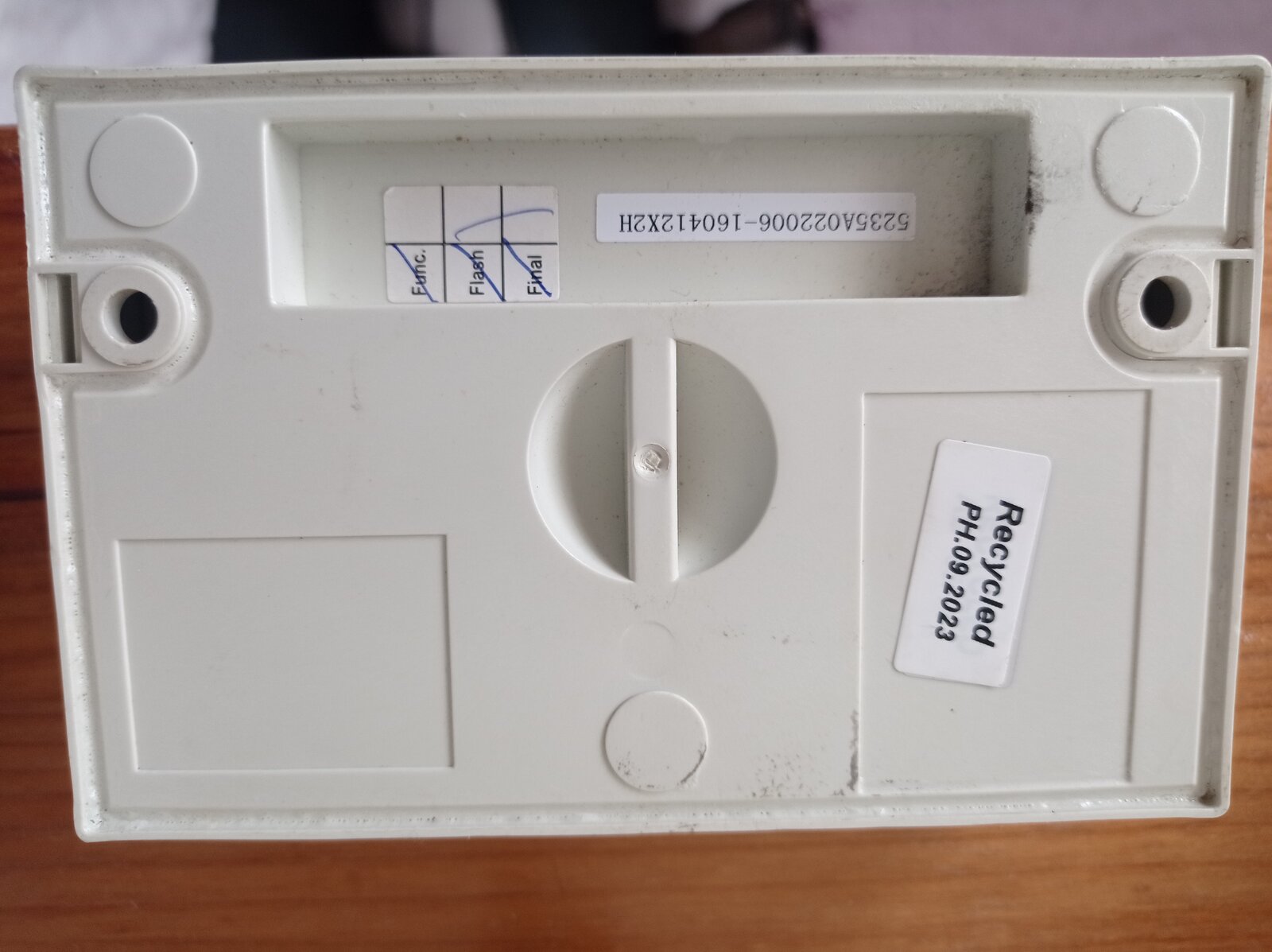

The meter in question was manufactured in May 2012 and has a label on it saying that is was "recycled" in September 2023. I understand that energy companies are not supposed to use meters that are over 10 years old. E.ON have not supplied any photographic evidence of the opening reading so hence the doubt about their honesty. Please see attached picture of the meter of E.ON's which was taken out and replaced with our own due on the 5th May due to the doubt of their practices. I think that it clearly shows 17,164kwh unless I am mistaken. Also they have sent the reading to our new supplier the figure of 18,286 stating that is what they state is genuine hence us challenging them on this ridiculous figure.
No, the rule is the calibration is supposed to be checked, every 10 years. If they pass, then they can be reissued. Often they do go unchecked, for many decades.

the normal display mode shows energy use to two decimal places. I think @Rodders53 called it right, you have used only 171kWh in the photo you posted.
I cannot see a decimal point, in the OP's photo of his meter, but yes, according to the manual, the rightmost pair of digits, follow a decimal point. Hence 171Kwh it is..

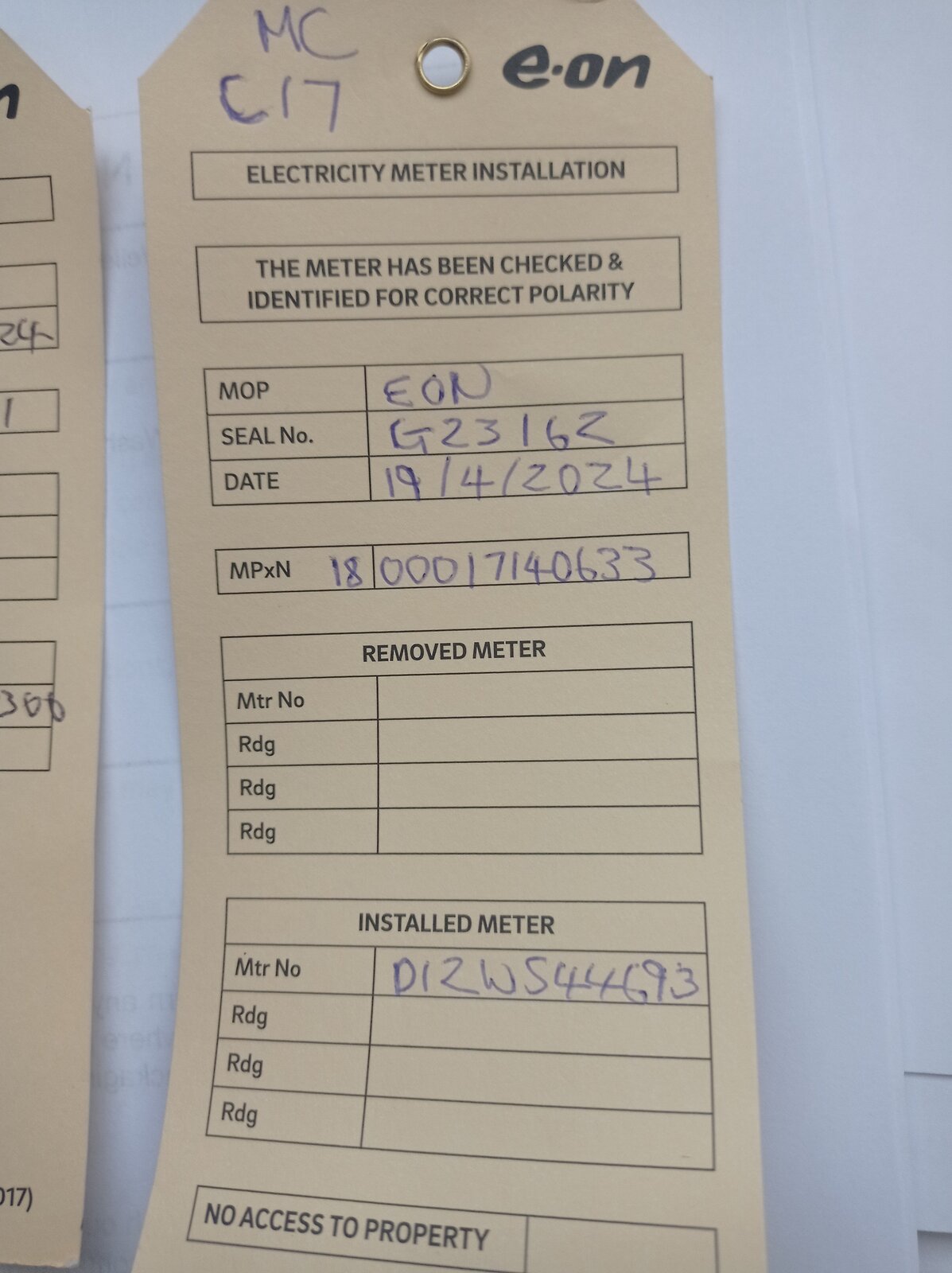

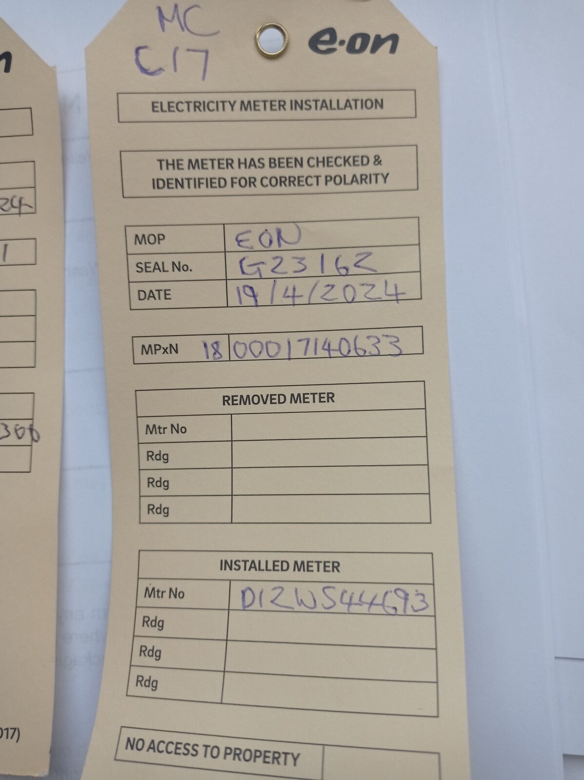

As you can see there is no decimal point in the reading. I submitted 171.64 to our new supplier EDF and E.ON came back with 18,268 kwh challenge. Also see attached picture of the meter tag where E.ON omitted to put in the opening reading on 19th April. They put in the opening reading for the gas meter tag. Another mistake ? Would I be able to argue in court that the figure of 17,164 is just 171.64 when there clearly is no decimal point ? The manual clearly shows decimal point in its readings.This is my concern.
  • E.ON Electricity meter tag with missing opening reading-19th April 2024.jpg
