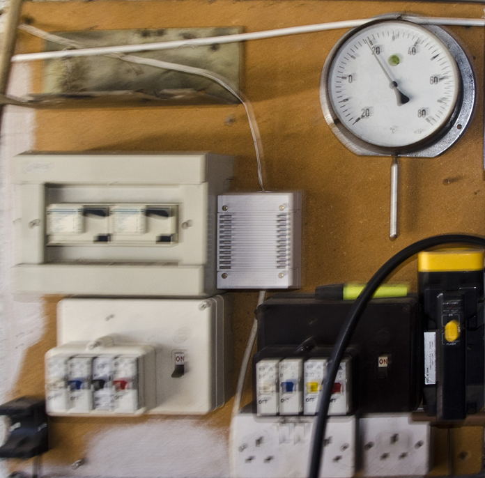

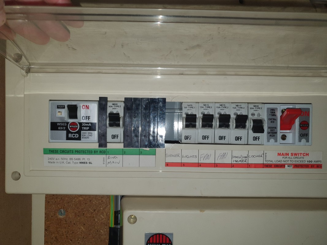

" Strip down the existing boards
Prepare the areas and connections for the new installations
Install a new metal 6 way split-load board with dual RCD protection
Install a second 5-way metal board with RCD protection
The above is all that I have received for remedial work.
However going back to the report under 4.0 Consumer Units/Distribution Boards is listed
4.4 Condition of enclosures in terms of fire-rating ('é&.1.201;526.5) C3
so that's only a recommendation.
Have we been told why it is thought you need a new CU?
Insufficient space perhaps ? He speaks of dual RCD's on one board where there is already one Wylex, although it does seeem to me that there is enough space for another RCD, and then he mentions " a second 5-way metal board with RCD protection" and I am unsure how that works with the WYLEX fuse-board with the 15A fuses.
Over to you.

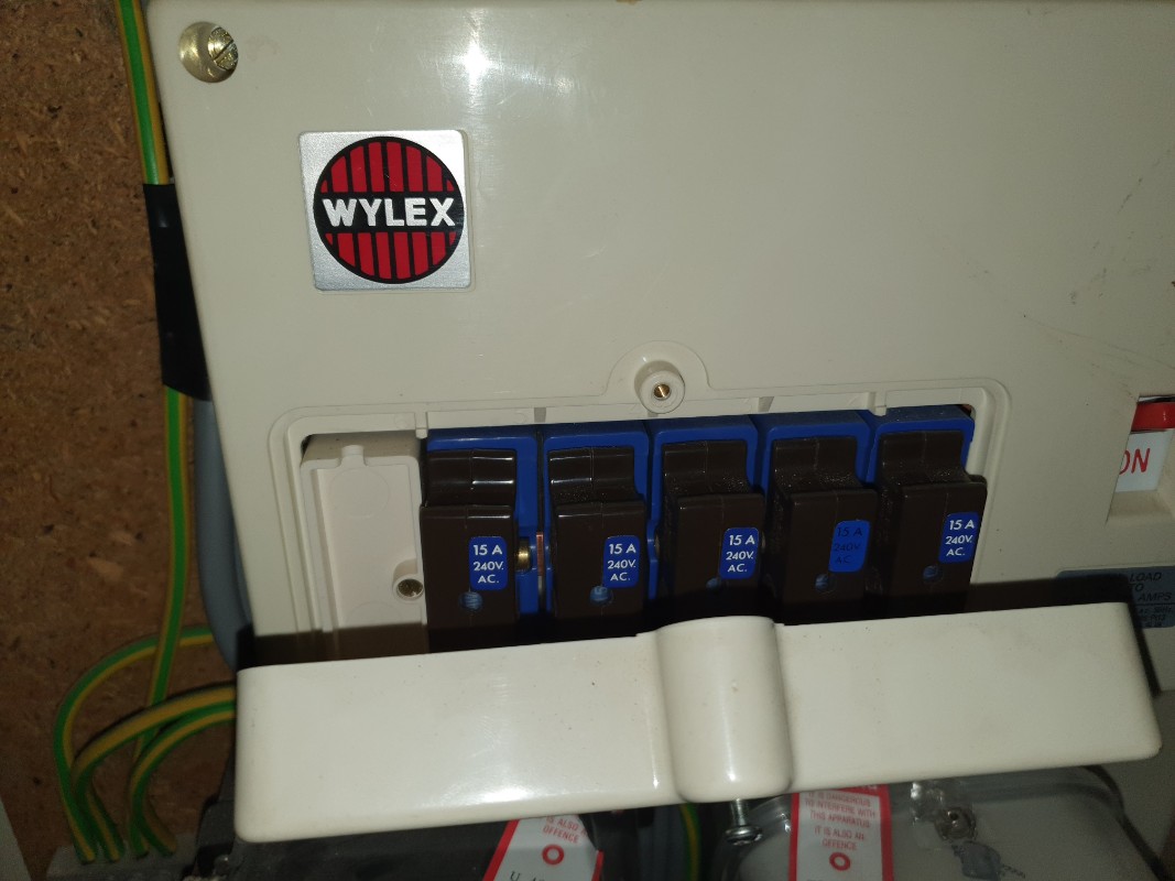

You have old likely obsolete distribution boards, likely the larger board got a code 1 due to missing blank, that is easy enough to cure, however as to upgrade the question on need for upgrade is linked to 701.415.2 Supplementary equipotential bonding.

Yes it will be let, but I do not want to waste money/waste product (80/20 to be honest ) Is it reasonable/economical to ask for the second RCD ( per quote ) to be installed in the first WYLEX board and not require a new board ?
To;reply to ericmark there were no C1's.
No.
The existing one is 20+ years old and obsolete, there are no parts available to fit into it.
It was designed to have one RCD for some of the circuits, there was no option for multiple RCDs even when it was a current product.
The options are keep what you have got, or replace the whole lot.
If you keep the existing one, you won't be able to have any alterations or additions to any of the circuits.

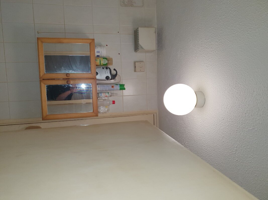

2) What height was measured in the bathroom that puts the fitting in Zone 2, ? I believe that the ceilings are higher than the standard 230 cm and no live element would therefore be within the 225cm Zone 2 limit
Reply:
All the code 2 and code 3 observations on the report will be rectified once the remedial works have been carried out, the bathroom light needs to be IP rated regardless of ceiling height.
The make of RCD used will be british general and all circuits will be covered by the 18th edition split load consumer unit once installed, the only other circuit covered by the existing RCD is the ring main circuit.
He doesn't answer why the bathroom light needs to be IP-rated when the light is above 225 cm which, AFAIK, takes it outside all zones: it is probably 30-40 cm from the bath edge. He did however make the following comments in the report.
"5.12.5 Final circuits supplying luminaires within domestic (household) premises (411.3.4) is in a potentially dangerous condition. Urgent remedial action is required. C2 "
6.6 Suitability of equipment for external influences for installed location in terms of IP rating (701.512.2) is recommended for improvement. C3 "
I have difficulty in understanding how "Final circuits supplying luminaires within domestic (household) premises (411.3.4) is in a potentially dangerous condition." is obviated by using an IP fitting. This being C2 qnd the only mention of IP gets a C3
I've never heard of British General: decent make ?
That globe lamp is perfectly acceptable - and what you would fit in a bathroom.
He cannot just say an item is not IP rated - everything has a rating even if it is IP00
https://xpresselectrical.ie/product/robus-100w-bathroom-ceiling-globe/
Specifically stated as suitable for bathrooms.
Scroll down and you will see it is IP44 - the same as an electric shower and where are they fitted?
It's a low end cheapo lot that's typically sold in places like Screwfix. Made down to a price rather than up to a specification.
Split load used to refer to a board with roughly half the circuits covered by a single RCD. They were popular 20+ years ago and is basically what you have already got.
There are no '18th edition' consumer units, or any other edition. They are just useless terms invented by marketing types for people who have no clue what they are buying.
If you go with their suggestions, it's fairly likely you will end up with something like this pile of junk: https://www.screwfix.com/p/british-general-12-module-6-way-populated-dual-rcd-consumer-unit/4674g
And have a large-ish box with no scope for adding any circuits in the future.
If having teh CU replaced, it makes sense to fit one with some spare ways - as long as you have room for it of course. The extra cost of the box is very little at the time of buying it - if you want more space later then it's either an extra box of rip it out and replace it again.
