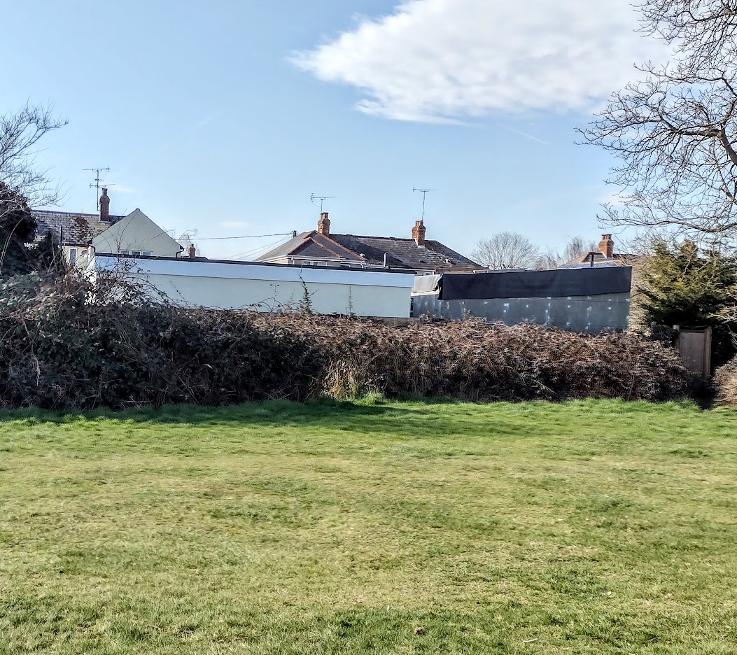

I was surprised at the size of the outbuilding in the back garden when I saw it go up, and now, there's another being built. I should point out here, I have no objection whatsoever to this, just a genuine interest.
I assume these are planning size, as look like must be above the 2.5m height - or are they (I guess a 5 foot fence along the back)? The gardens that back onto the park are long, so plenty of space. They look to be about 10m long, give or take a metre, so not small - about the size of my bungalow before I extended. Could probably get a bedroom/ensuite and open plan living in them.

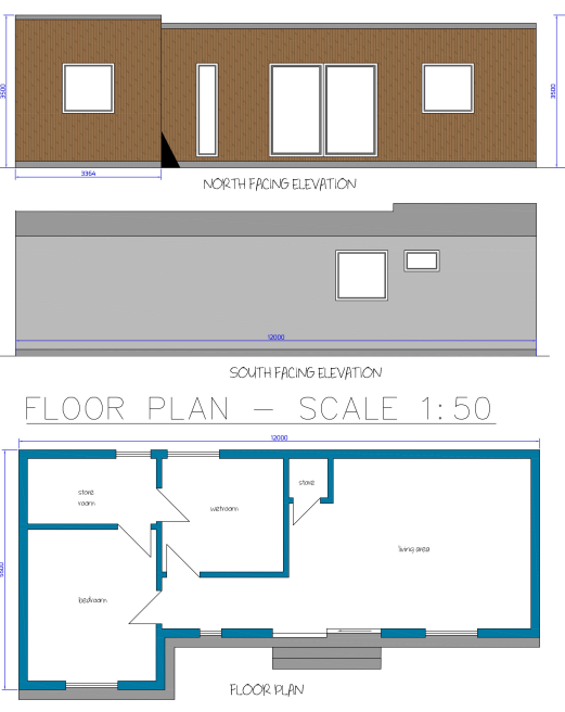

The plans for the right one, the auxiliary living accommodation:
I'm really surprised they got that approved. I'm not sure if the proposed materials will pass building control, as its not fire resistant and less than 1m to boundary + over 15m2.
I would suggest DIY cost around 12k. I built one a bit smaller (non-habitable) but to code for <5k

Ensure it is built to spec ie the height and the distance from the boundary/etc/etc.
If it is within spec, naff all you can do
However, if you feel it's been used to live in, then report to buildings control
in a concise and factual manner. Speak to the officer in charge first possibly.

over 30sq metres so need full building regs which include fire proof materials as Motorbiking has mentioned

They got planning permission, so no issue at all on that front.
But still it needs to comply with Building regulations as its over 15m2 and within 1m from the boundary. Though it could be an optical illusion from the photo. Maybe the distance is more than 1M
