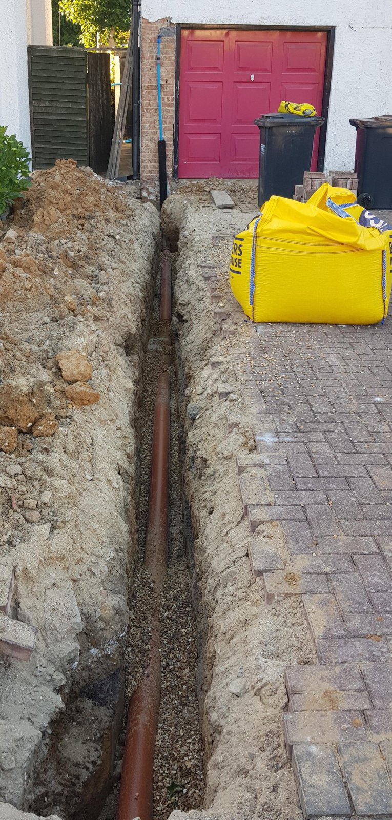

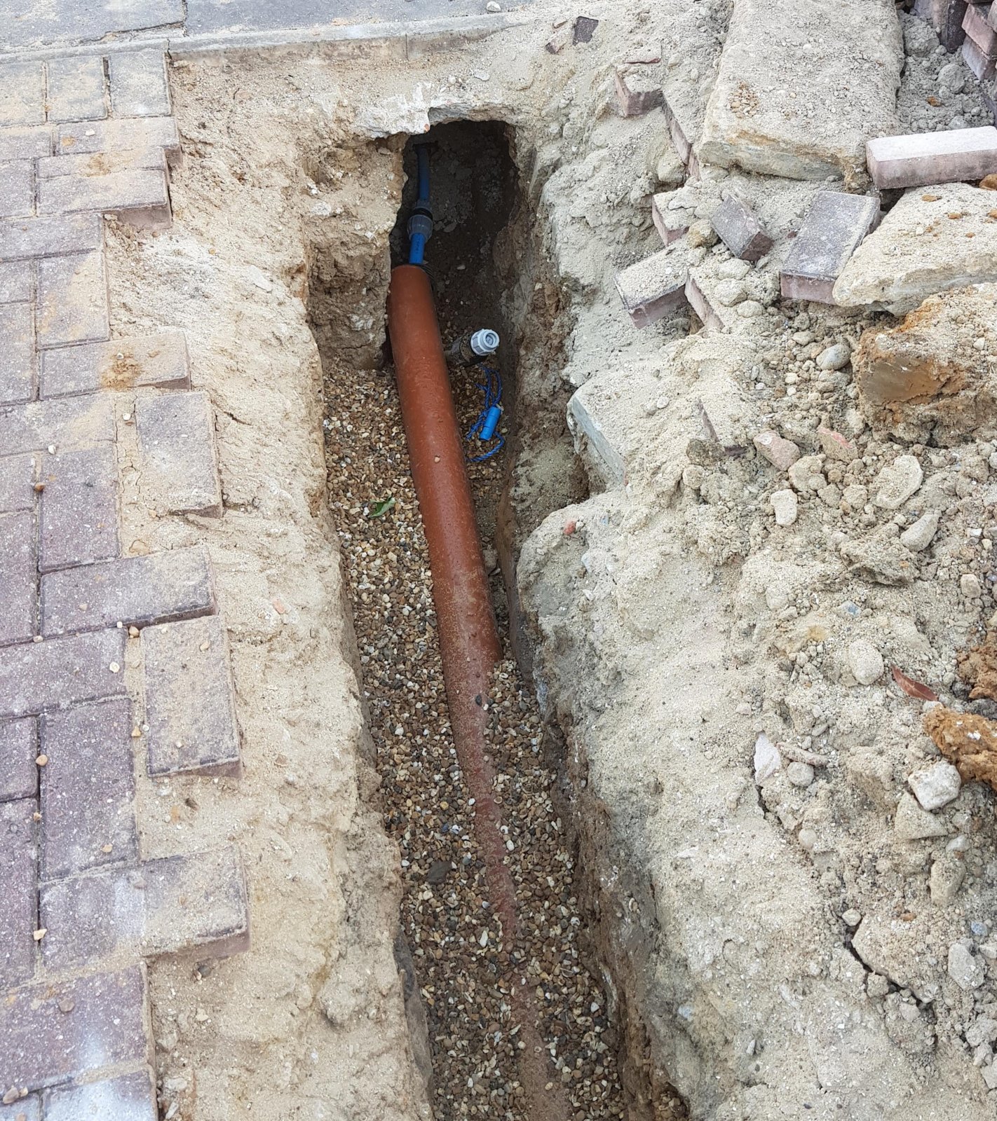

So I got the water feed connected today with a temp connection to the internal pipework until the house is re plumbed. I was quite surprised that the connection to the meter was barely hand tight i cranked my connection up a bit. I am going to leave it over night to check its all dry in the morning before i back fill.
It would have been a good end to the day turning the water back on but i now have an air block inside that i cant shift meaning we have cold water upstairs but nothing down stairs. Any ideas on how to shift it? I have held the kitchen tap closed and shot hot water up the cold via the kitchen mixer which got the downstairs WC and basin flowing (with hot water) but when i release the kitchen tap it just drains out and then left with noting.
You ignored my advice. Putting it in a soil pipe as a duct is a cowboy approach. You shouldn't have done that and I can't think why you would think that is the way to go.
