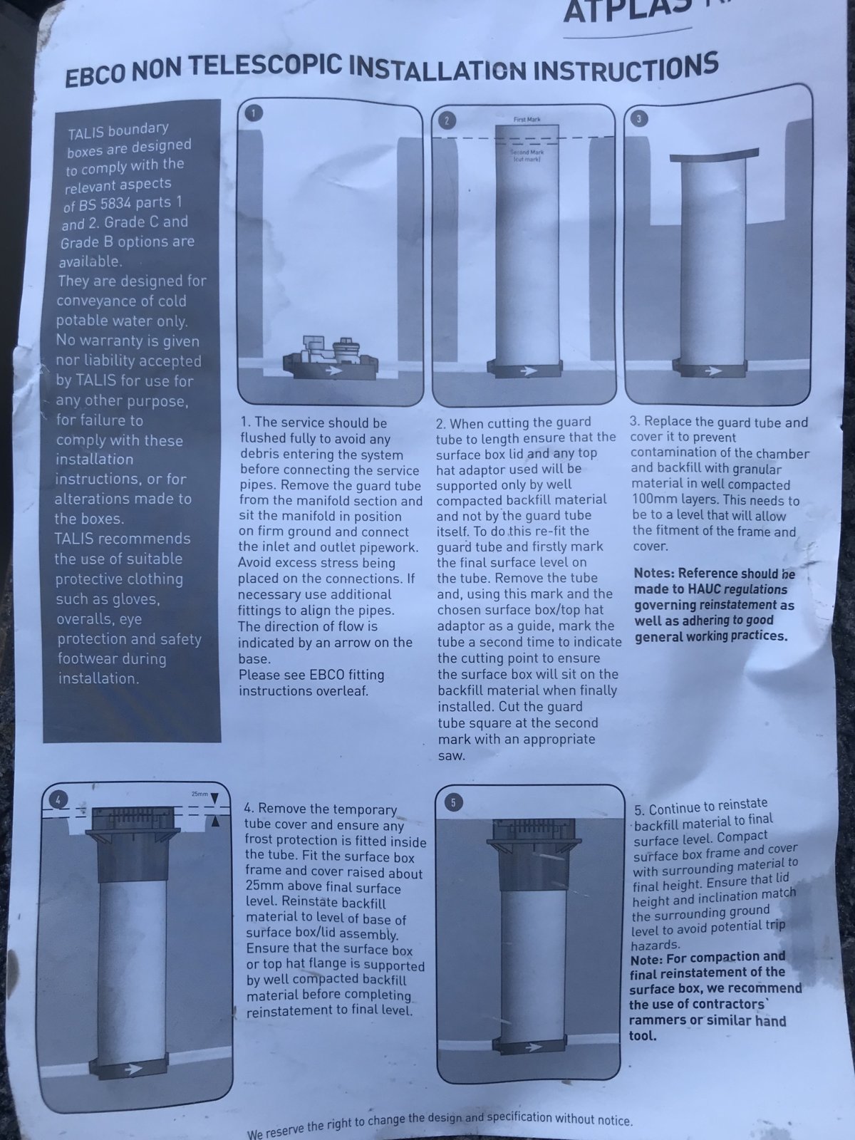

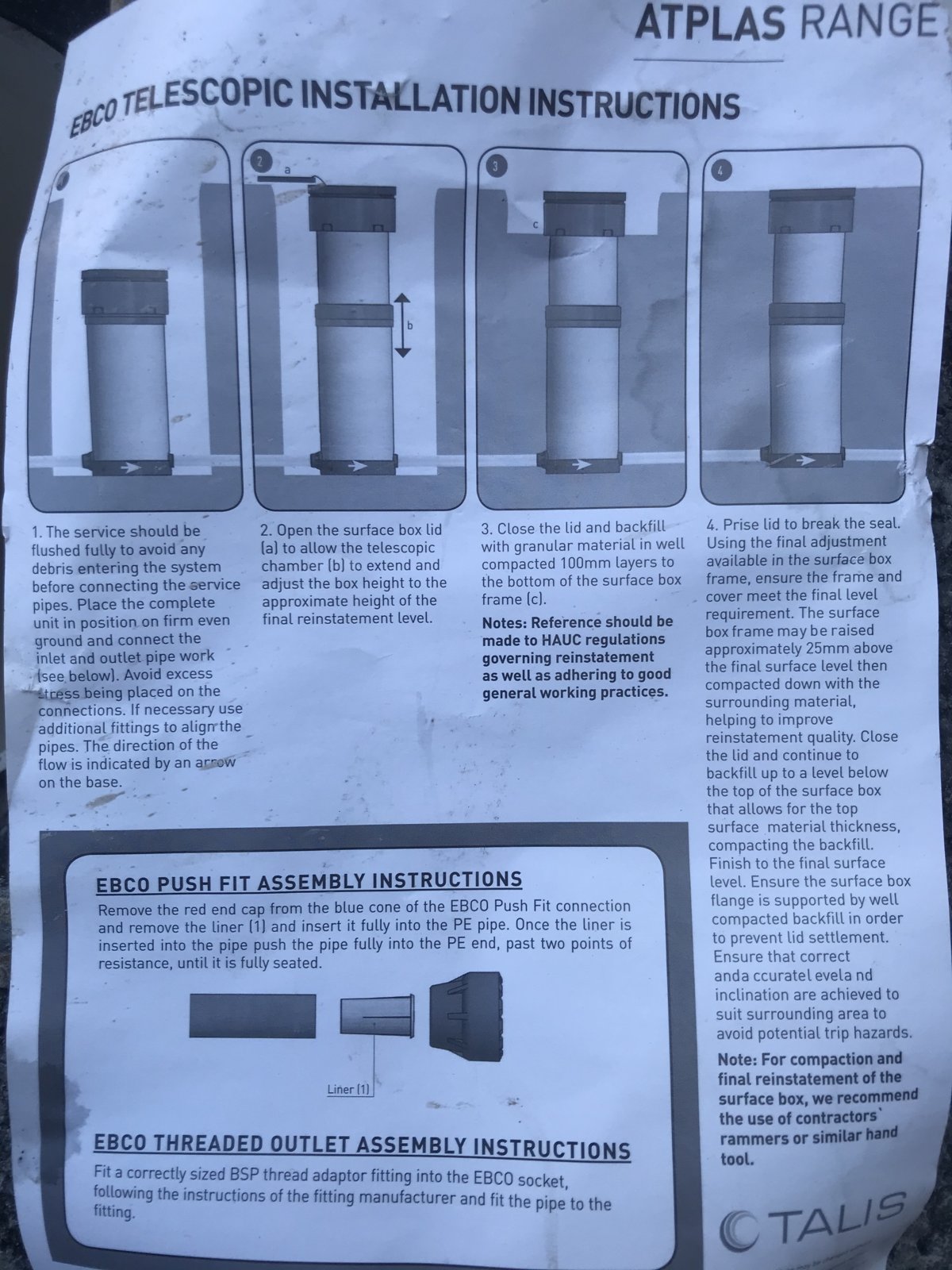

I saw these yesterday and thought of your job:
