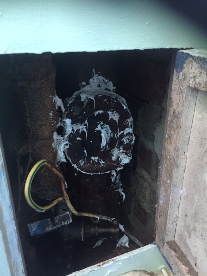

Well I called another local plumbers who had over 700 good reviews on Check-a-trade (I know that's not always the best guide but that's all I have really).
Guy came out 20 minutes later which was lucky. He removed the inspection plate and the actual gasket thing could not be removed as it was essentially welded to the iron - at least that's how he explained it. He said it had been there decades probably, or many many years.
He's put "mastic" around the whole seal area and then put the inspection plate back on. He said that's the easiest solution and really, the ONLY solution other than a BIG job in taking the whole of the boxing in down, and then trying to saw through iron and the fact the pipe is over 3 stories long.
I'm now not allowed to use the shower upstairs or any of the water upstairs until tomorrow morning to give the whole area time to dry.
Fingers crossed

Thought I'd add a picture of the work he done as I've just had a proper look. It looks quite messy but then I guess that's the nature of this glue stuff?

just viewed your picture , and I sincerely hope the repair has made it watertight , if appearance is anything to judge by it won't win any prizes .
Thanks - I'm concerned that most of the stuff he's applied is on the top bit... whereas the leak was coming from the bottom - which I did tell him.
He may have added a generous amount there, it's just harder to see from the picture.
Fingers crossed.
