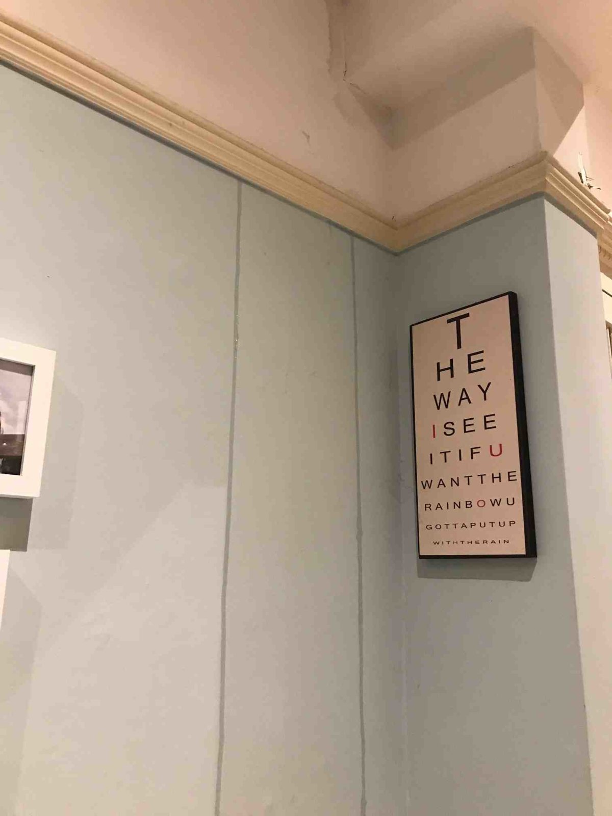

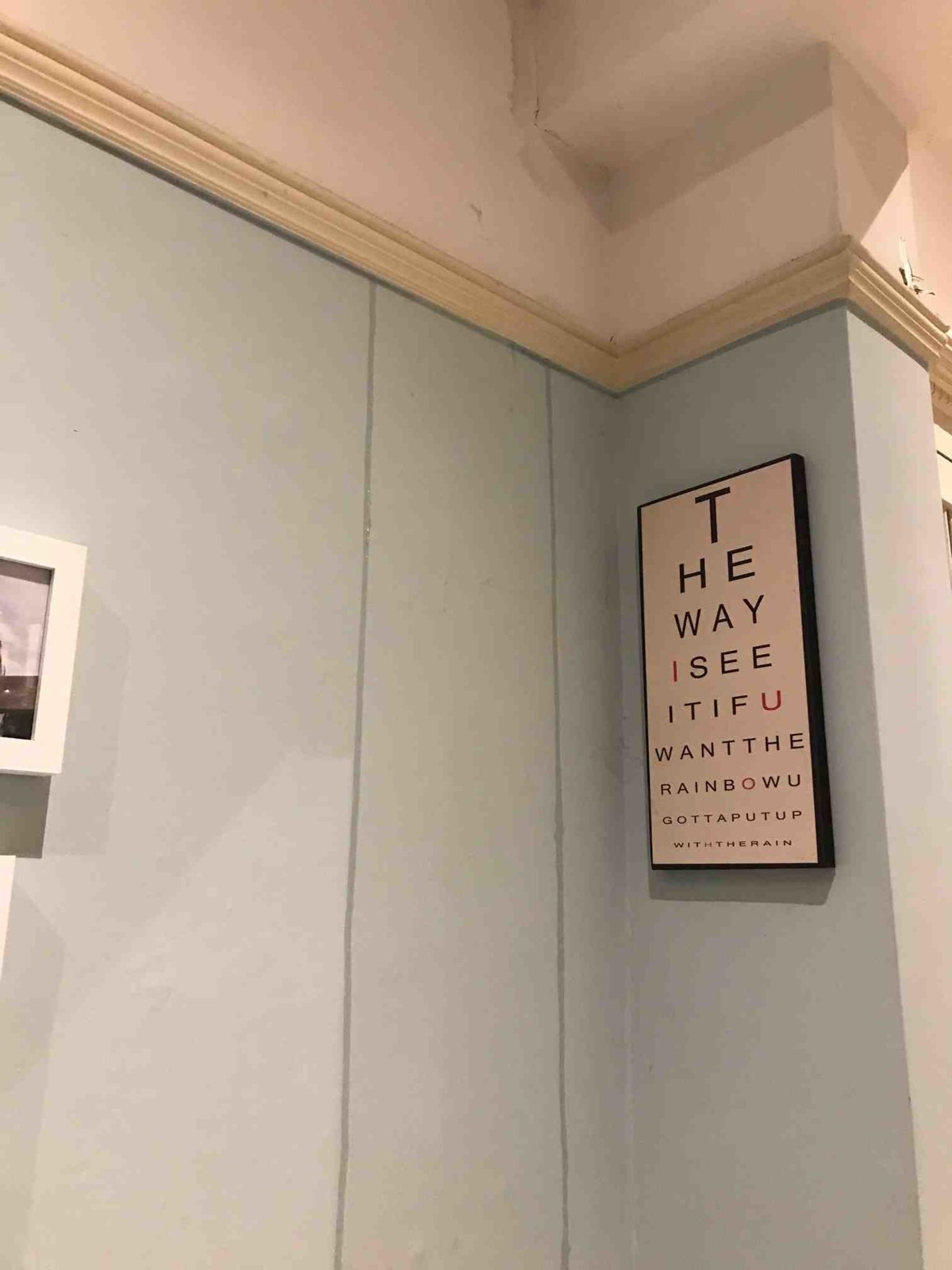

I went up into the loft and checked the header tanks, everything seems dry and I can't see any signs of any leaks. The damp starts at the base of the tank, but there are pipes under the floor too. But the water is working it's way along the wall, see attached...
I'm just worried the tank is going to fail, or the rate of ingress is going to cause real damage??

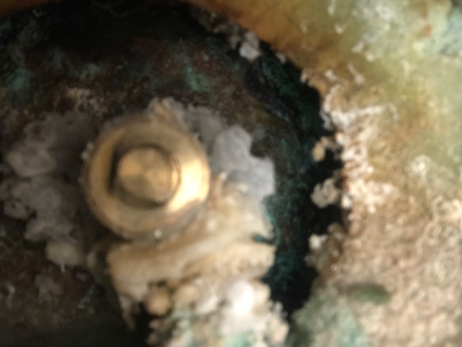

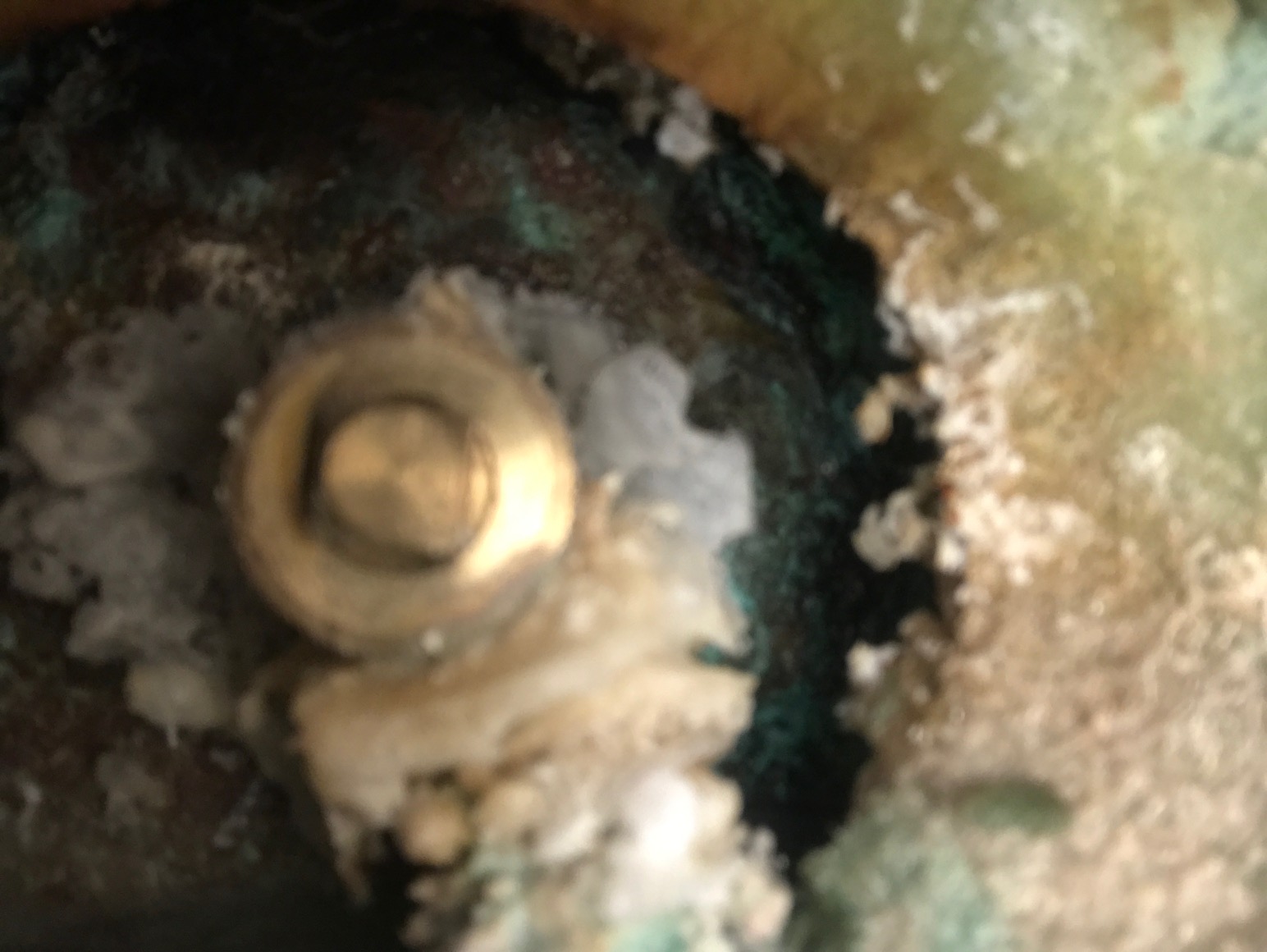

I have located the leak on the HW cylinder, and it is coming from the "secondary return". This is a Hercal 3 1200 x 450 cylinder, and there is a "secondary return" on the rear of the tank at the top above the cold feed. There's some kind of valve on it, a square spindle going into a round knurled body. I can feel the water trickling from this valve. I put a spanner on it and it easily cracked loose, then I was able to tighten it up a good 3/4 to full turn. Didn't overdo it obviously, but can anyone advise what that valve is, and am I safe to tighten it down? Why would it start leaking - although from the calcium build-up, this is not a new leak. I've attached a pic - not great but a b****d to get to.

Okay it seems to have got worse. Basis your "could make it worse" comment I went back up and backed of the square bit a turn, and immediately heard (and saw) water spurting out. So I tightened it back round as tight as I dared to (worried that the tank is corroded and it might just break off). I put some towels under the tank, went downstairs, drilled a small hole in the ceiling which drained out quite a bit of water. I am thinking that will stop any water spreading and ruining more ceiling or wallpaper.
Leak now seems to have stopped. No more water tricking down wall and dripping has stopped. Not sure if it's towels, tightening down that valve, or my imagination. In any case the whole f*** shebang is getting ripped out after NY (if it lasts that long) and re-piped.

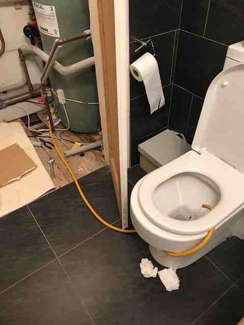

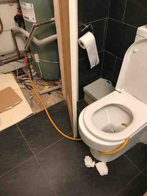

Right... tank drained completely. Hosepipe in boiling water then jammed onto the drain cock. Other end down the bog. See pic for a laugh.
Thanks for the advice JimCrow but I can't face houking about in the loft today, so I just shut off the stop cock from the header tank. Whatever that other feed is, I'll find out. I've switched the HW to permanently off, so CH only. Tomorrow, once my hangover has cleared, I'll get in at that drain cock and see what the score is. God willing it is just a poor fitting that got disturbed when the boiler was changed and the system flushed, but I would be amazed if its that simple. I'll be trying to find a plumber tomorrow anyway as we have the whole family descending on Friday, and I have no HW!!!
