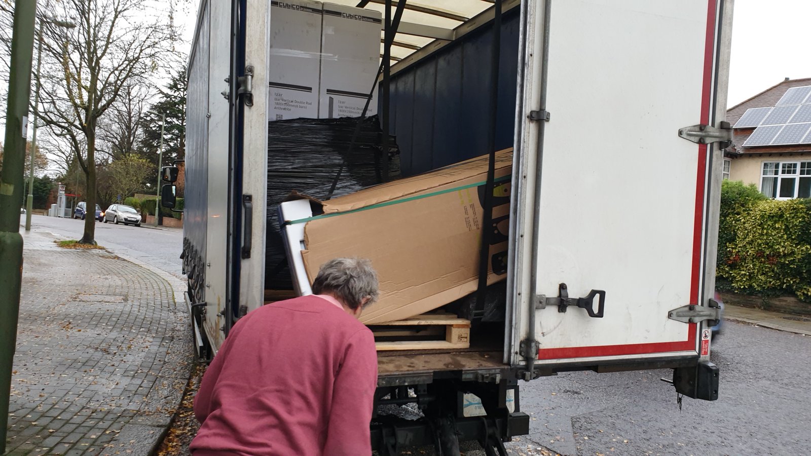

But anyway ... Pallets don't always help:
£700 of cylinder squashing whatever is behind the other door.
That explains the quality of some of your plumbing advise ;) (sorry too easy a jibe :D).
That's the exception that proves the rule! Maybe a hundred pallets would do it strap it in the middle of the pile.
