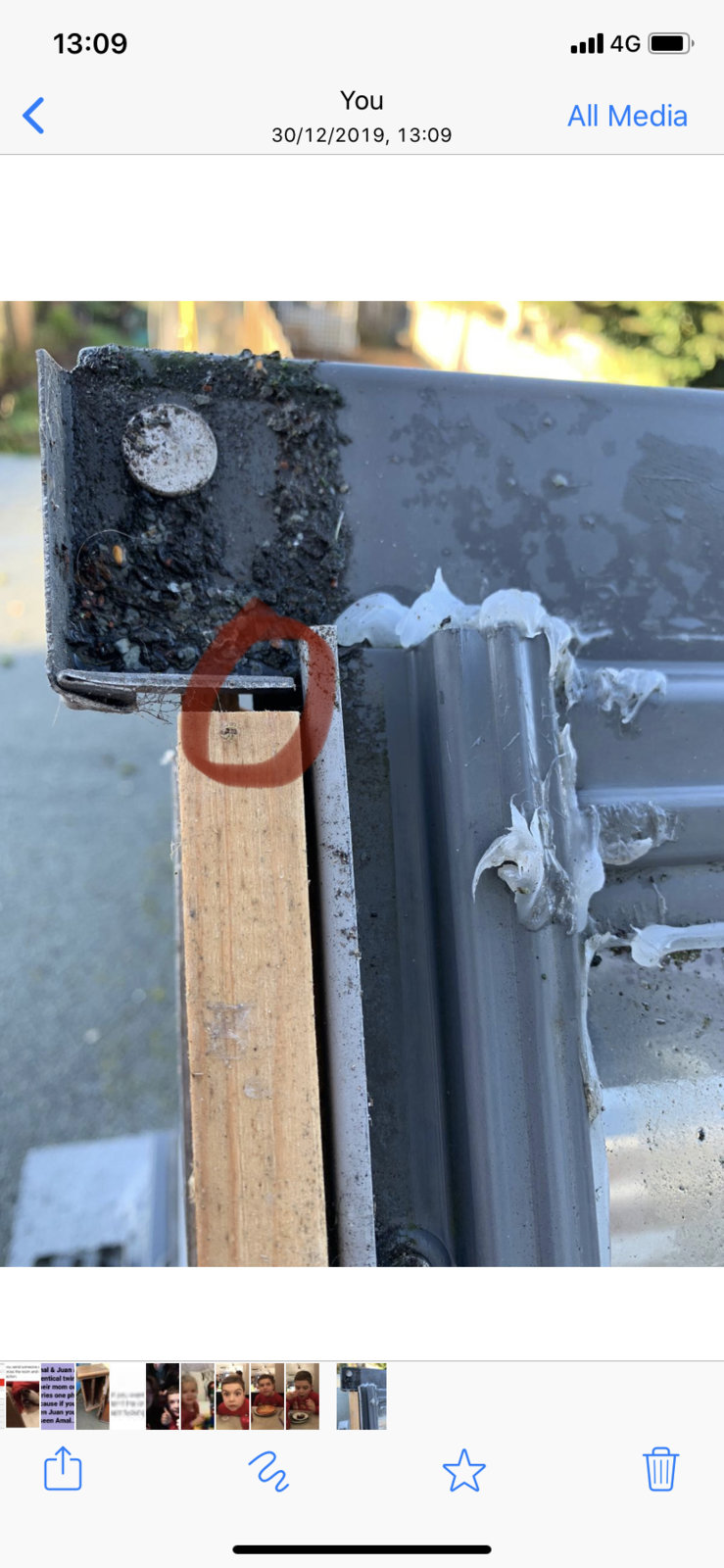

Hi there, I’ve got a similar situation. Posting this so that it hopefully helps.
There’s a gap on the end of the Velux under the flashing and when there is heavy rain and wind then we have a considerable leak. I assume the rain runs down the gully on the side of the glass and then gets blown into this gap under the flashing that runs all the way down to the inside corner of the velux. I cleaned all this up and took all the botched fix silicone off (in the pic - its not where the leak was) and daubed copious amounts of CT-1 in the gap, leaving a channel for the water to run down. It has been bone dry since.

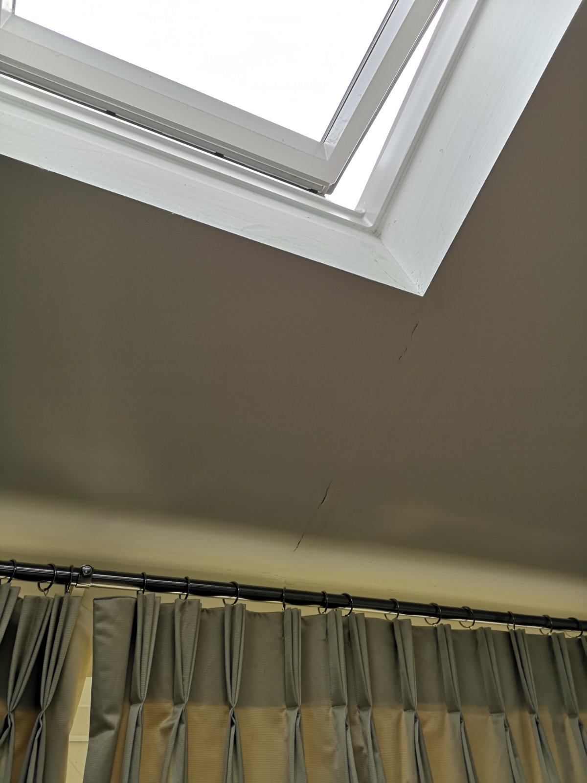

I have a 4 year old centre pivot velux window and has started to rain in .It only happens when it is heavy driving rain .It is leaking in from the bottom left hand corner,When checked further it appears that the left hand side inside framework had water on it,but cannot find how it is getting onto it and making its way down to the bottom corner.

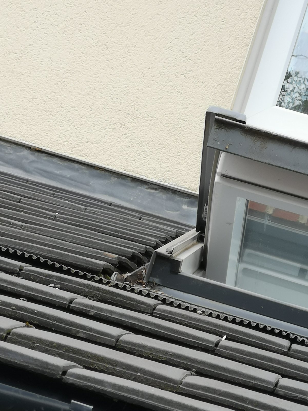

Another discovery which may help some: I though I had everything fixed but another incident occurred recently due to a quite rare combination of events. But let me begin with a few thoughts:- Why do yer ordinary "vertical" DG windows never leak? - 1. They are vertical, 2. The installers bung a thick bead of sealant all the way round and 3. When closed the frames are pressed tightly against the rubber seals. If you still have some old style wooden windows as I had in one house many years ago, you will know that if such a window faces west and there is a gale combined with heavy rain, sometimes some rain will get in. THAT IS THE ISSUE which some of us are facing here so "pouring jugs of water down" never finds a leak. So back to my "discovery":- Last week the rare combination of events was a south-easterly gale and heavy rain which again caused a leak - the roof we are talking about faces south-east BTW and has four veluxes but only one was leaking. So I ask myself what is different about that particular window vs the others? I stared at it from above but cannot see anything obvious so give the local velux man a call who promises to come and look next week... Next day it's dry and so I am outside and decide to look upwards to that roof and veluxes for no particular reason. Suddenly it's obvious! It ain't the veluxes at all, it's a couple of the surrounding tiles which are not laying completely flat as they should be but have gaps of 3 - 5 mm beneath them such that the rain/wind combination from a particular direction can blow water up through said gaps. It doesn't happen most of the time because the wind is usually from the west or south-west and therefore at the wrong angle to blow water ito those gaps. Velux man agrees, gets up there and bungs a bit of sealant in said gaps. The moral of the story is of course that veluxes are not "vertical with sealant all round" and that's why they won't gurantee no leaks as one gets closer to the horizontal, i.e., below 15 degrees. Also if you have a velux installed try to ensure that your installer has done a velux course where they explain necessary attention to detail of these kind of things.
