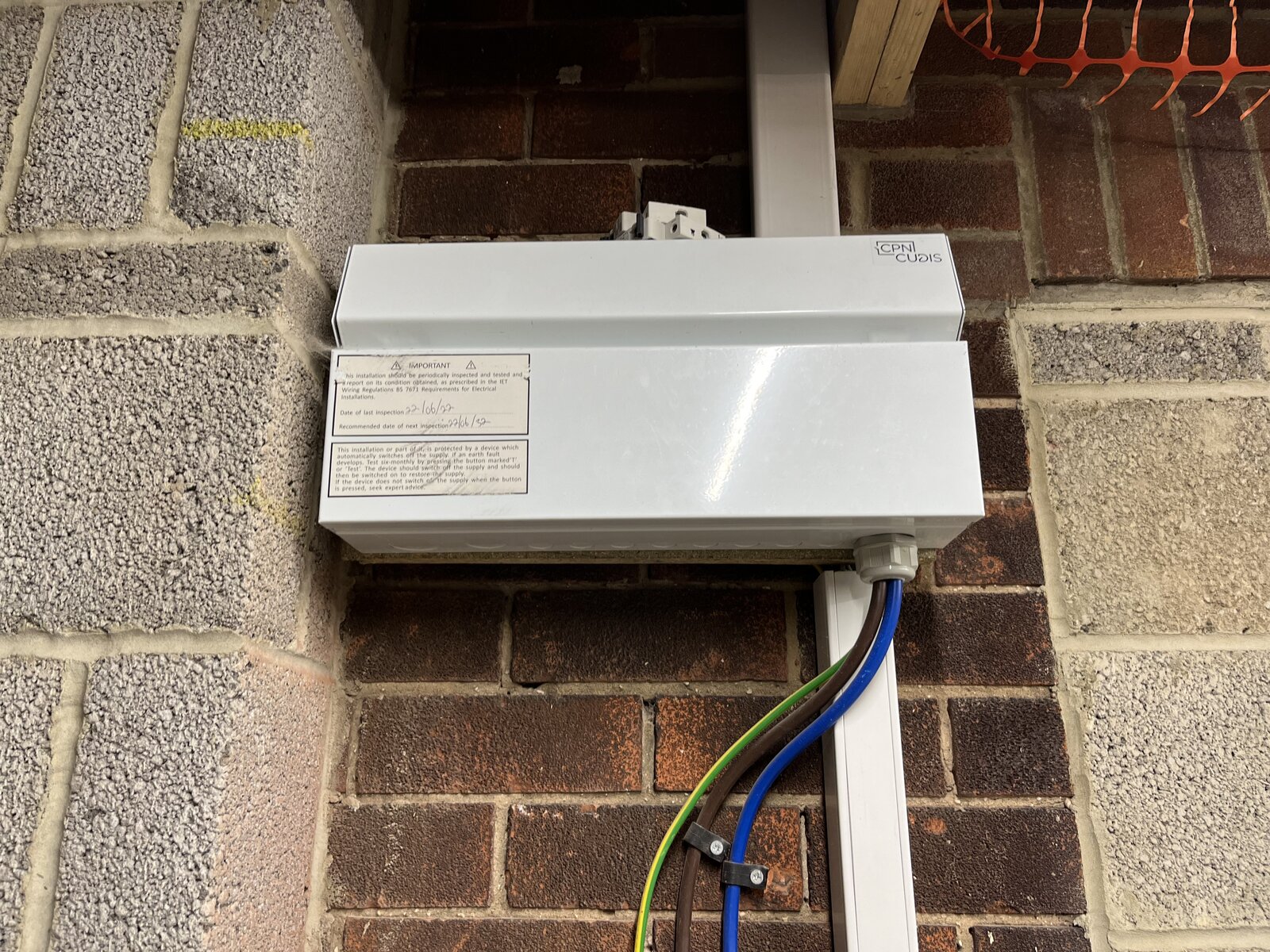

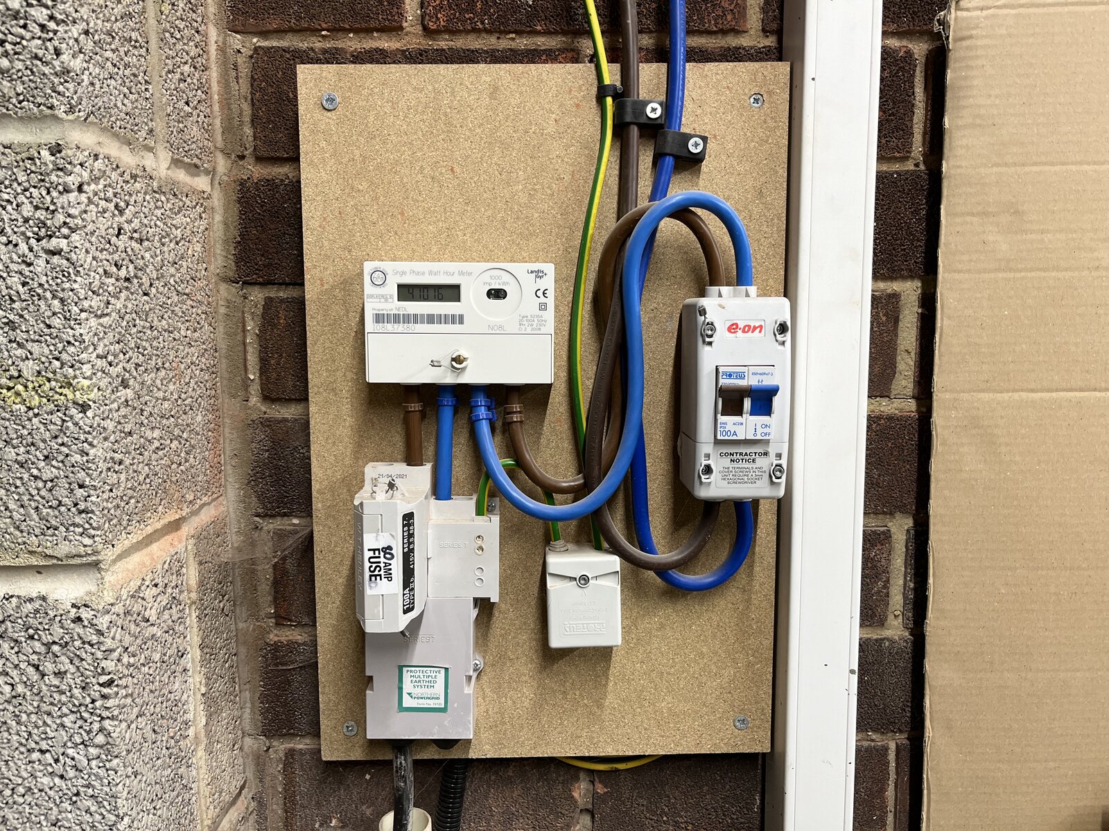

In simple terms the "Earth" in the consumer unit ( Fuse box ) is often connected to the incoming Neutral in the supply cable. The Neutral should be at the same potential as the Ground but in reality it can be several volts different from Ground potential.
That is rediculous and suggests your "electrician" lacks the basic knowledge necessary to work on electrics. You need a electrician to check the installation for safety of people in the house.
He did explain it, I think the earth bonding comes in with the main electrical wires from outside the house on the electricity board side of things. It’s all modern cabling. Way above my head, but he’s a qualified electrician.
Just to clear up the earth thing, here’s a couple of pics of my mains elec in to the fuse board. It is earthed, but from the incoming mains. There’s no physical earthing rod in use.

I appreciate that reply, but it is well beyond my comprehension :unsure:
There is no physical earthing strip to my MCB, the electrician said it’s not needed, and the only electrical connection to the copper would be through the Worcester oil fired combi boiler.
