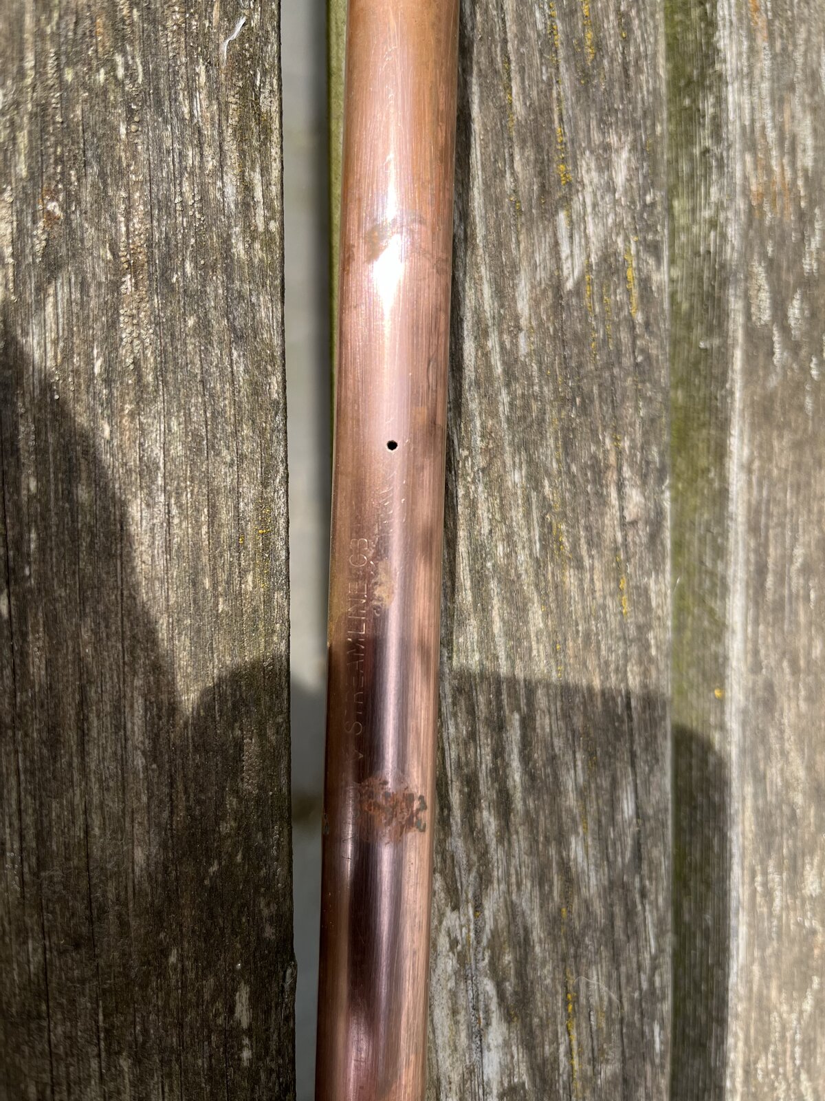

Leaks in copper pipe…..
Wow….this is a new one on me on a perfectly straight length :oops:
I can’t cut it open to show you, as it’s getting sent off to Wednesbury for them to examine. However, looking inside the pipe, there are little “lumps” in it.

I’ve been working with copper pipe as a DIY’er for 23 years, and the new stuff is sh!te compared to the old stuff. You can physically see the wall is thinner :(

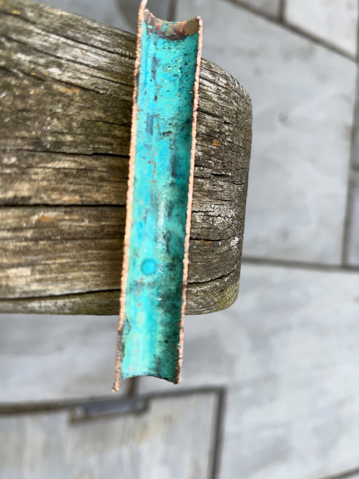

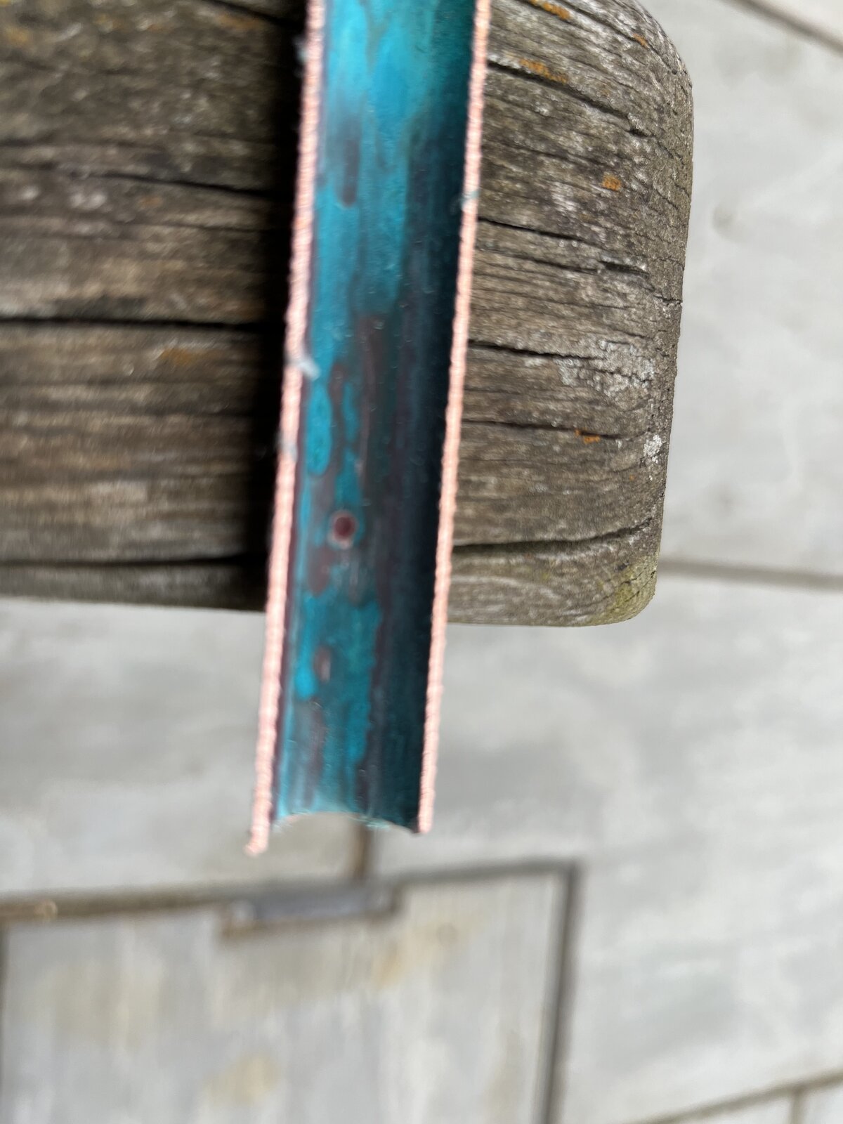

Here’s a couple of pics of the same pipe a bit further along and cut open. You can see the “lump”, and when cleaned off there’s a pinhole all the way through :cry:

Copper pipe corrosion ,internally, forms the series of small lumps that you see inside the pipe. This is commonly known as "pitting". The exact cause of pitting is largely unknown,although many theories exist ,which include (to name just a few), water quality and the chemicals present in potable water with varying pH levels, residual flux left in pipework, electrolytic charges present, poor quality copper tube with high levels of carbon content. Much research has been done on the issue , particularly in America, (where in certain areas the problem is rife ,and pin hole leaks appearing within months of installation ). Unfortunately ,to the best of my knowledge,no single factor has been identified as the root cause.

I’ve sent a sample off to Wednesbury, see what they make of it. But after only two years after installation ?? I just don’t get it ??
And with more of the same copper upstairs, in both the heating and hot / cold water systems, it’s only a matter of time before that goes too. An expensive ticking time bomb :cry:.
I work mostly in a area where the water is described as aggressively hard .
See pinholes in copper fairly regularly properties with water softeners seem to get way less.
Copper cylinders don't last long either we now use stainless steel replacement cylinders.
