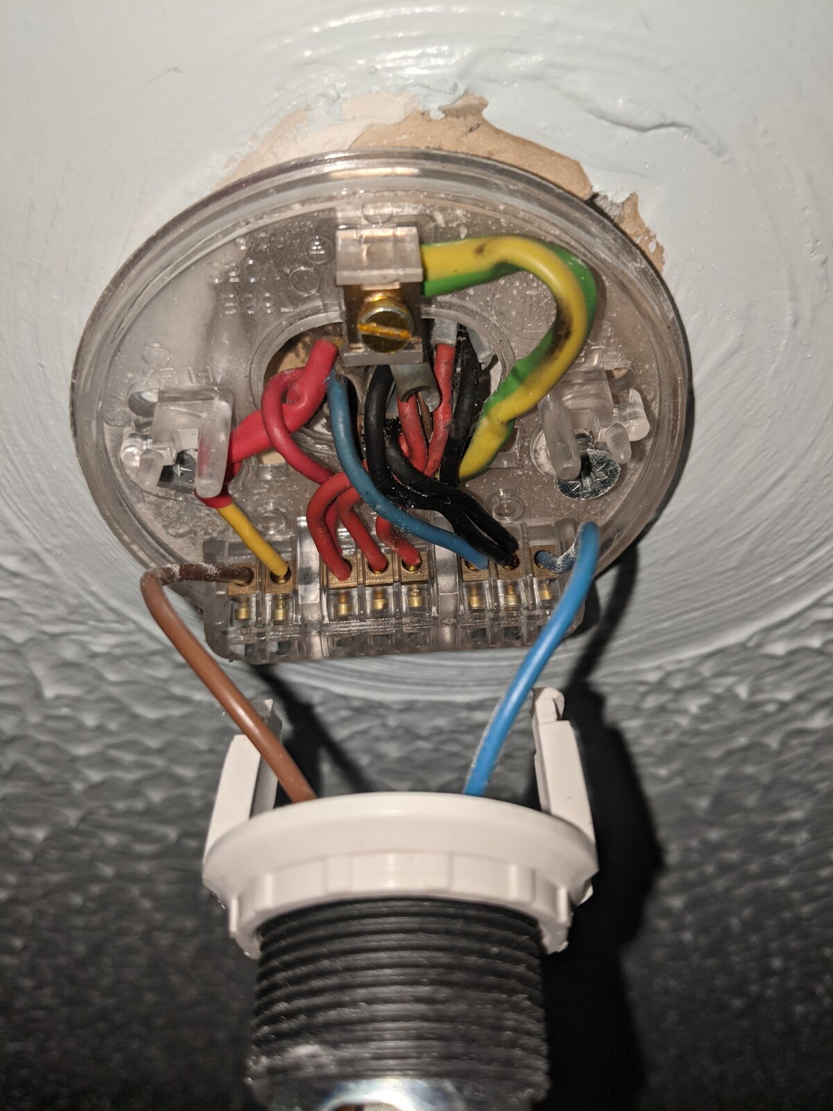

Hi. Just wondering if anyone can please help with regards to fitting an LED bathroom light. I've attached a photo of the existing light fitting and wiring as well as photos of the new LED light. I'm very much a beginner with regards to electrics and the fact there's so many wires in the existing fitting and the new one seems to only be able to accommodate 3 is throwing me off completely. Please can anyone advise the correct way to wire this LED light using the existing wiring?

You will need to accommodate some cable connectors ,such as wago's within the base of the light fitting. Is there space to do it ?
The terminal block on the fitting looks as though it doesn't have enough ports to acommodate all the conductors ,and needs a seperate connector block for All the loop permanent lives.

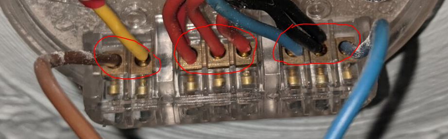

The Reds are the Lives - what we call the Lines - one from the supply, one to the switch and the rest to other circuits. These must all be connected together but to nothing else.
The Blacks and Blue are the Neutrals - one Black is the supply and the rest to other circuits. The Blue (not the one to the light) would appear to go to the switch for some purpose which is not usual. The Neutral for your light
The Yellow is the Switched Live back from the switch. The Live for your light when switched on.
The Earth wires out of my snip are from all the cables and must be connected together. The Earth for your light.
I would suggest you put each group in a connector block with separate wires to the light L, N & E.

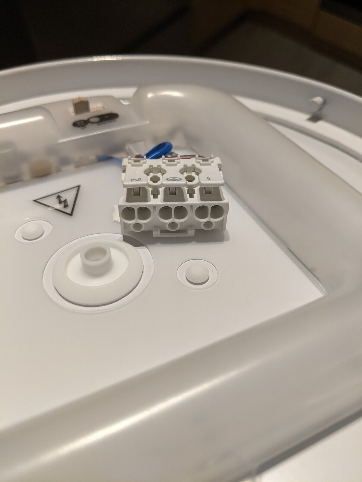

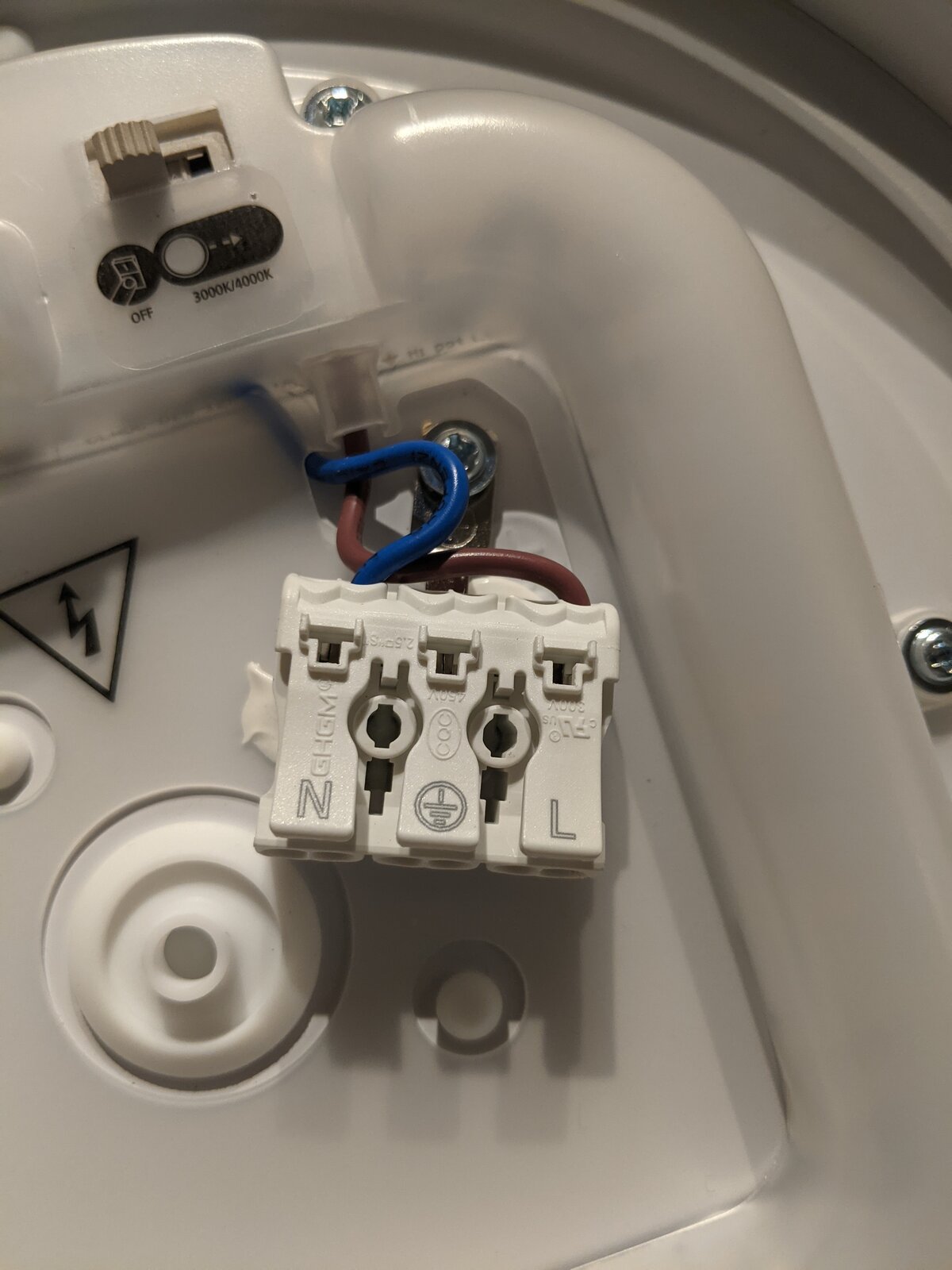

Thanks for the replies, very helpful. I was just wondering on the photo of the connector on the LED light you'll notice there's three holes for each of the live, neutral and earth. Can I insert a wire in each of these instead of using connector blocks before running a single wire to each of them on the connector?
Also for the earth is that just a case if unscrewing the green and yellow earth wire and wiring that straight into the earth on the connector on the LED light?
Regarding having space for connectors there isn't space above the fitting but potentially is space in the fitting around where the connector is, the only issue with that is fitting all the wires through the hole in the base of the LED light, which isn't very large.
Don't follow you regarding space in the fitting for extra connector blocks/hole in the fitting. More pics of the entire fitting may clarify ?
Although the terminal block of fitting has 3 ports ,you have more than 3 wires to fit into the neutral and earth terminals. 4 of each in fact.

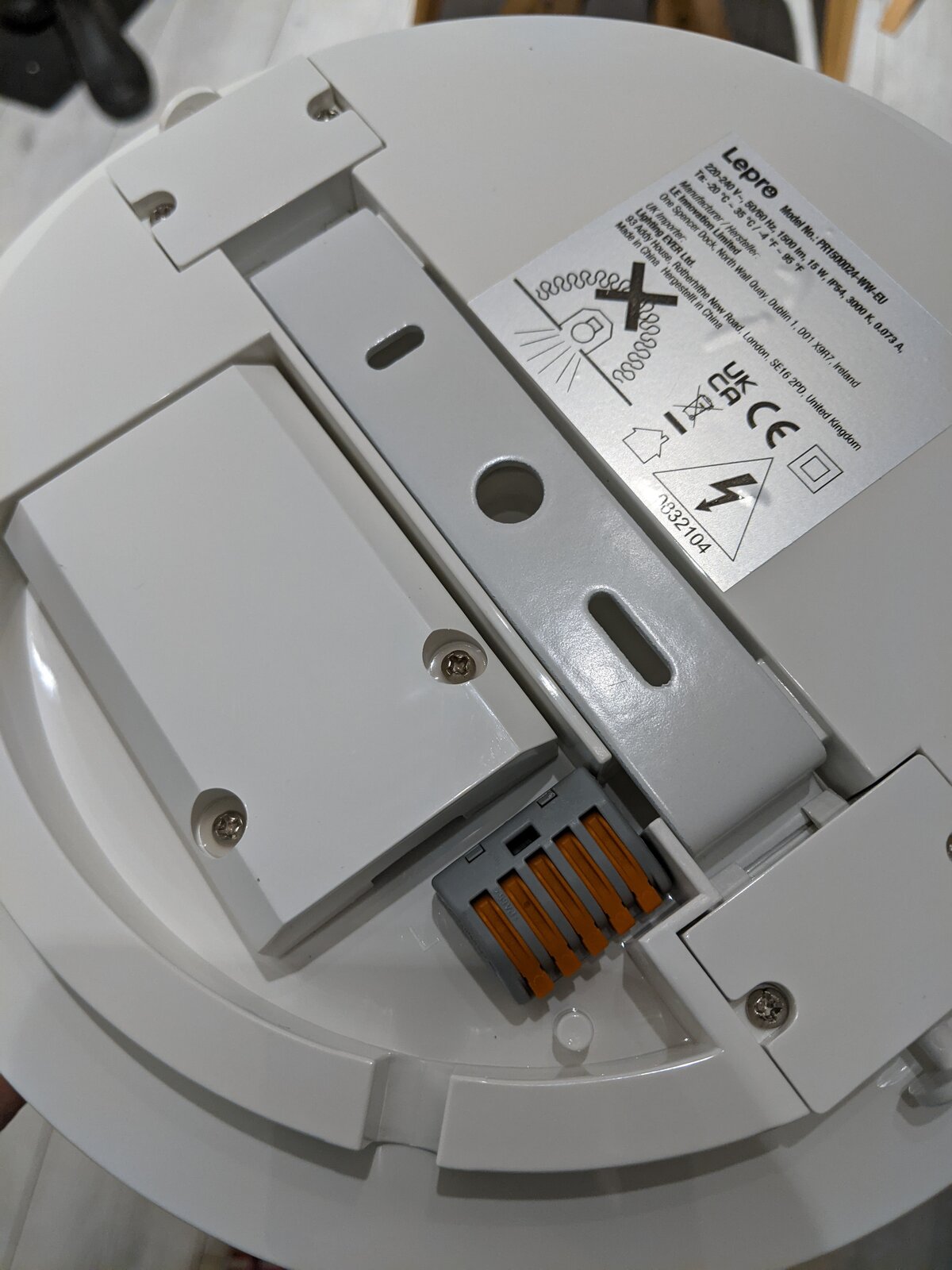

I don't think it's easily accessible from my loft unfortunately because I have a gravity fed water system with a big tank above my bathroom so any junction box would need to be pushed through the ceiling. It would be great if I didn't need to use a junction box mind so that's ok as long as I can house the connectors in the light fitting and it's plastic right?
Yes ,you can use 5 way wagos for upto 5 conductors. And the junction box can be pushed up into the loft from below. Without sight of the space within the fitting ,who knows if there is enough space ,or if it's suitable to make all connections there. Time will tell.
