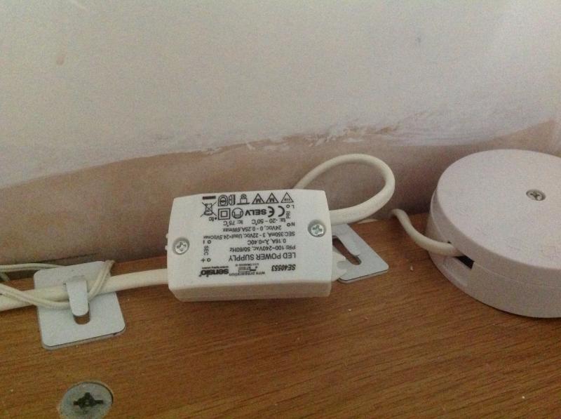

Hello,
I have 2 LED Drivers on top of my kitchen cupboards which serve some under cabinet LEDs. There are no over cabinet lights but I'd like to add some LED strips on top of the cupboards.
The drivers are labelled 24V and 6W. Each one has a total of 2.4W already from the under lights.
I would like to add 4m of LED strips. Is it possible to do this using those drivers? I can't find anything appropriate, would I be better off leaving as is and adding new drivers for the LED strips from the nearby junction boxes?
Thanks.
Don't know.
Do your LED strips need a 24V supply?
Is there enough capacity left in your existing drivers to accommodate the new load?
I haven't bought them yet but 12V seems a lot more common than 24V.
It's less than 4W remaining capacity on each driver and LED Strips seem to be about 4W per metre so its not panning out.
I'll just start over with a new kit that includes drivers. The JBs are accessible and since they run from a FCU I guess I can safely just add to them.
