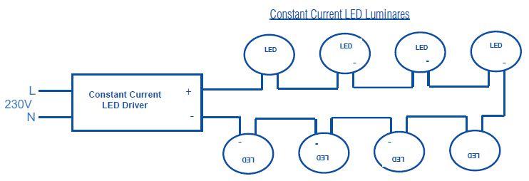

Are you 100% certain that the LED lamps and the drivers match.
There are two methods of driving LED lamps. Constant voltage and constant current. And both need the driver to be using the same method.
In a constant currrent set up the lamps are connected in series and the driver sets the current through them.
In a constant voltage set up the lamps are connected in parallel and the driver sets the voltage applied to them.
Putting a constant voltage driver to a constant current lamp could destroy the lamp as the lamp requires the driver to control the current that flows through the lamp.
EDIT ; flame port beat me to it. the number of lamps is limited by the maximum voltage the driver can make before the current control fails to operate properly as each lamp has a voltage Vd across it If there are 10 lamps then the drivers maximum possible output voltage must be greater than 10 times Vd.
I asked for drivers specifically for these lamps... Was thinking I could hopefully double-up (i.e. two LEDs per driver) as the drivers are a tenner each, but I was told that each LED needed it's own eaglerise thingy. With regard to constant current/constant volts, its probably me getting my words muddled.
We also tested a LED (to see how bright it wasn't) by wiring the LED via the driver to some flex with a 3a fuse in the plug. Worked fine but not very bright, hence we need 8 of the little sods in a 2.5m x 1.5m room!
Using the daisy-chained 240 supply I should be OK on this occasion, but the single driver for next time seems to make a lot more sense (and it's cheaper!)
