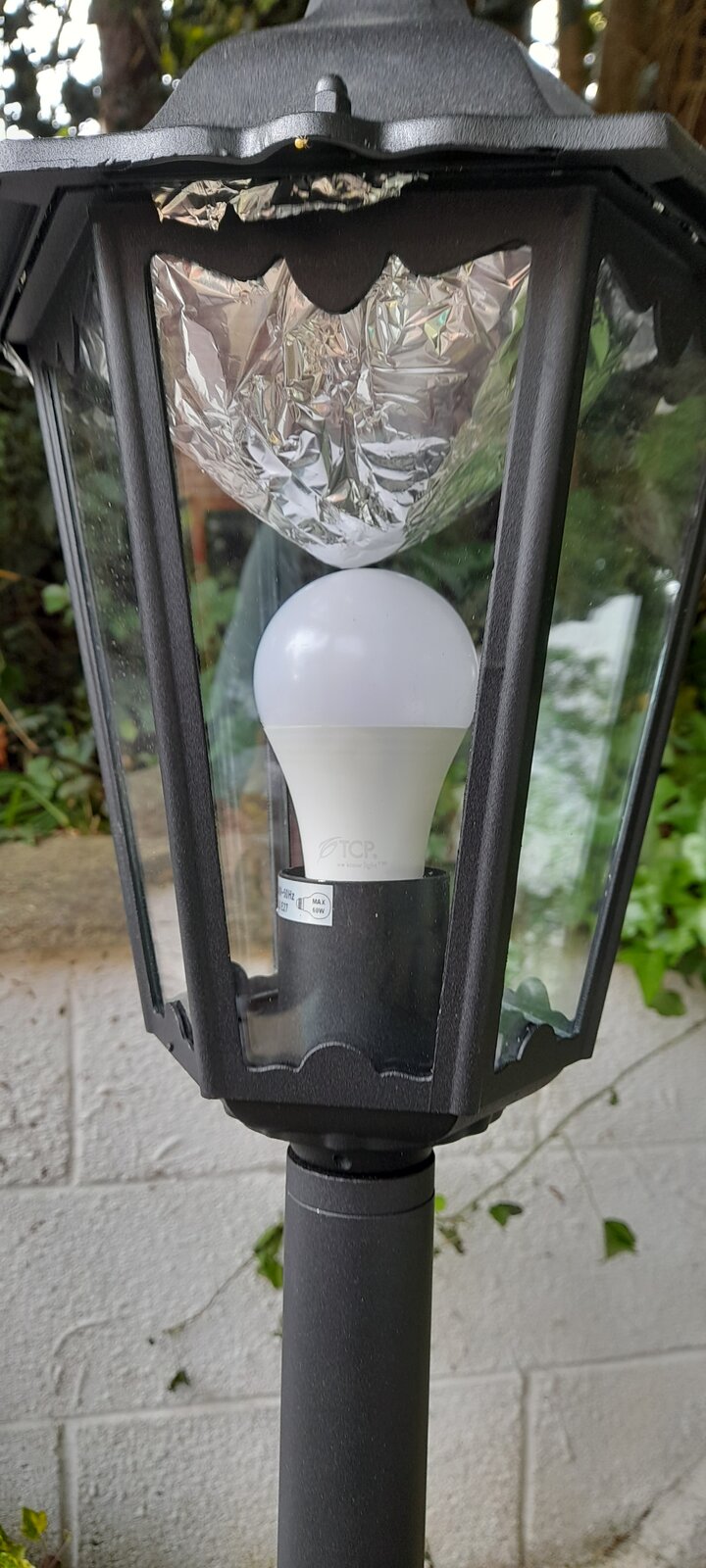

I have currently installed 6 garden LED lights all wired to an outdoor junction box, below is an image of one of them:

The issue I am having is they are way too bright, end up lighting all my neighbours gardens. I have bought a dimmer switch but this does not work as the lights end up flickering at low dim setting.
I even bought this device from Amazon:
Font Line Circle Electronic device Art
Still no luck, the buttons on the remote do not do anything apart from changing the colour from White to Warm and vice versa....
please if anyone has any experience with LED's what would be the components I need to make this dimmable? The LED lights themselves are dimmable and seems to be an LED strip wrapped around.
Thanks.
The driver for the LED lamp will have a capacitor to smooth out the output, the driver may be built into the lamp, or external, but all LED's need a driver as they are current controlled, and our supply is voltage controlled. Getting any external control to dim LED's it needs to talk to the driver and tell it what to do. Some dimmer units work better than others, but since the smoothing capacitor has to be on the DC supply, most of it is down to the lamps used.

Ok so I bought these off Temu, I know not exactly the place to buy electrical items. I was actually impressed with the quality, they were solid bits of kit, within the wiring it had a 2 red and black wires fed into a small hub and two cable out the other end (N | L ) I assume the hub is the capacitor as the seller said it allows AC voltage input 85v to 265v. I wish I took a picture of them but I already fixed to the posts and did a silicone sealant around the edge.
Anyway I think I ericmark may have just answered it, it sounds like if I'm not mistaken, I need an LED driver that converts AC to DC 24v then wire a Dimmer in between the AC to DC driver and the lighting wiring?.....
Those were not designed to be used outside. You should probably stop using them.
I have done referred to LED lights being converted to DC first
So stop all this stiff about converting to DC. Its an AC powered device. It will work on an AC supply 85v to 265v,
Go buy a good mains LED dimmer, Like the Varilight Pro and it should work if the units are TRULY dimmerable.
But in any case, I agree with DetLef
Or Time to use the returns feature!
