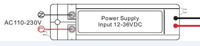

Have I been misunderstanding the meaning of the word "Input" for umpteen decades? :)
