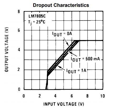

My thoughts are to simply fit a LM7812 chip in each lamp and accept when battery is not on charge they run a bit dim.
However there must be people who have come across this problem before, so question is how have others got around the problem?
That won't work - with the input less than 14V, there will be no output at all.
Indeed. I suppose that an appropriate resistor and a 12V zener would do what eric was intending - but that would be a pretty inefficient system.

I have found over the years not all 7812 chips are the same. It was a common trick to put a red LED between Com on chip and negative line so it would give 13.2 volts. However it did not work with all chips.
I know the bulbs linked to are expensive but they seem to be the answer. Can't see point in adding resistors, zenors or chips when one can simply buy a bulb with it all built in.
I think that works with virtually all 78xx regulators. Indeed, it's conceptually the way in which one uses them to give variable voltage regulation. Let's face it, the chip merely regulates the voltage between it's output and COM. If you raise COM to above 'zero', that will raise the output voltage relative to your zero reference.
However, flameport's point was that all 78xx regulators have a 'dropout' voltage of about 2V. In other words, if the input voltage is not at least 2V greater than the regulated output voltage (i.e. about 14V in the case of a 7812), the the output voltage/current falls to zero - so quite useless for your application. Raising the potential of COM to above that of the negative supply line (with an LED or whatever) would merely make that even worse (i.e. you would need even more than 14V input to get any output).
This doesn't match my recollection of my experience with this device. I believe that there will just be a slow reduction in output voltage with a fairly fixed voltage drop (rather like Eric was suggesting).
I think I would have to see evidence to the contrary before I stopped believing that.
The Input-output differential from the Fairchild data sheet does seem to show below 2 volt above regulated voltage the output voltage will be about 2 volt below input voltage which for 11.5 volt would mean around the 9.5 volt mark it would stop damage to the LED.
This doesn't match my recollection of my experience with this device. I believe that there will just be a slow reduction in output voltage with a fairly fixed voltage drop (rather like Eric was suggesting). ... I think I would have to see evidence to the contrary before I stopped believing that.
Maybe my (and flameport's) recollections are wrong. I have to say that I've probably never had any reason to use a 78xx or 79xx in situations other than those in which the input voltage has not always been appreciably above the output voltage, so I can't pretend to have any 'experience' of eric's situation - although I certainly thought that the behaviour of these devices was as I described. When I have some spare minutes, I'll "do the experiment"!
I have to say that I'm somewhat struggling to understand how you draw that conclusion from the graph above (although what you say may still be true!) - but, as I just wrote to Detlef, I'll try to do the experiment later!

... The Input-output differential from the Fairchild data sheet does seem to show below 2 volt above regulated voltage the output voltage will be about 2 volt below input voltage
I don't actually need to do the experiment, since the Texas datasheet has already done it for me (for a 7805) ...
... so, it seems that eric and Detlef are essentially right, and myself and flameport wrong! Sorry about that - but it goes to show that one learns something every day! All I can say in my 'defence' is the fact that, as I recently wrote, in 'normal usage' one would never usually contemplate a situation in which input voltage was not appreciably greater than the regulated output voltage - so it's probably not a situation I've ever actually seen!
Kind Regards, John
Ah - thanks! At least my memory isn't playing me up.
You're welcome, and again my apologies for perpetuating confusion!
Surprisingly, it took me quite a while to find a relevant graph, or even data. It seems as if most datasheets for these ubiquitous devices (like the Fairchild one eric quoted from) do not contain any information at all about what happens at input voltages below the regulated output voltage (perhaps because that it outside of the scope of 'intended use') - so I suspect your memory may possibly relate to actual 'experience', rather than what you'd seen in datasheets.
