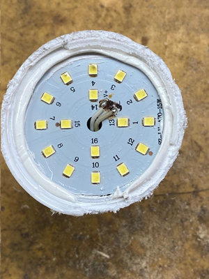

Diffusers or pearl glass can help to spread the light, but the LED often has a flat plate inside so be it a GU10, candle, or golf ball bulb the inside is the same, a flat plate with surface mounted components designed to remove the heat from the LED chips.
Agreed. The GU10s do, of course, usually (always?) have a reflector and 'lens', rather than an 'envelope', are never 'pearl' and clearly are NOT designed or intended to radiate light 'in all directions', even if incandescent.

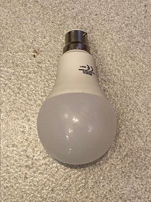

However, in terms of candle, golf ball and 'GLS-style'etc. LEDs, I agree that the internal construction is essentially the same, with all the LED elements mounted on a flat plate. However, as I illustrated last night, when there is a pearl envelope, it seems to get pretty evenly illuminated. I presume that's either because the light emission from the LED elements has a wider beam angle one might expect and/or that the 'pearl' envelope is designed so that light 'bounces around inside it. These pics show the outside and inside of one like I illustrated last night:

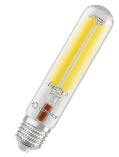

The main problem is that it is not as simple as changing a bulb, to get a large LED bulb one needs an E40 screw base, the E27 and BA22d bases do not seem to have LED bulbs made for them. I suppose I could have used one of these 1700129539913.png at 40 watt it would have lit my living room well, but the E40 base is a problem, so went for a chandelier which has 8 x 6 watt so actually slightly more wattage, problem is the chandelier is a bit too low, I miss it, but some visitors don't. At least it does move so no real damage.

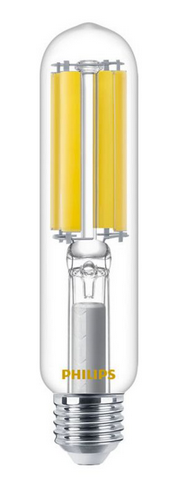

It is clear from the bulb show that bulbs could be made with the same spread of light to those they replaced, this 1700131195396.png bulb clearly does shine in nearly the same spread as the tungsten it replaced, but not pearl, so it has a tendency to cause glare. It says "Equal to 75w GLS lamp" and rated 8 watt, and "Compatible with existing fixtures and designed for retrofit replacement of incandescent lamps, LED Filament lamps deliver huge energy savings, minimizing maintenance cost." however failed to find any lumen output listed, so clearly just for decoration not really designed to light the room or the lumen would be listed. advert here found other adverts where they say around 800 lumen, and prices vary from £2.50 to £10 in fact this one 1700131980474.pngPhilips listed as £27.74, 17 watt, 3000 lumen and E27 base, it says it replaces a 50 watt bulb, so assume replaces some discharge bulb?
