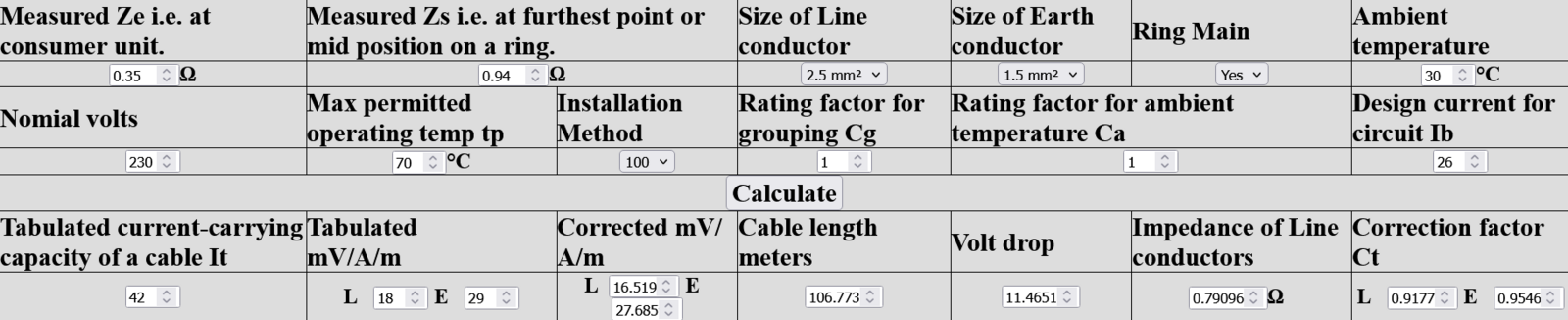

Many years ago I wrote an excel sheet to work it out, the problem is the mV/A/m needs correcting, so ring final comes out something like
My problem was it was so complex, it was simply too easy to make an error. So only way was to make a program so I could not miss read my slide rule.
As to leakage I have see it said 30% is the limit for back ground limit, so 9 mA, but until last year no way to measure it, got my new clamp on. Diffrence line neutral 8 Feb 24 reduced.jpg So yes I can measure it, but as to the capacitive and inductive leakage per meter of twin and earth, never seen any figures, I suspect something like 300 Ω ribbon cable, I remember doing it for my RAE and degree, but could not remember how it was done now.
