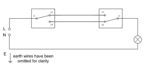

My money is on the COM terminal missing a live feed from the other gang of the switch. A common mistake is people missing to put a link between COM 1 and COM 2.

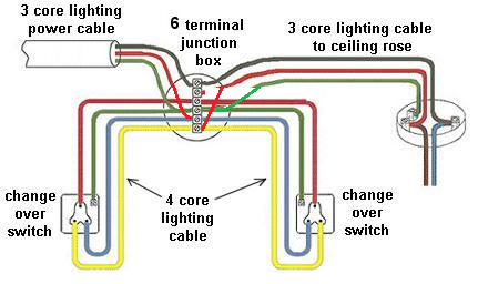

I'm going for a circuit arrangement like...
Yes agreed, this version often pops up too using a 4 terminal junction box with the earths joined together using a terminal block, either inside the juntion box or around the outside.

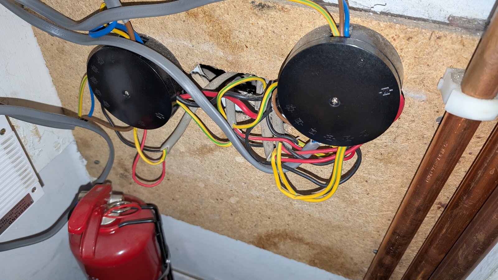

Unfortunately I can't get into the ceiling void at the moment. I would need to cut a hole in the plasterboard in the ceiling. Could it be as simple as a lose wire in the junction box? I think the previous owners were keen DIYers but nothing seems to have been done too great.

The cable in the second switch goes down the way. I'm guessing to these in the cupboard where the fuse box is.

I still don't see a cable with red, yellow and blue wires in your last photo.

Yes agreed, this version often pops up too using a 4 terminal junction box with the earths joined together using a terminal block, either inside the juntion box or around the outside.View attachment 362524
Yeah, lost count over the decades how many junction boxes I've seen where all the CPCs come back out to a terminal block, or even worse, they're just twisted together...
Would it be possible to confirm...
Yes there is red, yellow and blue in the 2nd socket
