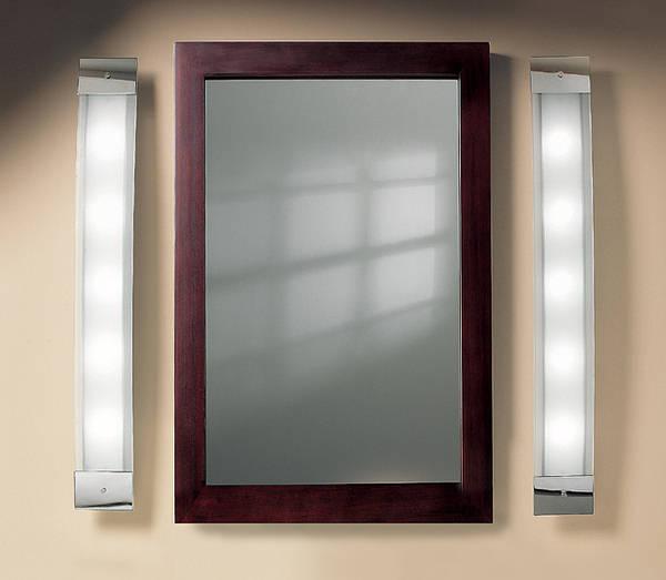

Hi,
Anyone any creative lighting ideas (LEDs ? ) for existing large rectangular mirror (720mm wide x 1240mm high) over bathroom sink ?
Do not want to use these

Unless it's purely for decorative reasons, the lights would be better at the side of, and at the same level as your face. The idea is that they illuminate your face which is reflected in the mirror. Overhead lights will leave your face in shadow.
For good reason the old stage make up mirrors had a row of light bulbs down either side.
Today, modern versions are available, many suitable for use in a bathroom
It is important that they are correctly installed and suitable for the appropriate electrical zone in which they are located.
That's a good point, but looking at the OP's original picture it looks like the sink would push anyone standing in front of the mirror back by ~2ft so downlights in the ceiling, 6-8" away from the wall (assuming that's compliant!) would have a similar effect without being as prominent as wall-mounted lights.
