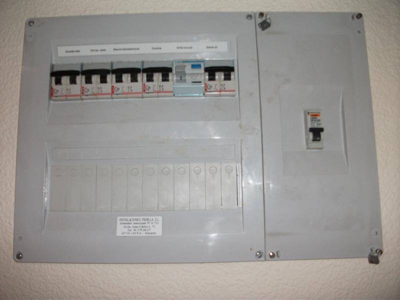

Spain use MCBs in a sealed enclosure so you can reset but not get to terminals.
The device I've seen is fitted in caravans with heating to kill the heating in sections while socket loading is high.

This is the consumer unit in my neighbours place in Spain. The MCB on the right is in a sealed box and is a C20 or 25, can't quite remember. There is no meter. You have to turn off A/C to cook the dinner etc.
