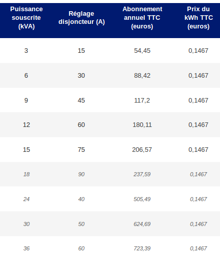

I was always led to believe that at least in the past, EDF really did have problems with heavy loads due to its infrastructure, hence the tariff structure to try and discourage people from making higher demands during peak load times. I just found the current rates for the base tariff:
https://particulier.edf.fr/fr/accue...ervices/les-offres-d-energie/electricite.html

I was always led to believe that at least in the past, EDF really did have problems with heavy loads due to its infrastructure, hence the tariff structure to try and discourage people from making higher demands during peak load times. I just found the current rates for the base tariff: ...
Fair enough. However, AFAIAA, that situation has existed for decades. If they had wanted to grow their business and hence increase profits, one would have expected them to have invested in improving the infrastructure - so that, just like almost every other company who sells things, they could then have spent their time encouraging, rather than discouraging, customers to buy more of their product! Is EDF entirely state-owned? If there were 'public shareholders', I might have expected them to moan about policies designed to restrict the sales, hence profits! ... and I'd say the same about PG&E!

They charge the same per kWh for everyone, and higher prices for higher capacity.
I think that is a very good solution, and much better than "investing" in extra infrastructure, with all the environmental damage that entails, in order to build an infrastructure that might not be needed.
I think one would have to look very hard to find other large businesses that produced major disincentives to buy more of their product - it's a bit like "buy one, get a second for twice the price"!
They don't and it isn't.
It's a charge to have access to a share of their infrastructure. Look at the rate per kW of that charge.
How keen are people (and, more to the point, institutions) to be become shareholders in a company which is deliberately restricting/discouraging growth and profitability (even if that is forced upon them by regulation)??
Encouraging people to use more and more electricity and gas is utter madness.
They charge the same per kWh for everyone, and higher prices for higher capacity. .... It's a charge to have access to a share of their infrastructure. Look at the rate per kW of that charge.
From the consumer's point of view, that's little more than a 'paper exercise'. What matters to them is the overall effective cost per kWh (taking standing charge into account). For a French consumer using 6,400 kWh per year (allegedly the average French domestic consumption - see here ) that effective cost per kWh (for all their electricity) would rise from 0.1552 euros if they only wanted a peak supply of 3kW/15A to 0.1838 euros if they wanted a peak supply of 18kW/90A (comparable with the 'usual' UK domestic supply). This price structure is arguably particularly unfortunate ('unfair'?) for a consumer with very modest total electricity requirements, but occasional short-term high loads (e.g. a shower?).
I dare say there are probably provisions for preventing this being exploited, but the EDF figures posted suggest that it would actually be cheaper in France to have multiple "3kW" supplies than to have one 9, 12 or 15 kW supply!
