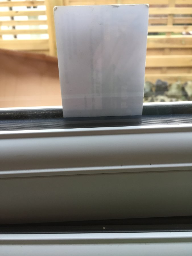

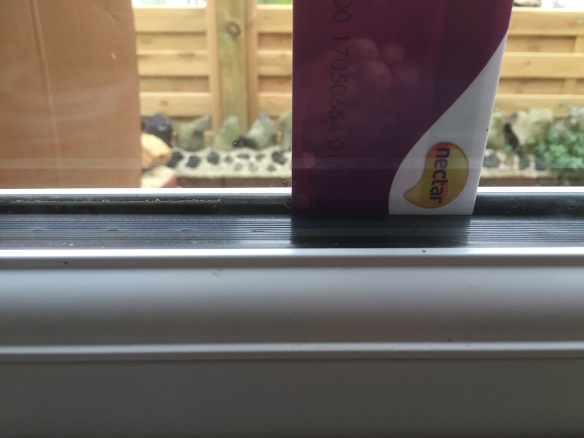

Also I did a test on all my windows and noticed that you can easily slide a business card down between gasket and glass unit from the outside but not inside, is that to be expected?

Does the business card go all the way down? There is a bubble seal and at the base a harder lip. The card should stop at the lip. The bubble is softer. If the card goes all the way down then it sounds to me as though the window is forward enough to press on the seal. You report the back is tight so why is the front lose? Is the frame bowed? That is the glass unit is tight to the corners but the frame bows out making it lose in the middle? Maybe try a long steel rule on the frame (and the glass unit).
It appears liniar use 28mm double or 36mm triple, triple glazing bead part number being LSW042 so is very unlikely this is your problem, a 28mm unit in a 36mm gap would be totally obvious
Paper business card and Nectar card both push in relatively easy even near the corners, I tried on a friends windows and couldn't even get it in with reasonable force
