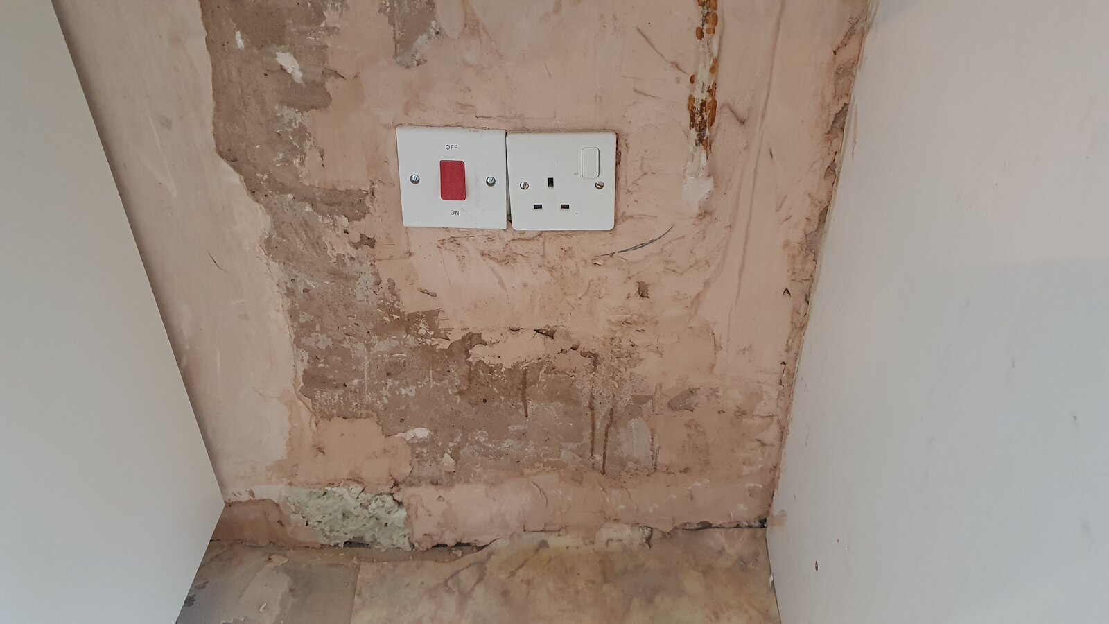

See attached image. This socket is for a gas hob that will be in the kitchen unit (with drawers) that goes in front of here. The switch next to it is an isolator for a spur off the ring circuit, the cable for which runs up the wall for an extractor hood.
The switch and socket could remain here if I cut a hole in the thin back of the Ikea unit that's going there, so could be accessed by pulling out a drawer.
My question is, is this acceptable or should they be relocated to somewhere more accessible, ie above the worktop?

It's our house. Access to this will be rare as the hob only needs power to create a spark and the extractor has its own power switch of course.
I'm installing the kitchen myself and had a spark rewire it a couple of months back. I think he found it very tricky due to the 1950s post-war bomb-proof walls!
Totally common and standard. The only sticky bit is that hidden socket shouldn't really be used as a safe zone indicator (for buried cables)- if all the cables are buried below worktop height then less of an issue.
Well worth marking hob, extractor inconspicuously (but where anyone working on them will look- inside the filter area on the extract, under the hob where cable entry is) and the drawer in question.
Do you intend to the wire the gas ignition into that big switch on the left, or are you thinking of replacing it for a plug and socket, or a fused connection unit?
I’d just write on the cupboard backing, socket and fan iso behind here
You probably don’t want a hole behind your draw
You could mark out a cut out area
