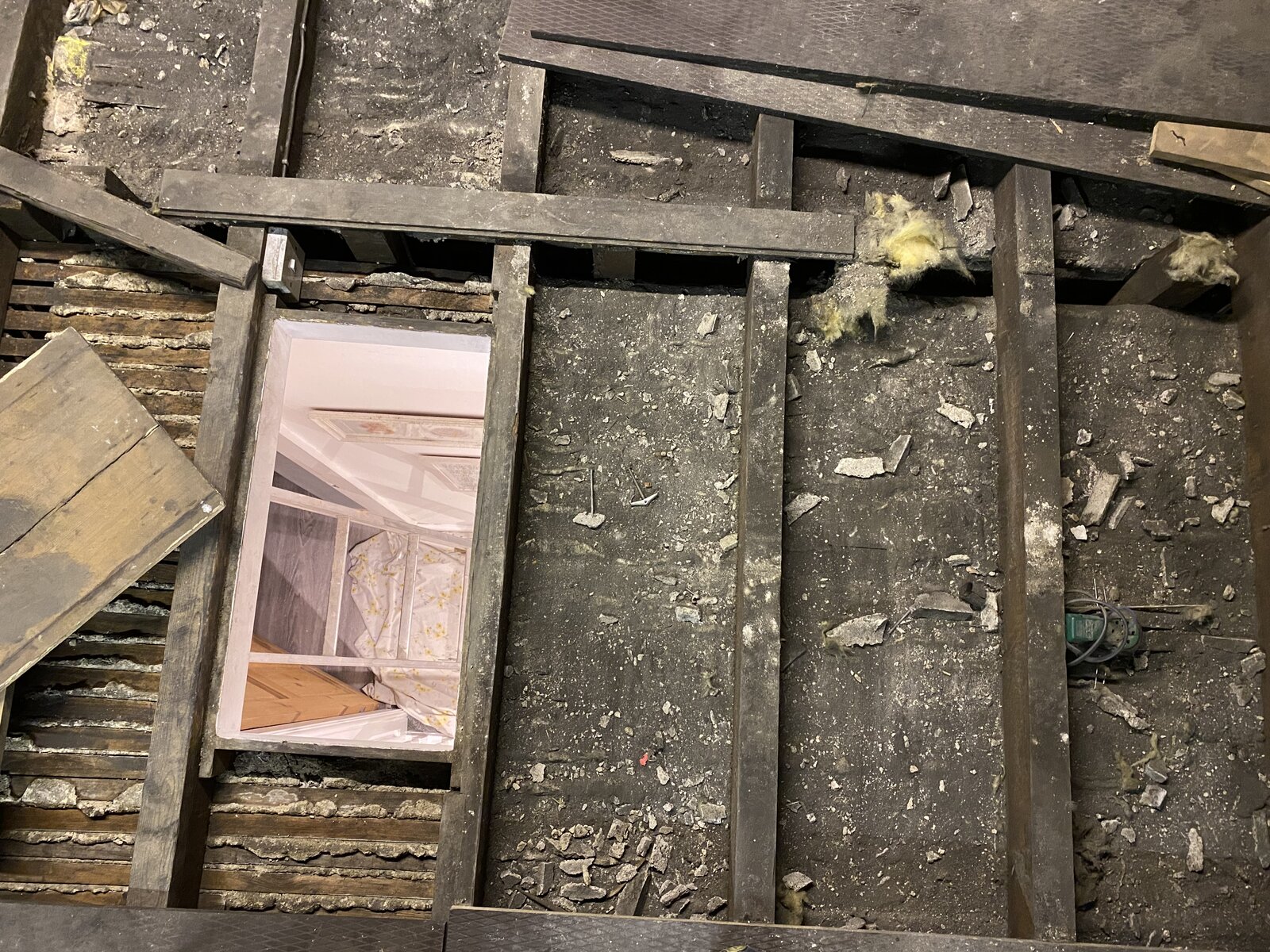

I’m edging closer to cutting out for the new hatch
Here is the hatch from above now the loft has been cleared a bit!
As you look at the pic, the new hatch will run from Left to Right, so I’ll effectively be cutting the joist in the middle
My question for today:
1. Do I do the hole cutout (for new hatch) from the ceiling below or from up in the loft? Or does it make no difference?
2. Before cutting the joists to accommodate new hatch I am running a 4x2 from L to R across the joists, screwed is (as per advice above)
As you can see, there is a stud wall that comes up into loft (just above loft hatch on pix, directly next to white plastic light switch)
Is it ok to brace the joists ABOVE (on pic) th switch- ie. On the opposite side to the peace of timber that runs across joists?
Or is it essential to brace/support the joists as close to the cut as possible?
I'd cut from above so gravity helps rather than hinders. Generally you cut anything so that the cutting direction of the saw blades means they come into contact with the finished face (the thing you look at) first, because when saw teeth emerge from a material they make more of a mess than when they go into it..
..but in this case you'll be putting some decorating trim round the edge of the hole so it doesn't matter if it ends up a bit ragged
Portable power saws like circ saws, recip and jig saws generally cut upwards towards the body of the tool for reasons of stability. If you're using a power saw it would be best to be inside the loft then you're not having to fight gravity to hold it against the ceiling. If you're using a hand saw it'd be beater to cut from below (pushing the teeth up into the finished face) but harder work than being above the work pushing down
Personally I would only use a power saw on this if it was a variable speed recip saw on low speed; the dust generated by aggressive sawing is nasty. Hand saw with a helper holding a running vacuum cleaner pipe end near the moving blade as it emerges from the clean side of the ceiling would be my route

6 inches isn't going to make a different to where you screw the piece of wood
Cheers
I was going to use a multi tool, would this be ok do you think? I am on my own so was going to use one hand multi tool and one hand hoover
you need straight and square timbers to connect to a buzzy toy will only go to around 32mm before you hit the double thick welded bit
the vibration will find anything loose and on lath and plaster and that can be large sections
would be awkward but a baton both sides clamped or screwed on to give you a guide to cut too
Old hand saw and a dust sheet beneath on the floor. Quieter, less mess

Would you cut from inside the loft then? Just drill a hole to start?
Would a multi tool not cut a fine line so it should avoid damaging nearby bits?
