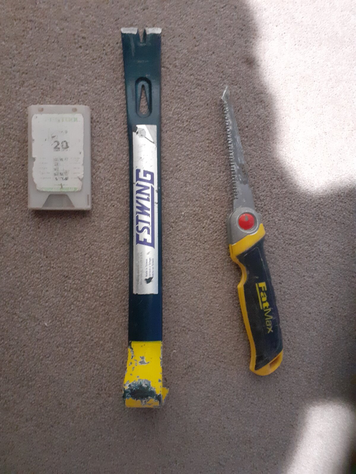

You can actually score a line through the plasterboard with the tip of the saw. If you are goIng to do a lot of plasterboard cutting a jab saw or drywall saw makes a lot of sense (see photo). These can start a cut by just plunging or jabbing them straight through the plasterboard. By twisting them as you plunge into the board you can drill holes for wiring as well

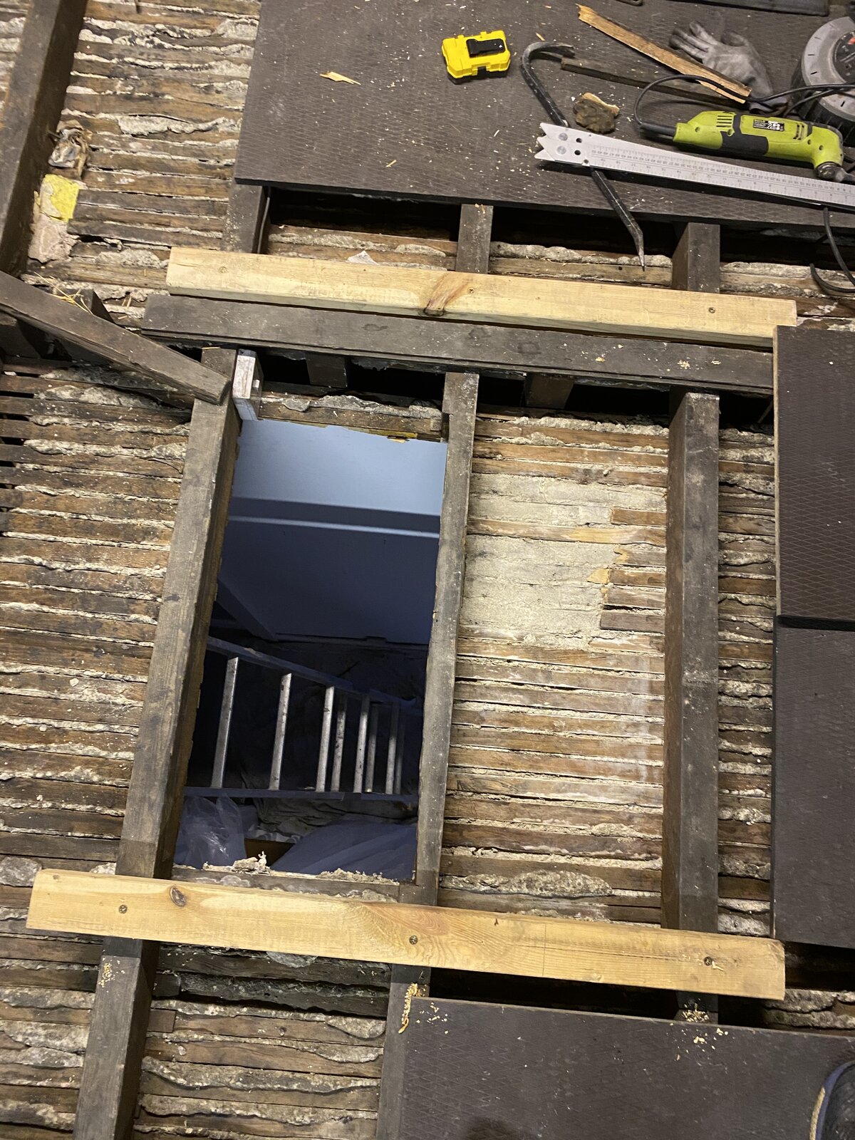

Just a quick question before I do this new hatch opening this week
Would you use the existing joist as an edge of the new cutout or is it best practice to use all new timbers (ie - laminate with a new timber of same size to use as edge of hatch? Cheers
i've read conflicting advice:
should i do the ceiling cutout before cutting the joists and installing support timbers from in the loft
or should i install the support timbers before cutting the opening in the ceiling?
What ever else you do you will need to get the temporary support in before cutting anything. That's the whole point of having them. After that the sequence isn't so important, but you will find that it is difficult to cut the ceiling joists without also cutting the ceiling plaster board, and vice versa to a degree. Either way the opening in the plasterboard will be a tad rough once done, but as you'll presumably be putting an architrave around it, that should hide it nicely.

just checking my support timber is positioned correctly?

You need to mark top or bottom, depending on which side you intend cutting from - cutting from above is much easier than cutting from below, plus much easier to see what you are cutting from above. Therefore - ensure the joists you plan to cut are well-supported, solid support from below is much more effective than from above. Something like a piece of floor to ceiling timber, with a piece of timber sat on top, like a T, will make a firm support.
Excellent idea, but try not to over push as in slight upward pressure rather than rammed in where the timbers are "over pushed" so when you cut the timbers they may close up and snag the blade
but also pin the timbers in the"T" together with pins/screws or nails and possibly up into the ceiling to stop vibration causing the "T" to fall out and let the ceiling bounce
