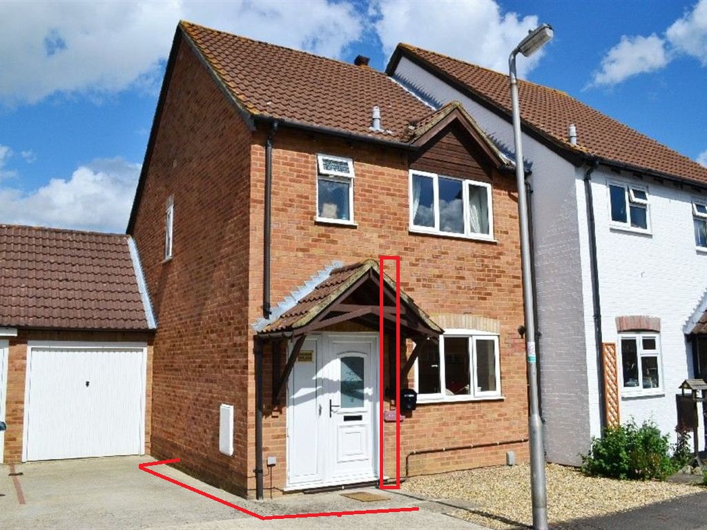

Hi all
I'm currently in the early planing stages to fit an under stairs toilet (outside wall on left side of house is stairs) and after speaking to building regs my initial thoughts of laying an underground pipe on the left into the sewer may be problematic as it is a shared sewer and will need to involve the local water company and using a drop inside the manhole could be a problem.
The manhole is also quite deep at around 3.5 meters. The existing soil stack for the upstairs bathroom comes down inside the house behind some wooded boxing as shown on the diagram as a red box to the right of the front door the problem being I do not know how far down the pipe goes down under the house before it bends to go into the sewer (would it bend at manhole level or likely come out from the house first and then bend down), as I thought about connecting directly into the existing soil pipe to alleviate the shared sewer concerns.
Can anyone recommend ideas that I may not have thought of, it needs to be fully compliant with building regs etc as I plan on selling the property afterwards.
Open up the stack box, connect new toilet to stack, job done.
Cheers Johnny - how do you get to the stack box without digging up the floors inside the house to connect into it. I was thinking it would be easier to connect outside but worried the pipe would be laid 3.5 meters down as well. It would have to run through the hallway and into the kitchen to get to the box inside.
Apologies if that isn't what you meant by 'stack box'

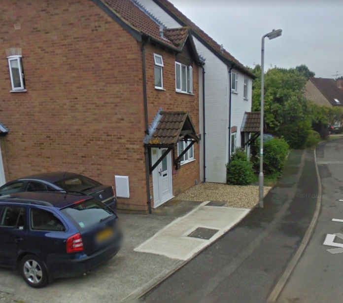

No ladder inside its rectangular around 2.5 feet wide sort of large paving slab size, you can see on the photo where the left side red line ends is the top of it in front of the front door.
Is there a possibility of digging down say 2 feet in front of the house then under the house to the down pipe and connect in that way ?

Another angle showing the next drain in line and how far out from the house it comes.
Your stack may not join directly to the drain in the manhole. May be worth looking at drainage map to check where your drains run.

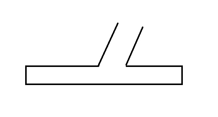

Bottom of manhole is flowing like this with the top pipe pointing directly towards the stack
