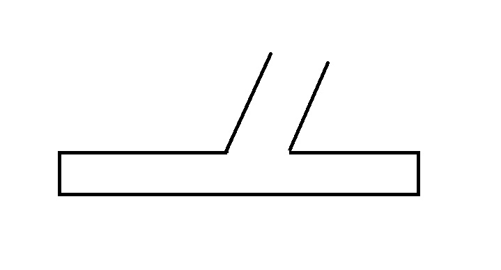

No, it just means that where it bends round to go to manhole, you could change the bend for a y piece and join on, just might save on the extra digging.

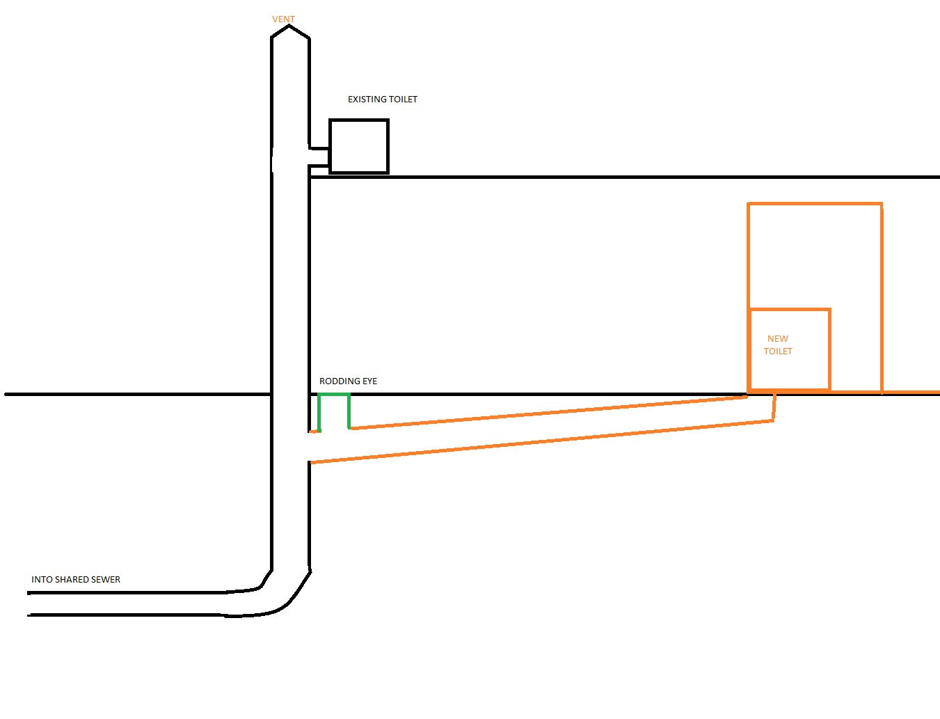

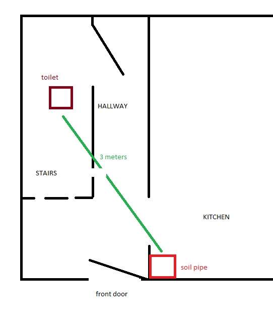

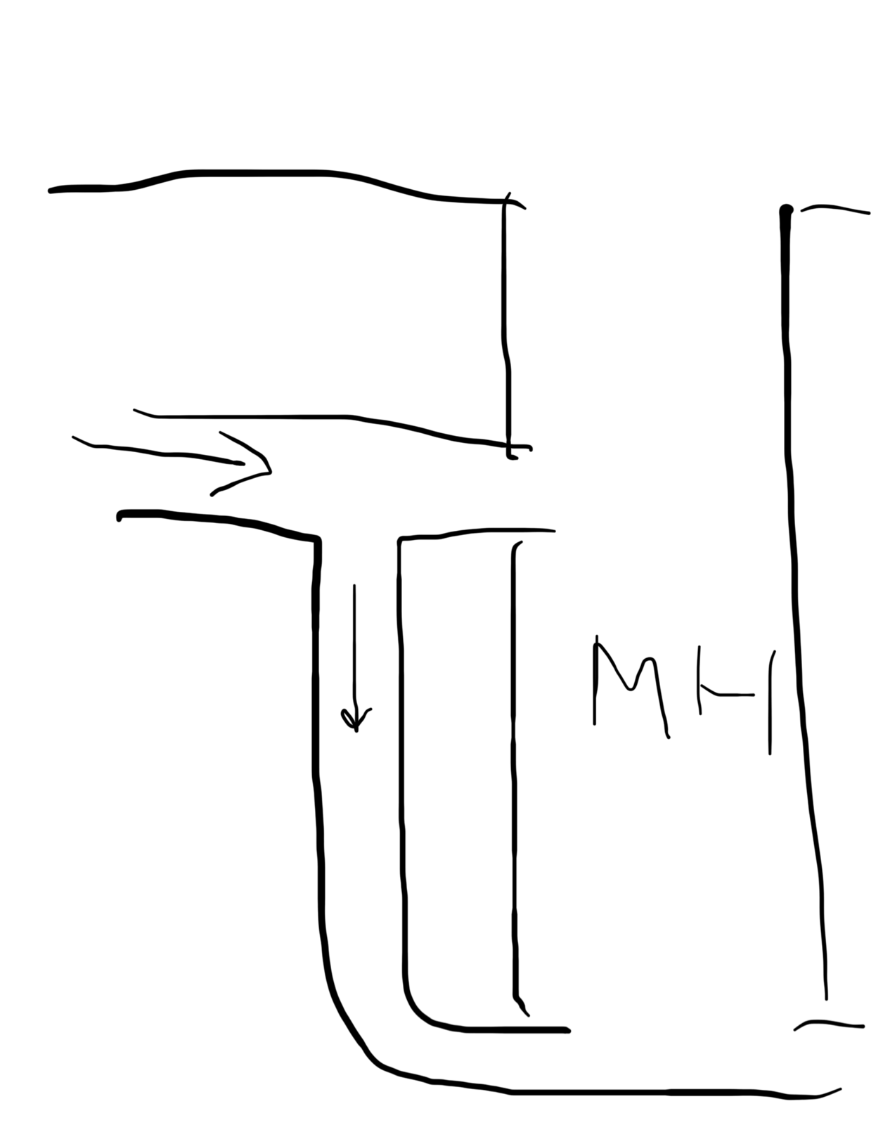

How about staying inside instead, here's a crude diagram from the under stairs proposed toilet to the existing stack inside a wooden box going down the inside of the kitchen wall. Would it be easier to dig inside total length is only around 3 meters, not sure what floor is but assume concrete so same as outside and then connect into the stack around a foot or so down from floor levels so long as the fall from the toilet to soil pipe is correct. Putting some cheap carpet and lino back on top when done isn't a problem and the building work is a friend so already giving a very good price for total outside work. This way no water companies involved and just a simple building reg sign off.
I was going to run water pipework through floorboards from upstairs bathroom and drop down but could take from kitchen instead saving any upstairs under floor work while the floor is up downstairs.
If its a block and beam suspended concrete floor you wouldn't be able to just cut a trench accross - but then there might be a void beneath.
Youll have to investigate how the floor is constructed.
If the floor is all good, builder seems to think it screeded then concrete and underneath that just hardcore. Can anyone see any glaring issues with my rather crude drawing - builder knows exactly what type of connections etc are needed.
Are you sure your foul drain isn’t on a back drop shaft to get to the 3.5mtr depth? If it is you could connect in at the higher level somewhere.
Not sure how I could tell, there isn't any inspection chambers before the manhole.

Looks like the internal connection is a good suggestion but I would be concerned you aren’t necessarily going to know what the floor construction is until you have committed to the works.
