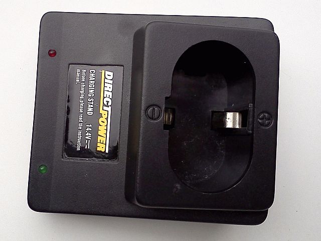

Having searched the Forum and found 177 threads mentioning similar subjects I'm apprehensive to start yet another thread, but here goes!
My Dad's cordless drill (one of the "cheapo" ones) has lost its charger adaptor (the bit the battery stands in to be recharged) so the drill is useless at the moment. We have the original "wall wart" which has a 16v output (14.4v battery) so I was thinking to just connect it straight to the battery terminals with croc clips.
As far as I know the current will reduce as the batteries approach 16v, therefore there should be no need for current limiting.
Does anyone know what's inside those adaptors - the original had two LEDS - red for charging, green for charged. I imagine they all have a similar circuit to each other...

GOOD NEWS!!
Found the little b*****!! It was somewhere it shouldn't have been, and I'd passed it about 10 times every day without noticing!!

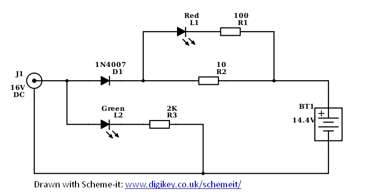

I'll publish the circuit in case anyone wants it - watch this space!
Thanks once again for all your help ;)

Here we go:
Green LED is on all the time, not quite sure what red LED is for...
R2 is 5 watt, others 1/4 watt.
