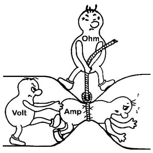

Low volts high volts big amps little amps
Hello All
I am trying to understand this so could a kind someone show me a diagram, a simple circuit where I could use say a 1.5 and a 9 volt battery to explain the principle of high and low voltage against big and little amps. I have a set of 1.5v batteries, showing full voltage but little or no current is passing. Not to tecky please, I have a multimeter, some leds, resistors and a few other bits and pieces.
Regards

I have to admit it is still a little bit of magic as far as I am concerned on how with a tuned circuit the amps can be so high, I remember doing the Q in a tuned circuit, but can't say I fully understood it. AC does not work like DC, however lucky in this case looking at DC.
In the main with a calculation we have an idea of the answer, which is just as well, I was always getting the decimal point wrong when using a slide rule.
The guy does however have some electronic components which seem at first glance not to follow what we expect. So look at 3 red LED's and a resistor connecting them to 12 volt battery, and compare with 3 green LED's and a resistor also to a 12 volt battery, I am going to assume the battery is actually 12 volt, although in real world this is unlikely to be the case. So in the red LED circuit with have a 340Ω resistor and just under 20 mA flows, but with the green we have a 280Ω resistor and still just under 20 mA flows.
Ohms law seems at first glance not to be working, this is because the LED is a current dependent device, typical voltage on red is 1.85 volt and green is 2.2 volt they don't have a fixed resistance this is dependent on the voltage.
