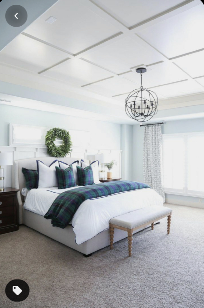

That's pretty much what I did, nice flat ceilings, loft storage and room for insulation:
