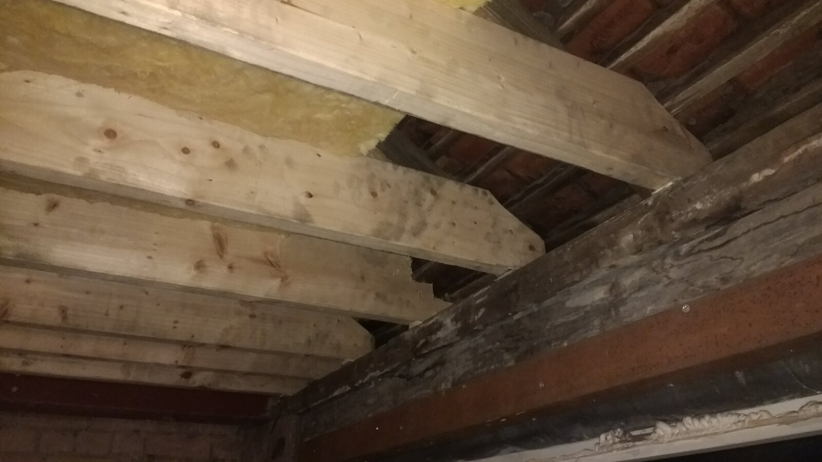

That's pretty much what I did, nice flat ceilings, loft storage and room for insulation:
I do wonder if those terracotta walls have any structural strength? I had one between this bedroom and the bathroom next door, it literally fell apart when I stripped the plaster off it so I replaced it with a stud wall, I think because they are so light they don't "settle" over the years like a heavy old brick wall when the joists deflect, they just crack. I also never understood why they built the walls off the floorboards between joists but it's to spread the load between adjacent joists.

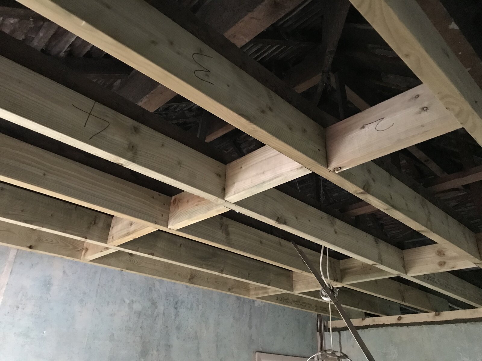

How did you connect the new joists to the house at the window side of the room?
When I did it at my house I went from load bearing wall in the middle to an RSJ just in from the windows. At our daughters I could go onto the wall plate direct and that would lower the ceilings by 16cm to 243cm.

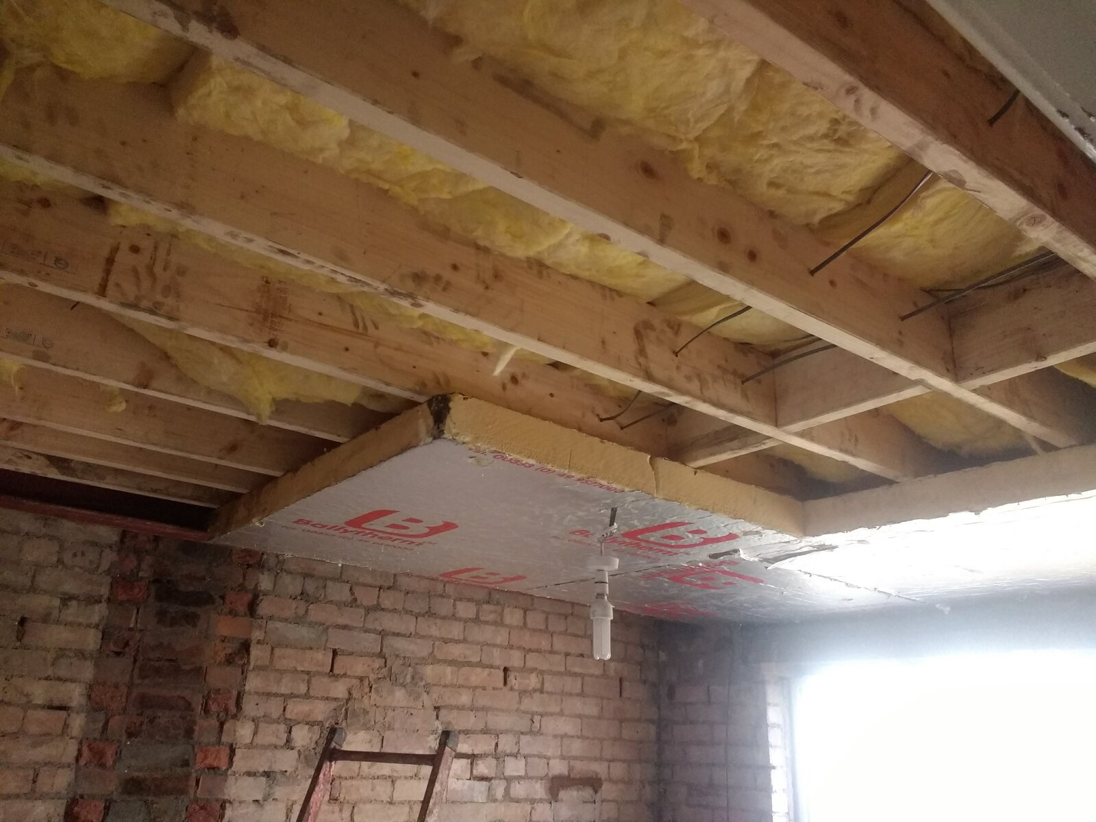

I just chamfered the ends and sat them on the wall plate, I removed the old joists completely (obviously remembering to connect the new ones to the rafters and the joists at the other side of the house) as they were just in the way of the insulation. If you need the joists lower you could use joist hangers or notch a bit out of the bottoms - it's only sheer stress at the ends.
I've just checked and with the insulation and plasterboard under, my ceiling is only 235, less than I thought, but looks perfectly acceptable and in no way feels "low".
