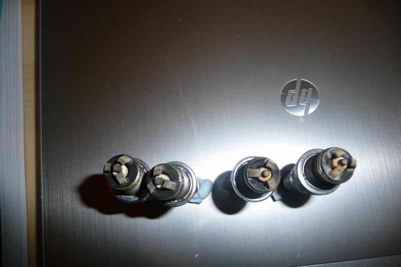

Today I changed the spark plugs again to Bosch Super 4. The old ones as per the attached pictures look really odd as cyclinder 1 & 2 have the same colour looking at the pics left to right BUT cyclinder 3 & 4 have a diffferent colour! Cycinders 3 & 4 always show a misfire whilst 1 & 2 no mis-fire at all.
Can anyone tell me why the spark plugs look so different? Is there a fue injector problem?

I don't think there's a massive problem with those plugs - the triple electrode ones last for ages and there isn't any sign of oiling, which gives a general state of the cylinders and compression.
